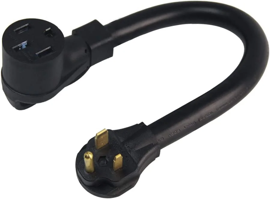

fixed for $36 - this adapter converts a 6-50 plug to 14-50 female - it's a must have for most EV owners - one for the vacation home and one "in the car" means you can use either a 14-50 or 6-50 when traveling.
NOTE: this adapter will work fine for most ANY/ALL EVSE _EXCEPT_ the juice box being sold/referenced here - Juice box charges require a 120V power source to run the computer/wifi aspect of the charger - so it requires a NEMA 14-50 outlet properly wired with 2 120V hots + neutrual + ground - NEMA 6-50 only provides 2 120V hots + ground - lacking a neutral to run 120V loads…
MOST (all but Juicebox) run flawlessly on either 14-50 or 6-50 - this is because on MOST EVSE's the neutral is a dummy-connector just for plug compatilbity, but the 4th electrical neutral wire/connector is un-used…

as per Tesla/Rivian/Lucid/Porsche if you're swapping plug types (6-50 for 14-50) outlet make sure to get an industrical/commerical grade NEMA outlet like the hubble
https://smile.amazon.com/Straight-R...mzn1.fos.08f69ac3-fd3d-4b88-bca2-8997e41410bb
converting your 6-50 plug to a 14-50 maybe move expensive than you realize if the electrician has to repull wire
a 6-50 plug only has 3 wires - 2 hots + ground
a 14-50 plug has 4 wires - 2 hots + neutral + ground
the 6-50 outlet may only have 3 wires behind it and it could be expensive to "repull" the wire or pull the missing 4th wire
also the Juicebox is one of the RARE EVSE's that requires the neutral since it uses 120V to run the onboard charging electronics/computer

all the above chargers will work flawlessly with a NEMA 6-50 outlet with a simple $35 14-50 adapter…
I'd shy away from the JuiceBox for this particluar setup given the problems that it requires use of the 120V (Hot+Neutral) aspect of a properly wired NEMA 14-50 outlet - unless there is an existing unused 4th wire in your 6-50 outlet it could be a much more involved process to get a 6-50 plug converted to a 14-50 because of the missing neutral wire…of course you can always a swap a 6-50 for 14-50 outlet and not wire up the neutral - but then it would only work for EVSE and would not pass a building code inspection (but is functionally fine for most EVSE's except the juice box).
