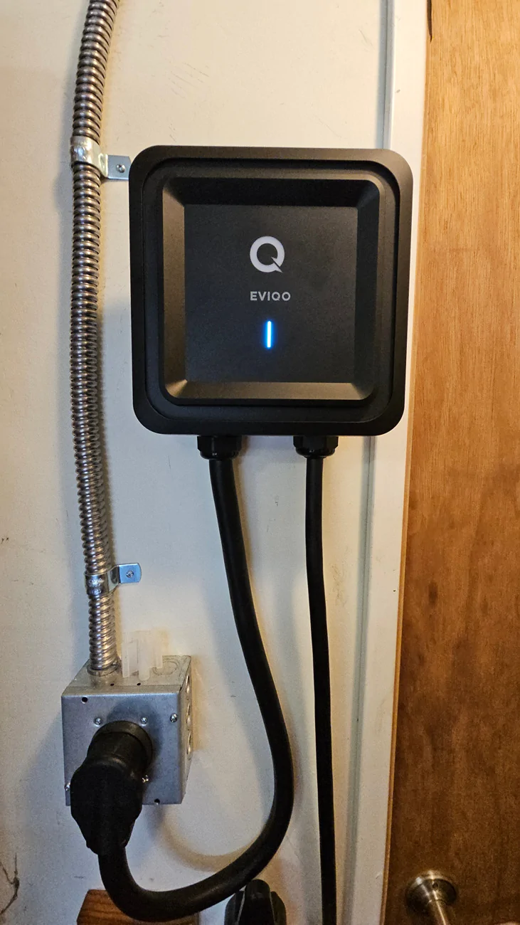

I just got myself the EVIQO gen 2 (which is now on discount on amazon for about $420). It seems quite nice and it was easy to install. I used to use the J+ booster which is excellent but continuously charging two EV's from a mobile charger like that is a bit much so I just upgraded to the EVIQO -- the cable on this one is also 25ft but it uses slightly thicker gauge (2x 9awg instead of 10awg for the J+ booster). It was easy to install and seems quite robust ... fingers crossed :)
