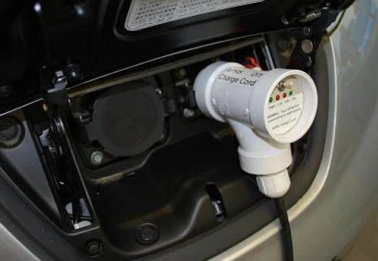

Fun fact, HV batteries in a Taycan source DC voltage and are not grounded (to Earth), therefore you would need to touch two terminals in order to get shocked, or rather, electrocuted (yes 800V, or 400V, DC can be very lethal). Also, while cars usually utilize the car's body for the negative terminal of 12V battery supply (saves 50% of wiring by using the car's body as the conductor), the high voltage battery does not do that - both terminals are fully isolated from the body. If by some chance there was to be a short between one of the terminals and the body of the car, the current would still not flow (no return path to the other terminal, unless for some reason there was one through the 12V negative), and if both terminals shorted to the body, the body would start heating up real quick, possibly melting.
The only way I could see someone getting shocked due to a technology failure of any kind would be if the car was plugged into AC charging and something went really wrong at more than one level. AC charging, as the name suggests, runs on AC source which is grounded to earth, so if there was a short of any kind to the body of the car, you could get electrocuted by just standing on the ground and touching it. HOWEVER, for this to happen the AC EVSE (external charger) would have to be faulty and/or the car's charger would have to have some major issues. Normally the EVSE provides the ground/Earth connection and the car is supposed to tie its body to that, then the EVSE is supposed to monitor the current and if any of it doesn't return through the live phases, it is supposed to trip instantly (think GFCI functionality).
Bottom line, unless you were using something like this to charge the car (PLEASE DON"T)
Porsche Taycan electric shock??!!! 1653462108622

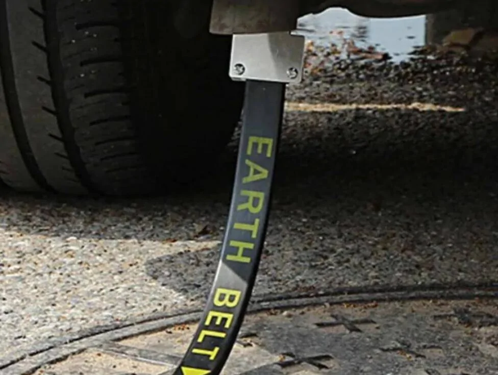

what is described here is almost certainly a simple static electricity buildup which happens to all cars, ICE cars too (sometimes a cause of fires when fueling up when a spark arcs between the fuel dispenser and the car). If this is a common problem for you, there are products out there which literally ground the car (dissipate any static discharge buildup on the car).
Porsche Taycan electric shock??!!! 1653462521931
