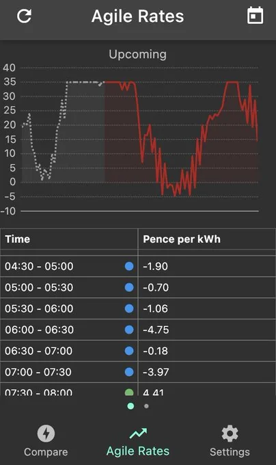

Electricity prices are negative tonight. Good time to charge the car to the max.
As luck would have it I just did 160 miles so the battery is only 3rd full :)

Wow - where do you live? Is this a common occurrence?

I'd imagine it is a UK New Years Eve Phenomena .. These are wholesale rates (rates energy companies buy at) .. there are a few UK tariffs that allow users to "gamble" on using these hourly rates and historically they could save, however with rates these days being high pretty much all the time any one playing wholesale rates will be paying a lot..
I imagine this -ve price is the generating companies have planned to spin everything up for New Years eve (probably including a few old power stations that they generally dont use - maybe even the coal fired ones they are in process of decomissioning) and will have to keep generating until we all get too drunk / partied out and just turn off and go to bed on masse but they cant spin down the generation that quick (takes a few hours to turn off a power station) so need to dump it between 3am and 7 am
In the UK.
It is caused by there being plenty of wind. It generally happens because there is ramp up time to get gas turbines on supply ready for the start of the day. It is better for them to sell a small amount of electricity at a loss overnight ready for selling a lot at a profit.
It can also happen on windy and sunny days. I think it must happen 10-20 times year or so.
You can see the UK's production mix here https://www.gridwatch.templar.co.uk/ Currently only 25% of electricity is coming from burning fossil fuels.

I think the only way to win long term with the agile rate is to either not use electricity from 5-7pm or have a system like a Tesla powerwall where you can use stored electricity during the peak rates. Happy charging overnight though!
Exactly - we have underfloor heating which can switched off for a good few hours before we notice it. I have the controller pause the heating between expensive hours without any perceptible change in temp
