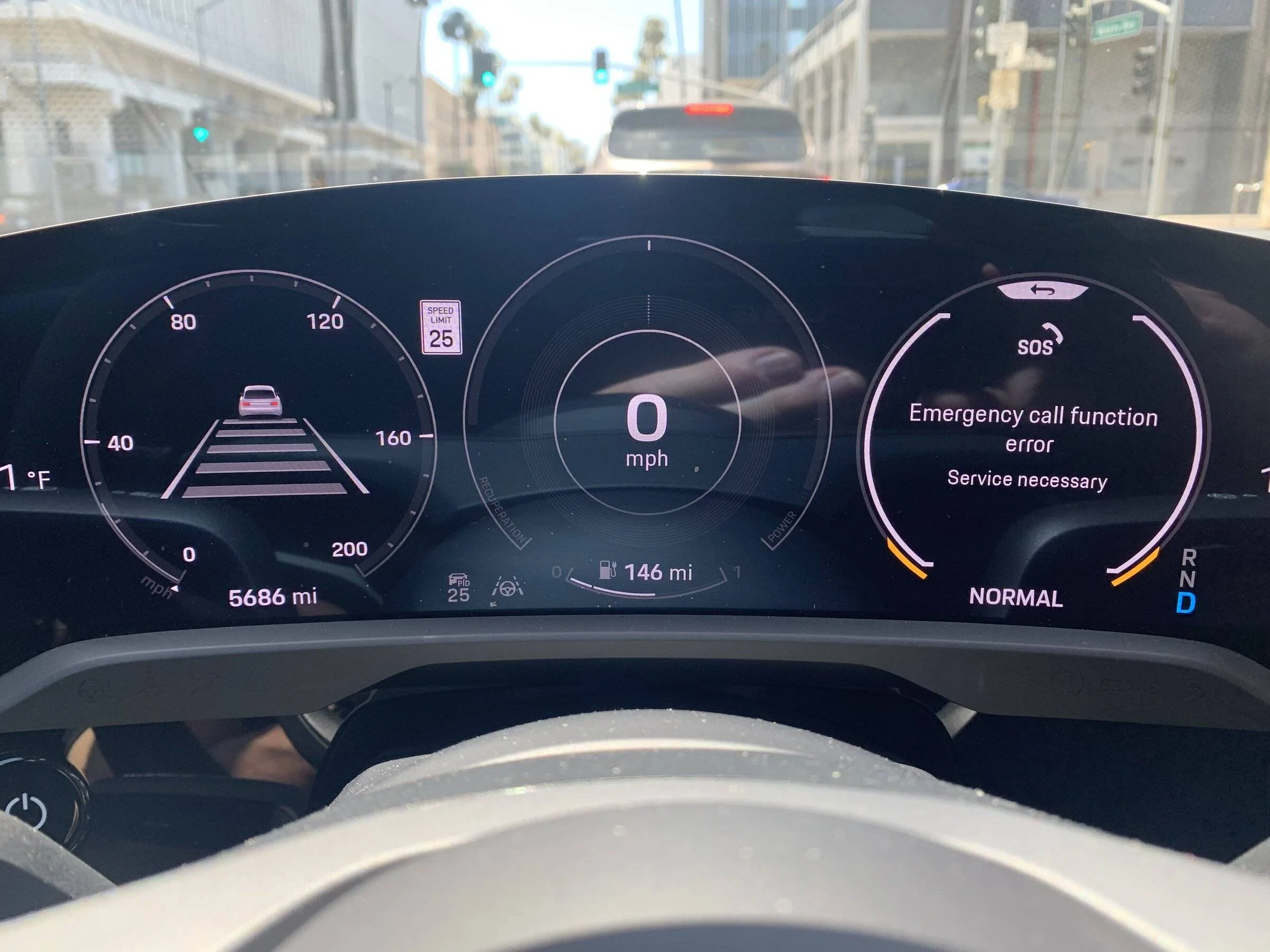

Yesterday after a OTA update , i think was labeled titles , the error message Emergency call function error, service necessary continues to appear. I cannot clear it. Anyone else with this issue?

I had that 2 weeks ago. I took it into the Porsche dealer and they fixed it in 40 mins. It doesn't stop you driving but you do need to get it fixed.

I'm getting this "SOS" error at least once in a week...since the beginning (September 2021, MY21).
It goes away after the car is locked/parked for about one hour (sometimes even before).
