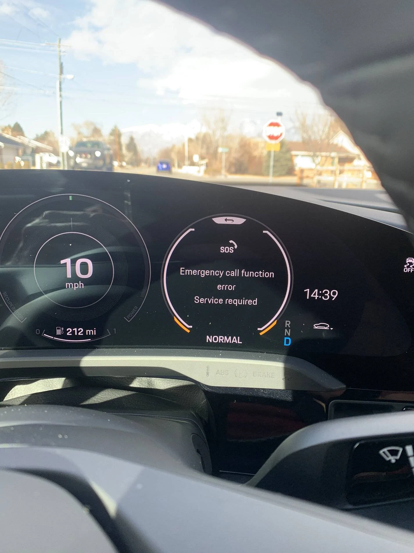

@KensingtonPark
Had this as my first error message ever a few days ago after 3 months of ownership. Hope this is not the beginning of other issues mentioned on the forum. It has not repeated since the other day.
Keep us updated on your findings.
Thank you in advance.

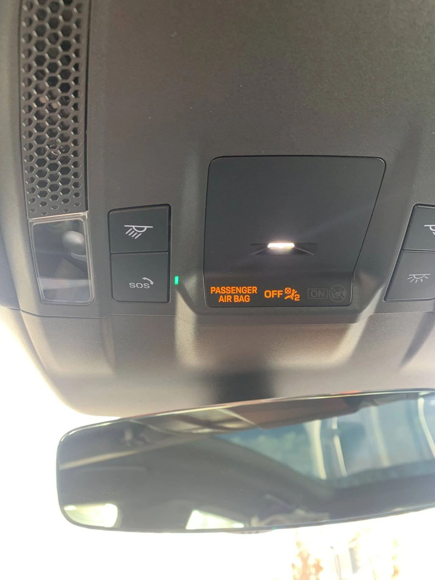

Update:
The Porsche dealer has not been able to get the OTA module to provision. Apparently, the Emergency SOS relies on the OTA module, so the fix is to replace it. Car has been in the shop for three days now, and I won't see it until next week.
Unlike some of the people who reported this error:
  1. My error message was consistent. I received the error at every startup. Some of the people reported only seeing the message occasionally. That could mean that their OTA module is beginning to fail but has not totally failed like mine, or it could mean nothing.
  2. The light next to my SOS button was red. This is unlike the picture shown by @REIL, above, which was green.

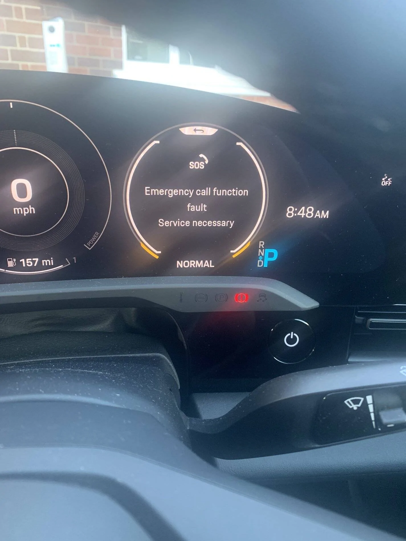

Interestingly I too received this exact error a couple of days ago.
The red light is on next to the call button, the error shows every time I turn on the car and I cannot use the voice commands or phone. It appears there is no sound recognition or sound output when the phone is connected on a call.

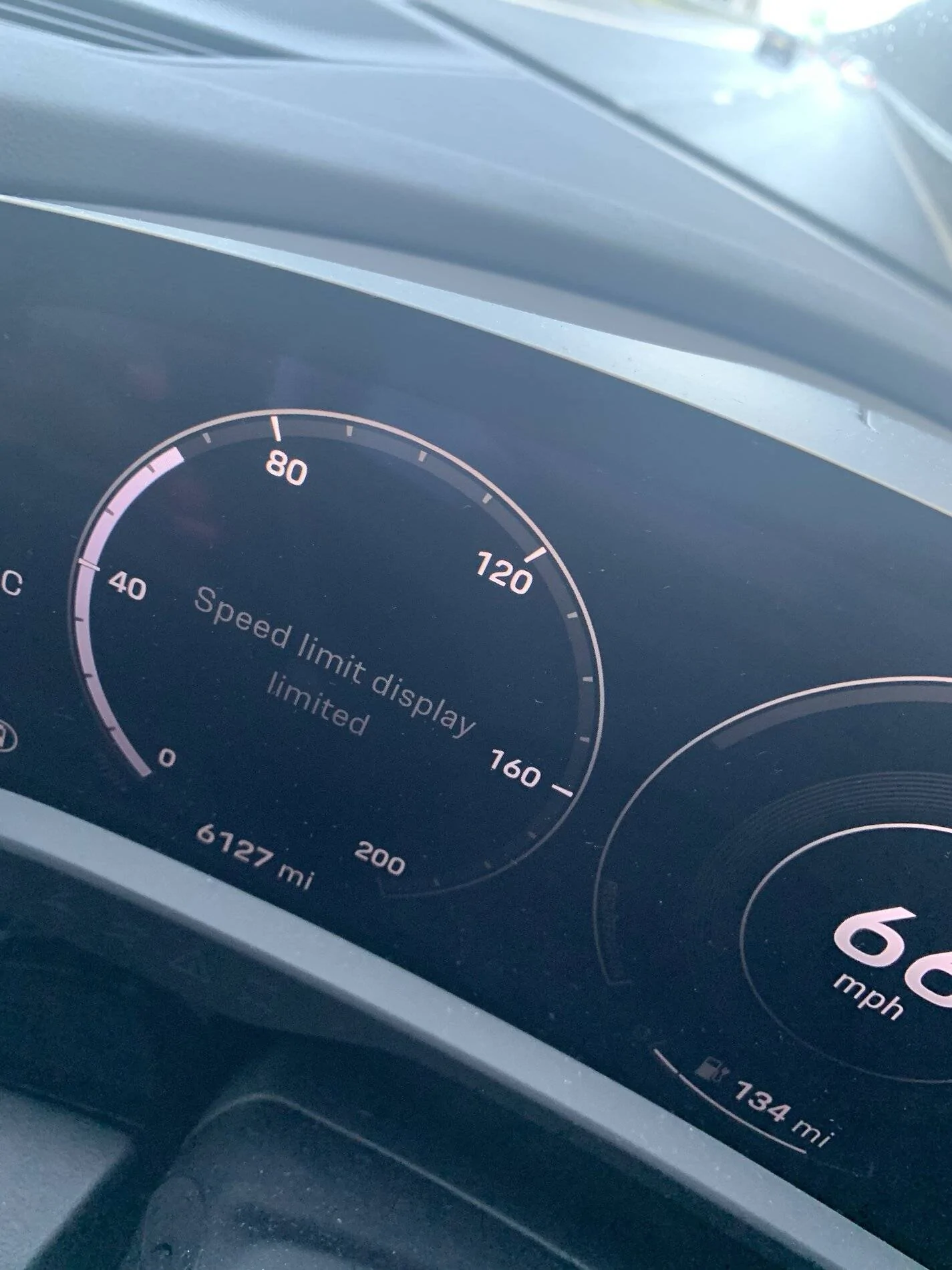

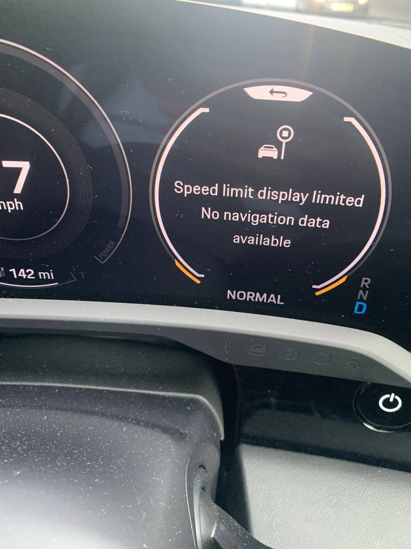

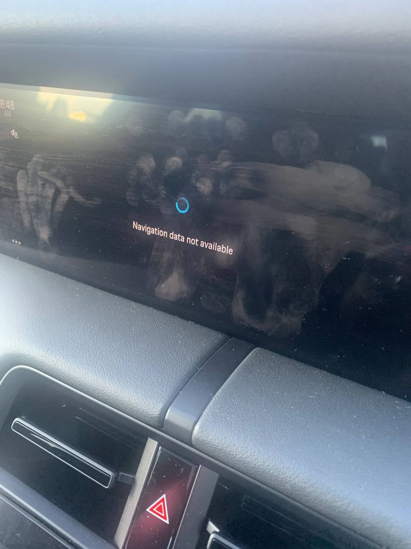

I spoke too soon! The SOS emergency call function error message has reappeared and again can’t use my phone! It’s booked in to go back to the dealership this week to investigate! This is the 5th time! Anyone had any luck getting to the bottom of this problem?
I’ve also had a message saying “speed limit display limited” and my navigation isn’t working. See photos.
