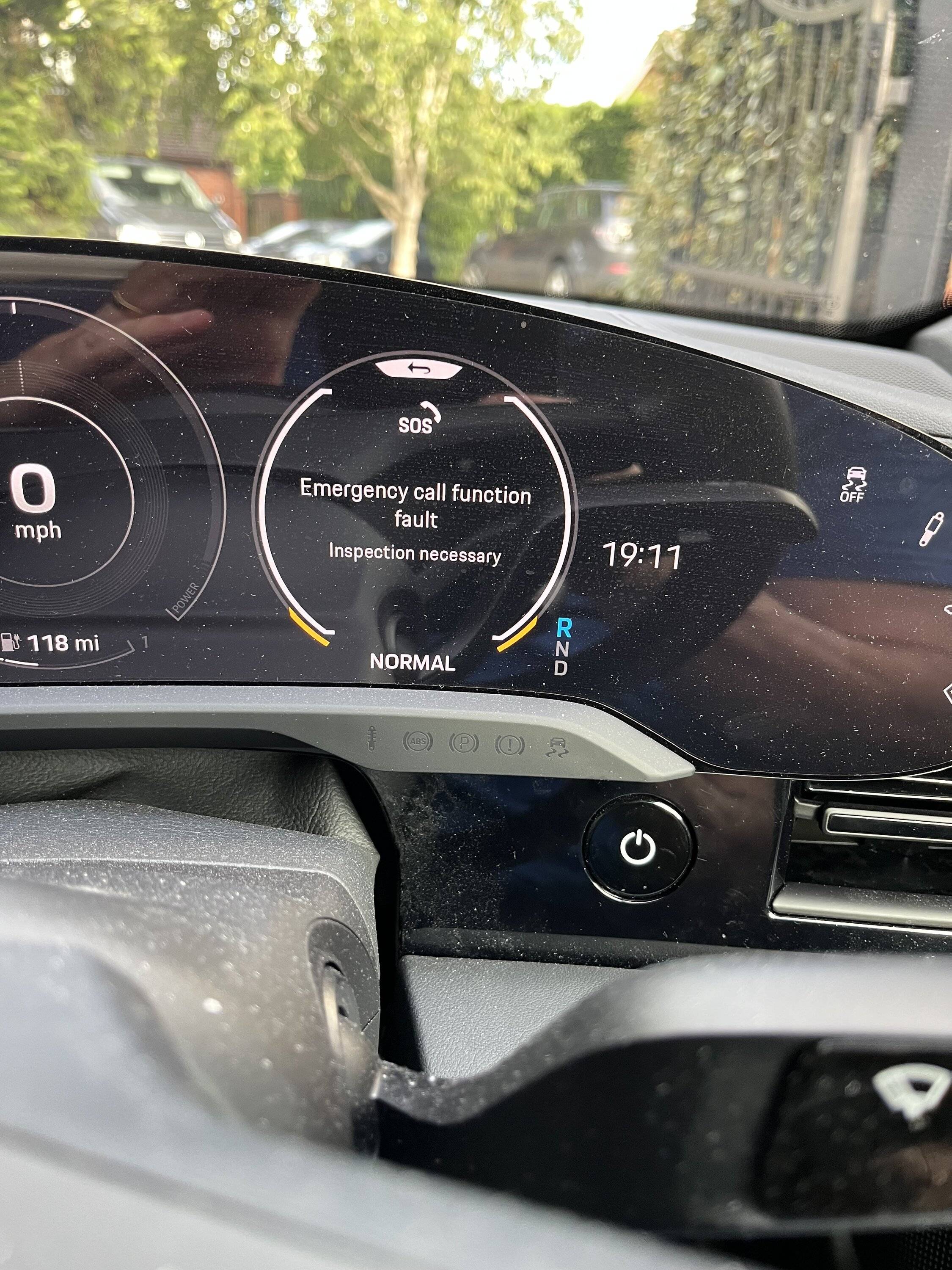

Got a message today on starting the car:
"Emergency call function fault. Inspection necessary"
Came on this morning. Got where I was going then parked all day. Came on again this evening. No obvious lack of car functionality including connects to app and allows me to send navigation locations to the car.
I have found this: https://static.nhtsa.gov/odi/tsbs/2020/MC-10174597-0001.pdf which suggests that I need to take it in to get an error code reset.
Has anyone found any solution to it other than return to dealer?
Thanks.

Update… this morning it was back to the green light and no error message. It seems to have sorted itself. Not sure if it is relevant but it was on charge yesterday evening and plugged in over night

I’m getting this error several times a week.
it’s “self-heated” error… after the car is parked about 20-60 minutes.

Just got it myself. Had it last month and it cleared before I got to the dealer a few days later (sods law)
hopefully will clear it self again or I will have to get it looked at when they do pcm update

I have this error message - states service required ? will see if it resets - last time I had data issues car needed a new con box aaaurgh!
