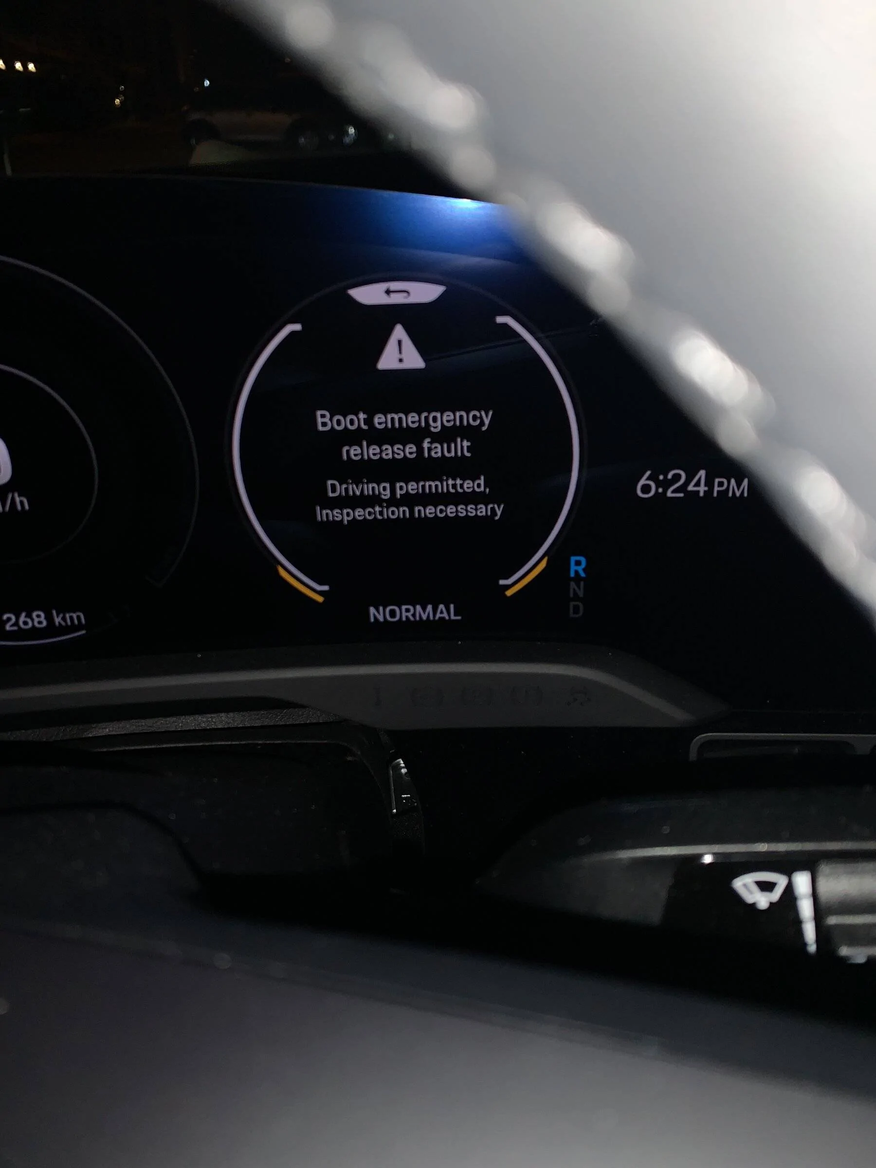

Hi every one,
This is my third week since I got my new Taycan 2022. I got this message (( Boot Emergency Release Fault )), its under warrant, but anyone got the same issue?

It is probably a false positive - not seen that error before. Lock the car an leave for 10 mins then try again as the error & message could have cleared.

Thanks Winge for the reply. This happened the last two days. So, it was off and on many times….

I took it to the dealership, I believe tomorrow I will get it back. I will update the post with the findings ?

An update. Took the car from the dealer and its an only software reset and update.

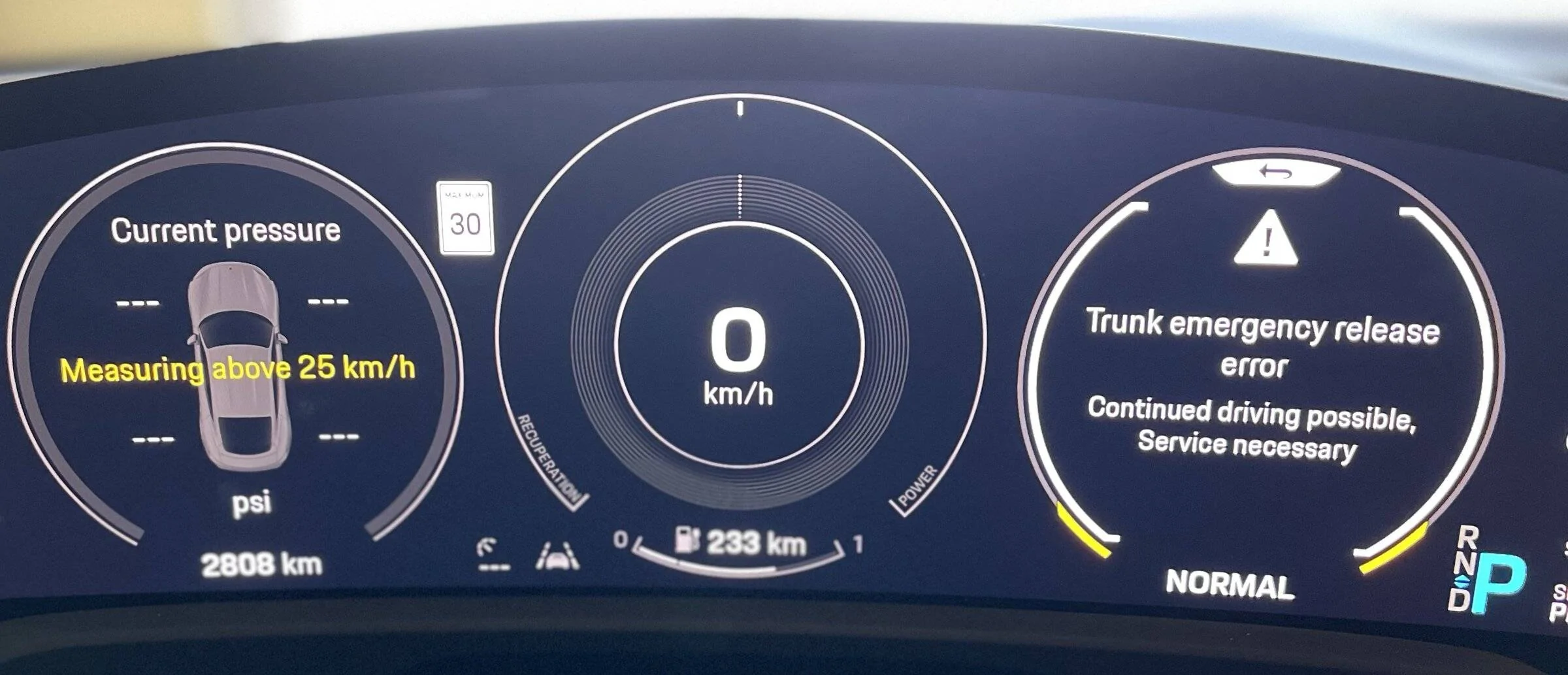

I have the same error. How do I software reset? I reset the PCM several times but it didn't work because it doesn't reset the driver display.

You can do a hard reboot of the PCM and that usually clears this sort of thing.....You press 2 fingers down on the upper right corner of the screen and after a few seconds the screen will go blank and then restart screen will appear. Choose the bottom line to just return to normal function.

As per my original post, I did the reboot three times and no dice unfortunately.

I doubt this relates to any PCM issue.
Try using your other key fob and secondary Porsche Connect ID to unlock and start the car to clear the error.
Are you certain this is not a genuine fault?

Let me try your suggestion tomorrow. But my trunk is working fine.

Trunk may be fine but the module controlling it may be reporting an error or it is a false positive.
The key trick may sound a bit random but has resolved a couple of quirks for several folk and forces the secondary id to be used (assuming you have set this up).

So I tried the alternate key to start the car, and the error still showed. I even folded down the rear seats and reached in to test the trunk emergency release, and it works fine. I'm totally stumped. Nobody else reports seeing this error.
