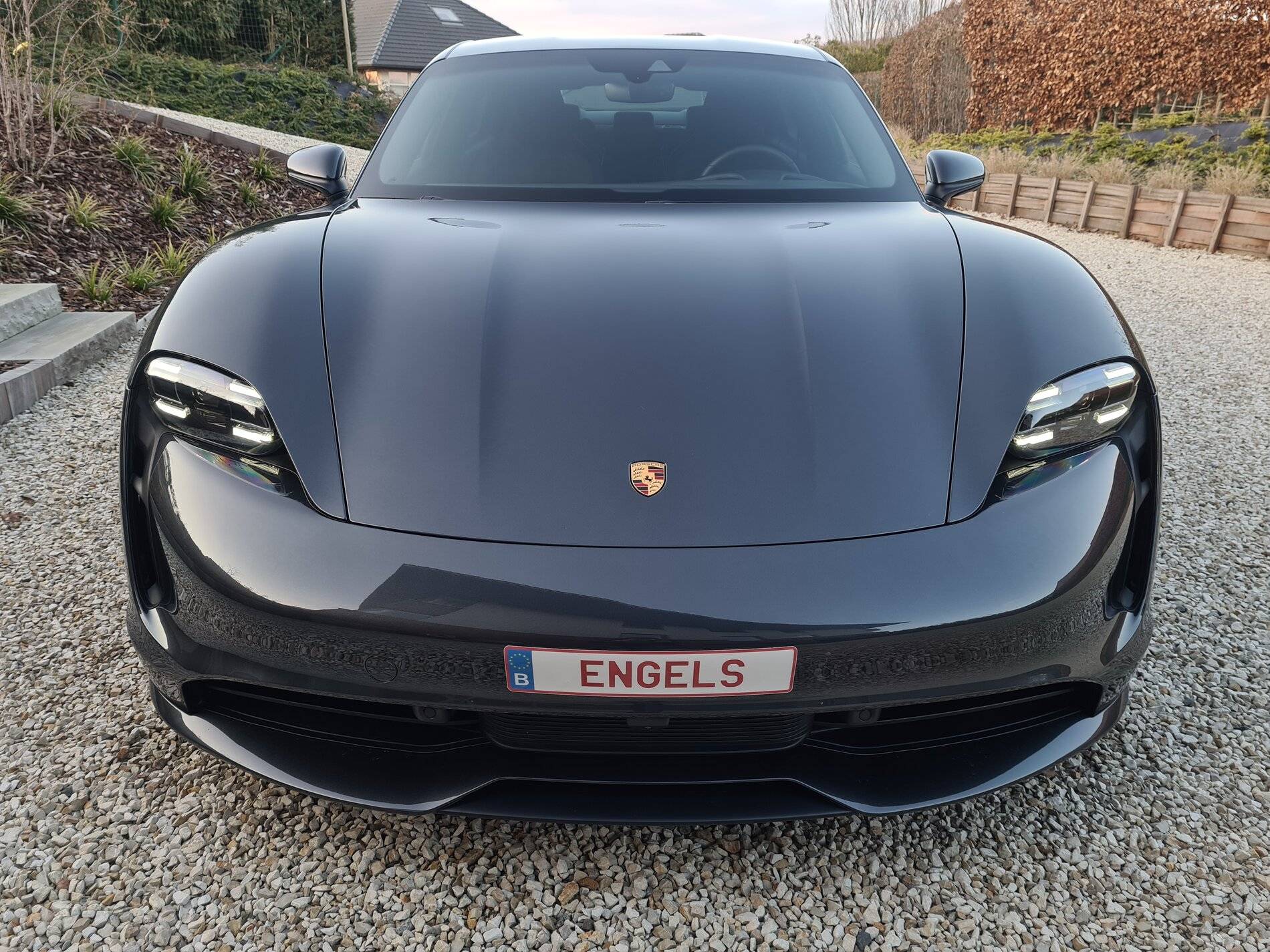

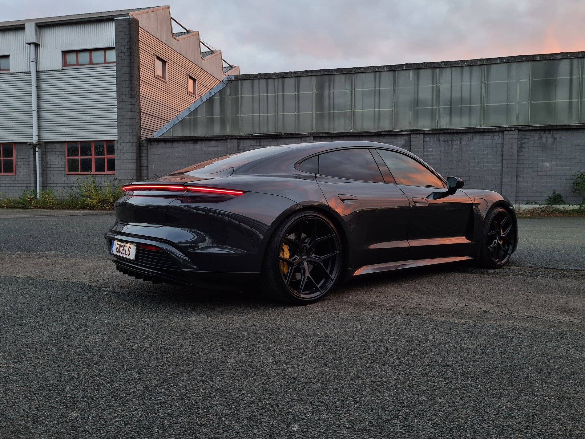

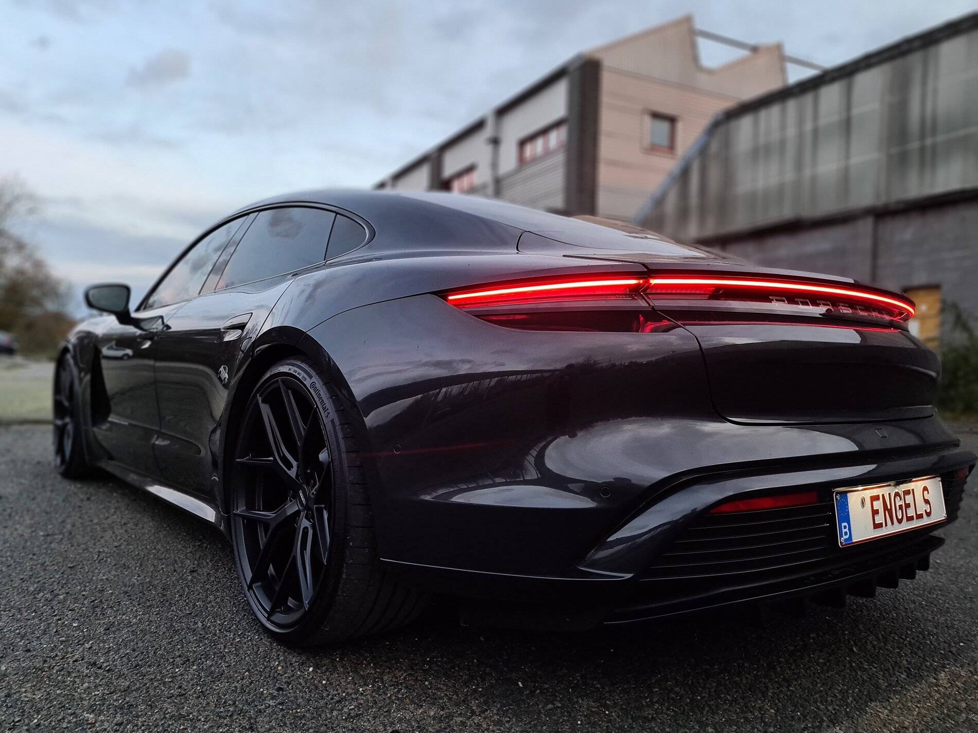

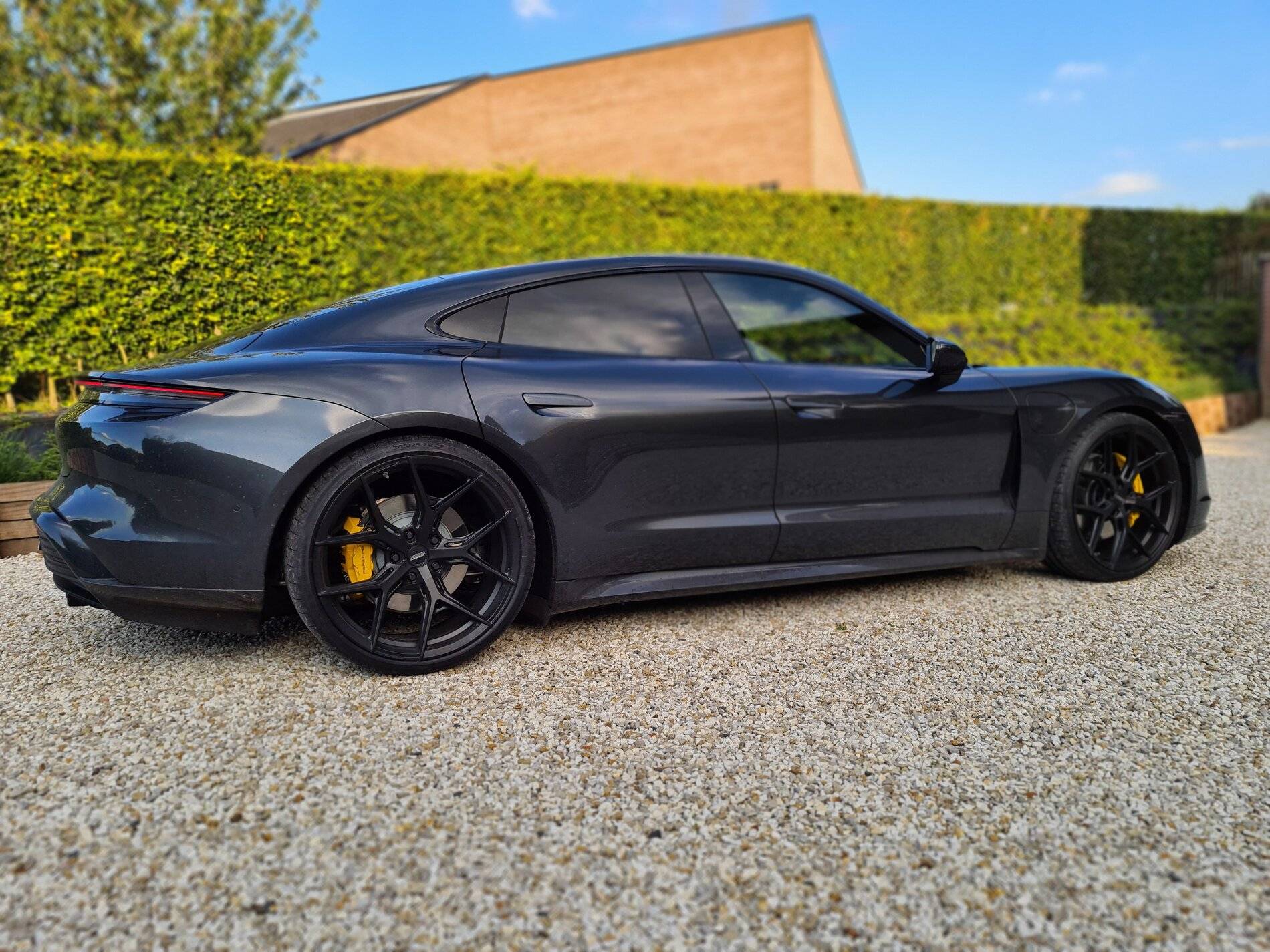

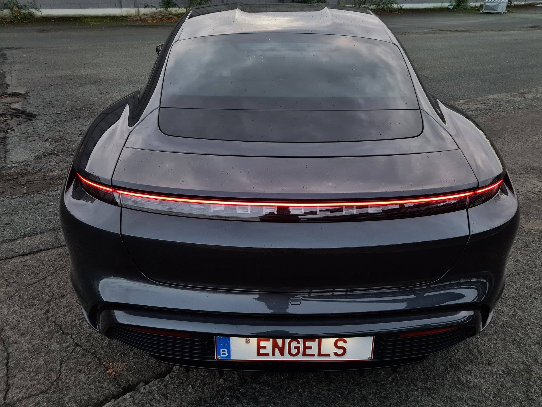

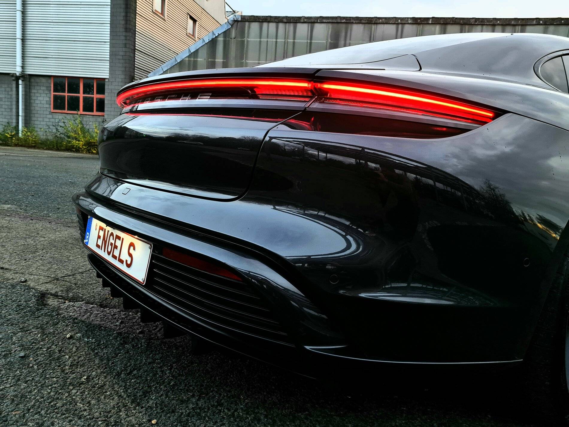

Looks awesome! Did you have the factory side skirts painted or did you have aftermarket skirts placed and painted? Very clean look!
I did the paintwork after a month from purshasing the car, all the black plastics are now in volcano, front, side and back. Looks morel the way as it should come from factory...

Great wheels. Can I ask you how much for the wheels and tires altogether? Are those the standard brakes or the first upgrade option?
I'm considering doing the same as you.

No difference between 21" and 22" only the 22" look much better! The Vossen wheels are great!!!
Ahhh this looks amazing! I have these same wheels on my SQ5 21's tho. I just preordered a 22 GTS and this color/wheel combo looks incredible!

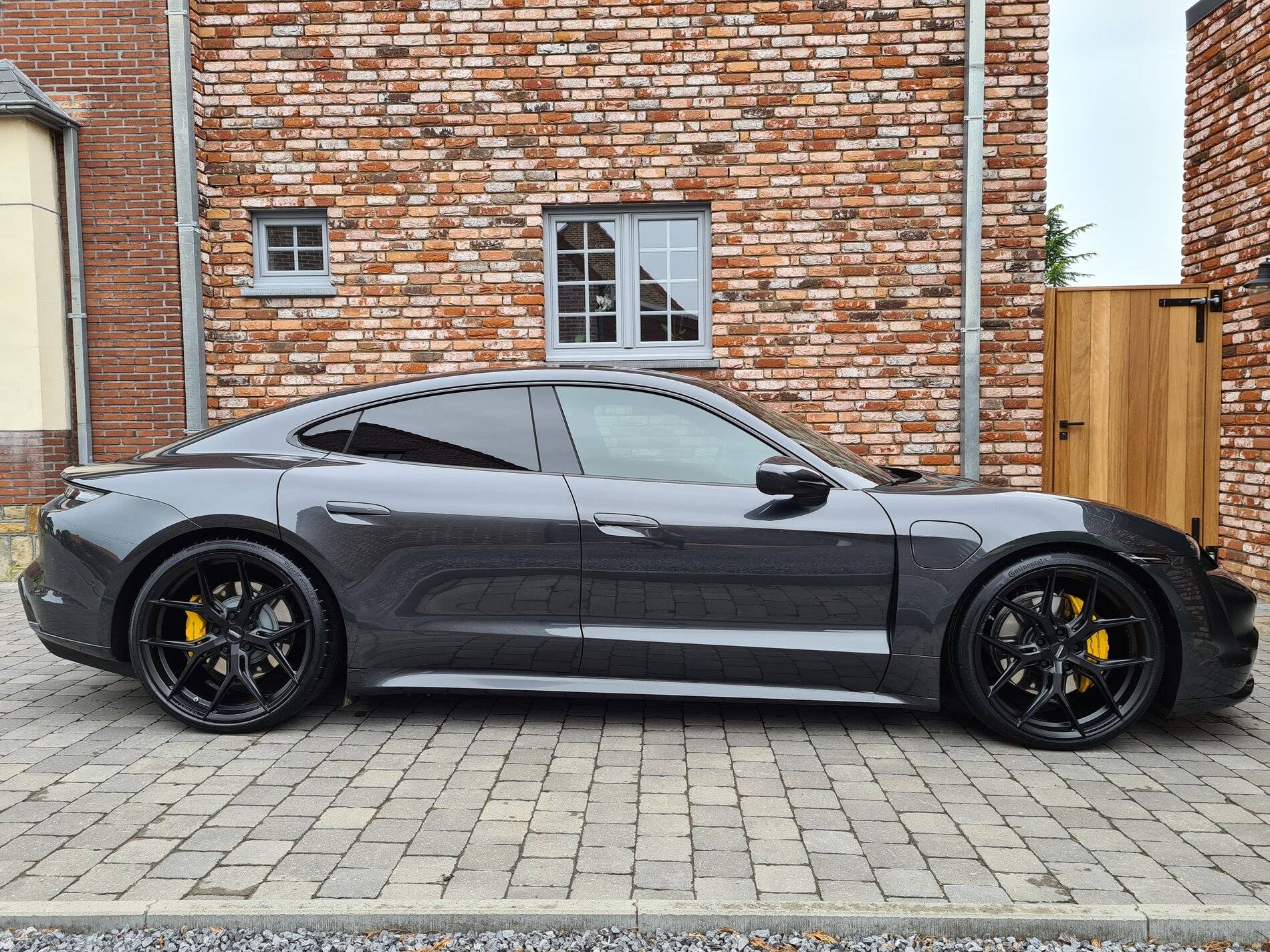

No ist stock hight. Friend of mine did installed some droplinks, lowered is by about 3cm. Looks good and sticks on the ground but bumps around @120km/h on the higway
The ride is bumpy above 120km? Is it due to the drop links? Is there a better drop link to go with? The car looks amazing but I’m not sure about going with 22s if the ride is bouncing badly above that speed. Love ur stance and rims. I’m looking at vossens too. I’m not interested in loosing the ride dynamics with the current mission e 21s. Anybody else lowered their Taycan? I would like to hear others opinions with lowering links and 22s

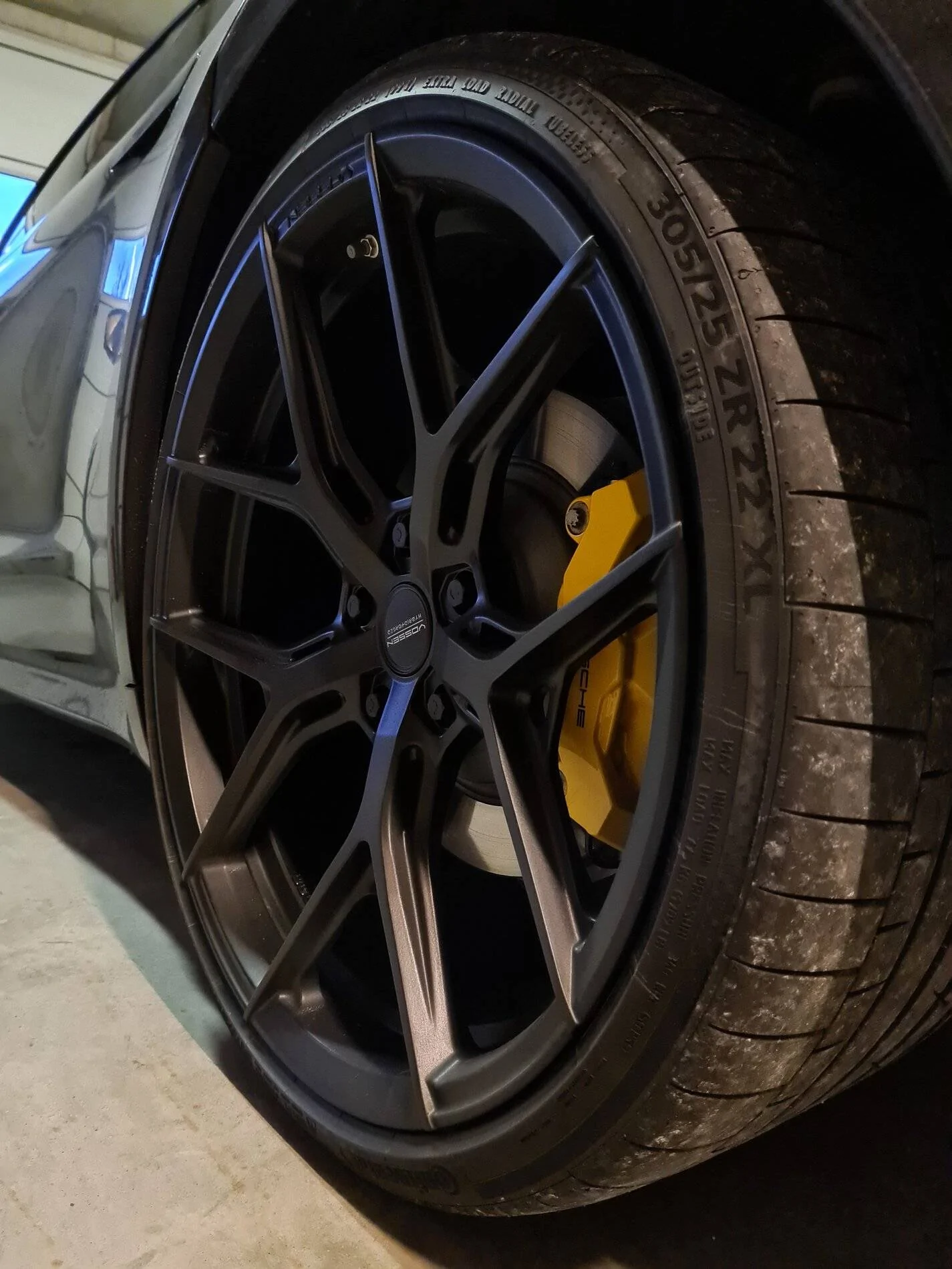

front:
265 * 30 - 22 offset 48 width 9.5"
rear
305 * 25 - 22 offset 54 width 11"
thats a REALLY mellow offset for the rear set up - only kicks them out 6mm from stock. Are they custom forged, or are the flow forged? Flow forged would make sense because they arent as flexible with offset. Also, I'm surprised with the 11" width and going narrower than stock.
Are you sure your rear is 11"? 11.5" would make sense and kick it out 12mm with your offset; still not as aggressive as what can be done, but would sound more correct.
I would have thought that they should be:
9.5J x 22 ET 44
11.5J x 22 ET 50
tires:
front: 265/30 22
rear: 315/25 22

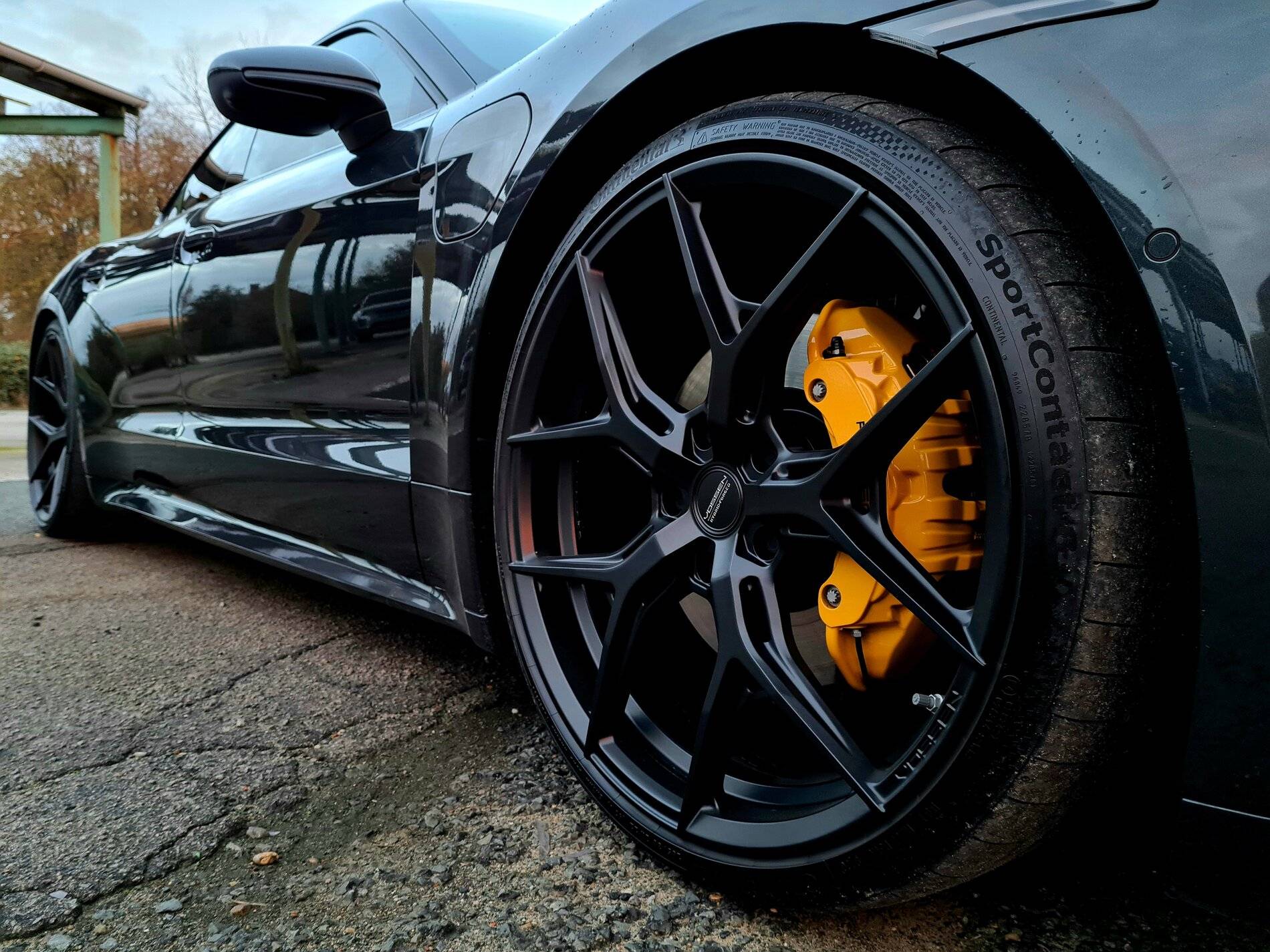

the set is around 6K (EUR)
Std brakes with a additionnel paint :cool:

It's a hybrid forged from Vossen, in forged you have more possibilities i agree.
i've seen a Taycan with on the rear some 315 tyres, it seems to be possible!
mines are:
6,5J x 22 ET45 265/30-22
11j x 22 ET 54 305/25-22

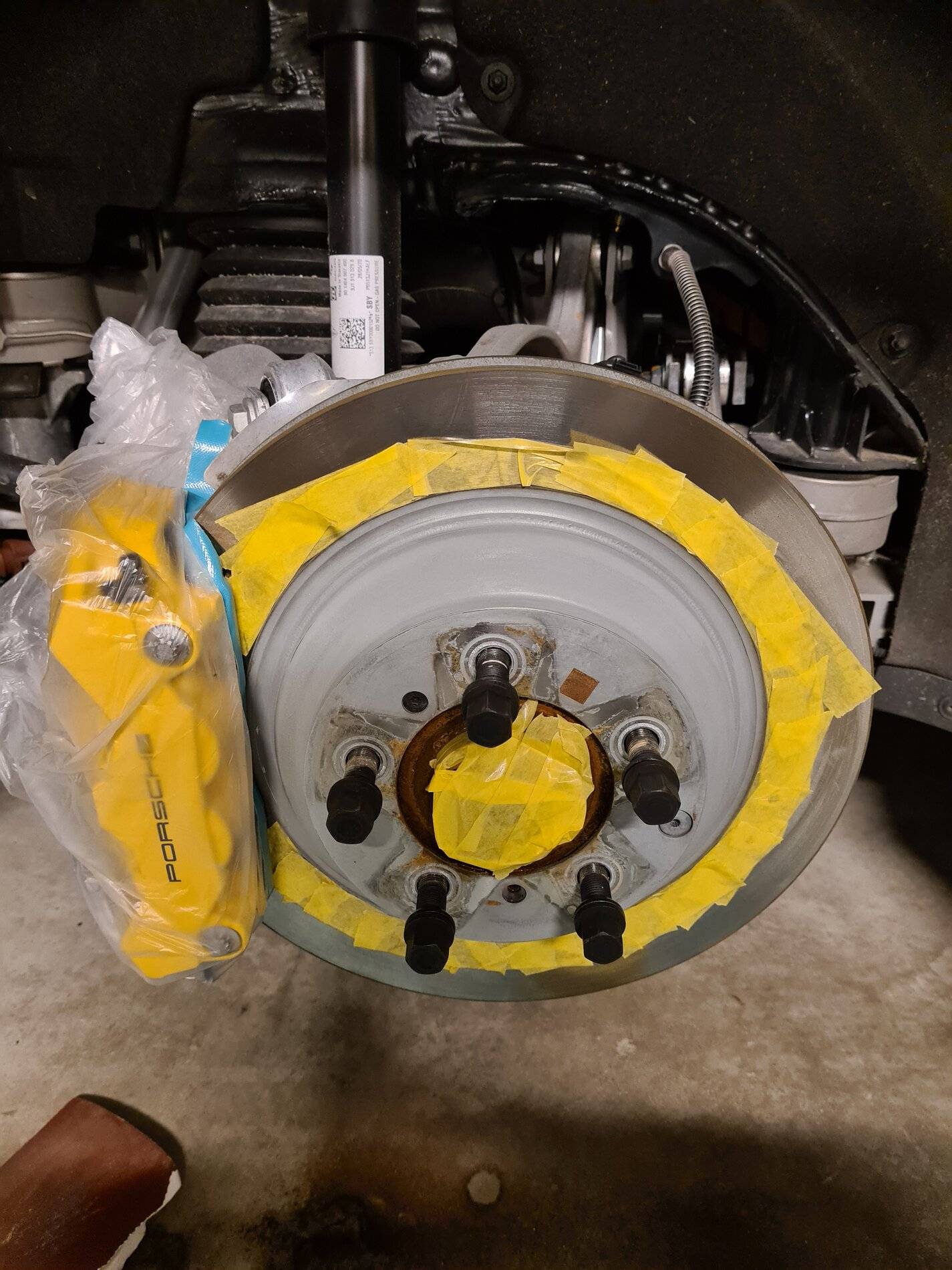

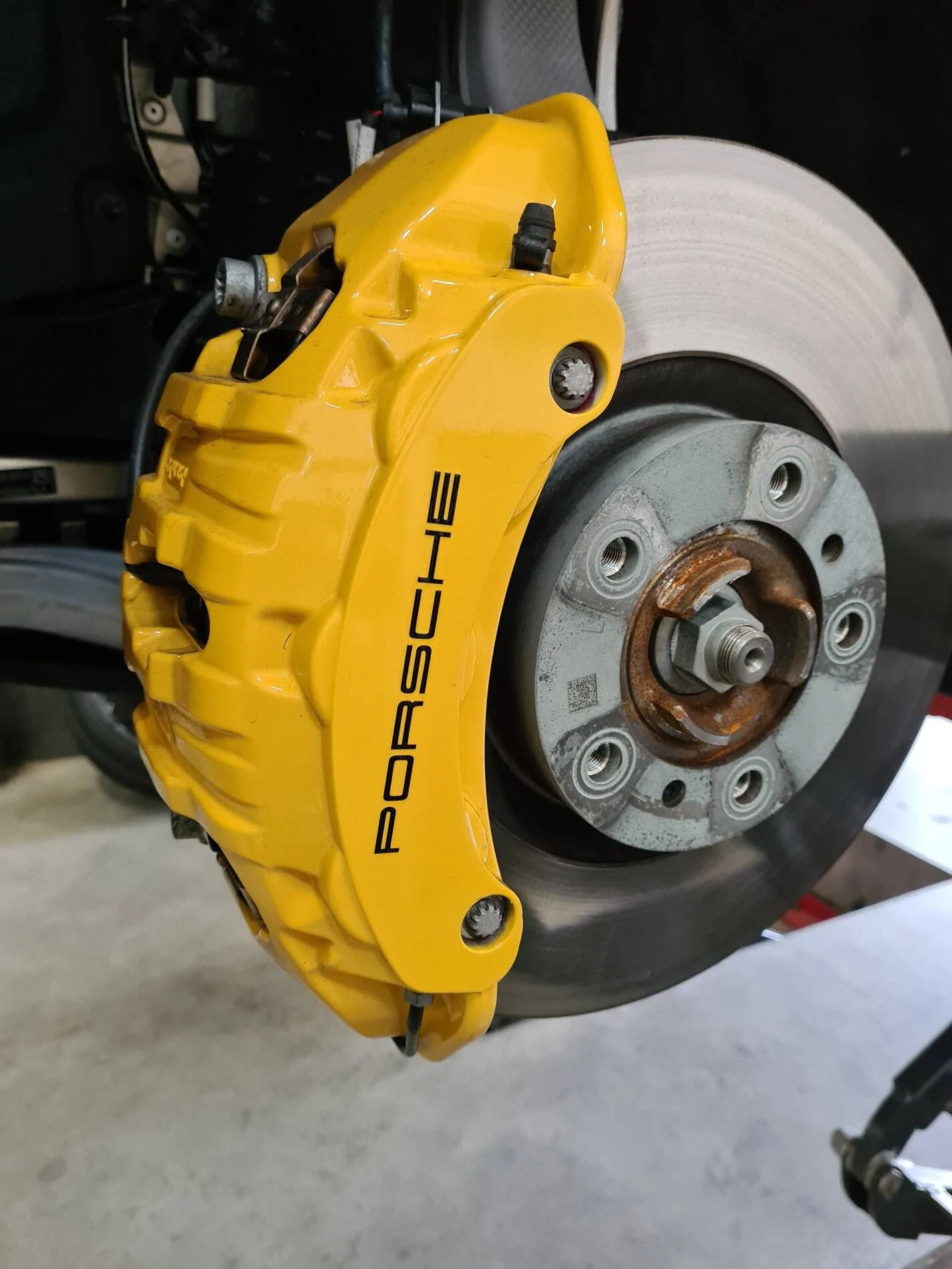

Yes, the red coulour didn't matched the car, in yellow they look more agressive, done by a pro!

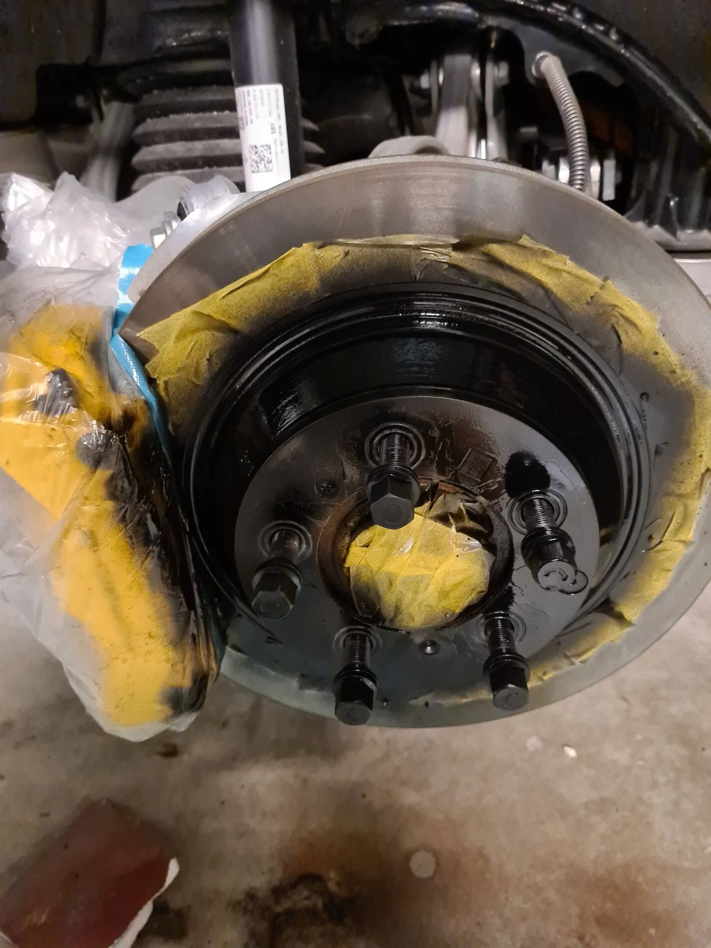

I'm doing some tests to paint the grey axle in mat black, i'll post some pictures when done
Hi Kris, by which company did you let your calipers paint? Asking for a friend ?
