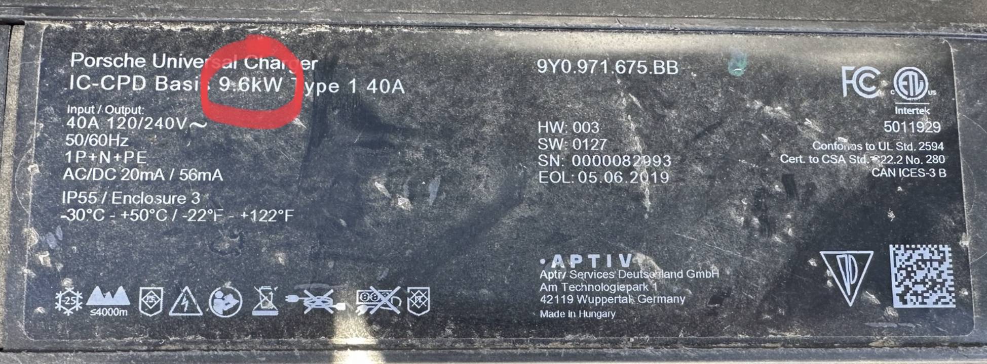

part number for one of the Porsche chargers is in pic below - part number is clearly on the unit - 9Y0.971.675.BB - not sure if this is the PMC+ or PMCC - but you get my point - it's inconceivable to me that they can't figure out the part number - it's printed on the unit itself.
NOTE: the charger is probably fine, but the cables (including the J-1772 cable) is know to fail - did they try swapping the cables to make sure that' was not the failure?

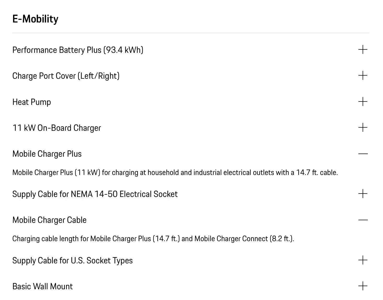

standard equipment for Taycan (Cayenne eHybrids, Panamera eHybrids) is the PMC+
the PMCC unit is an additional $1120 "option" at order time…
2020 Taycan's were required to purchase the $1120 "option" - it was not optional even though listed as such on the "build sheet"
2021 started w/PMC+ as "standard" equipment and the PMCC was then truly optional ($1120) - and mostly not worth it.
both products have simliar faults and short comings…
the standard equipment for Taycan lists the "PMC+" in the eMobility sections…see pic below…
