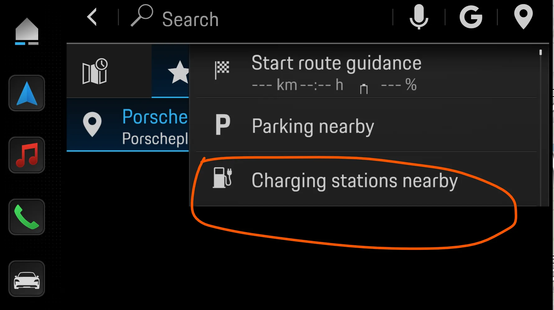

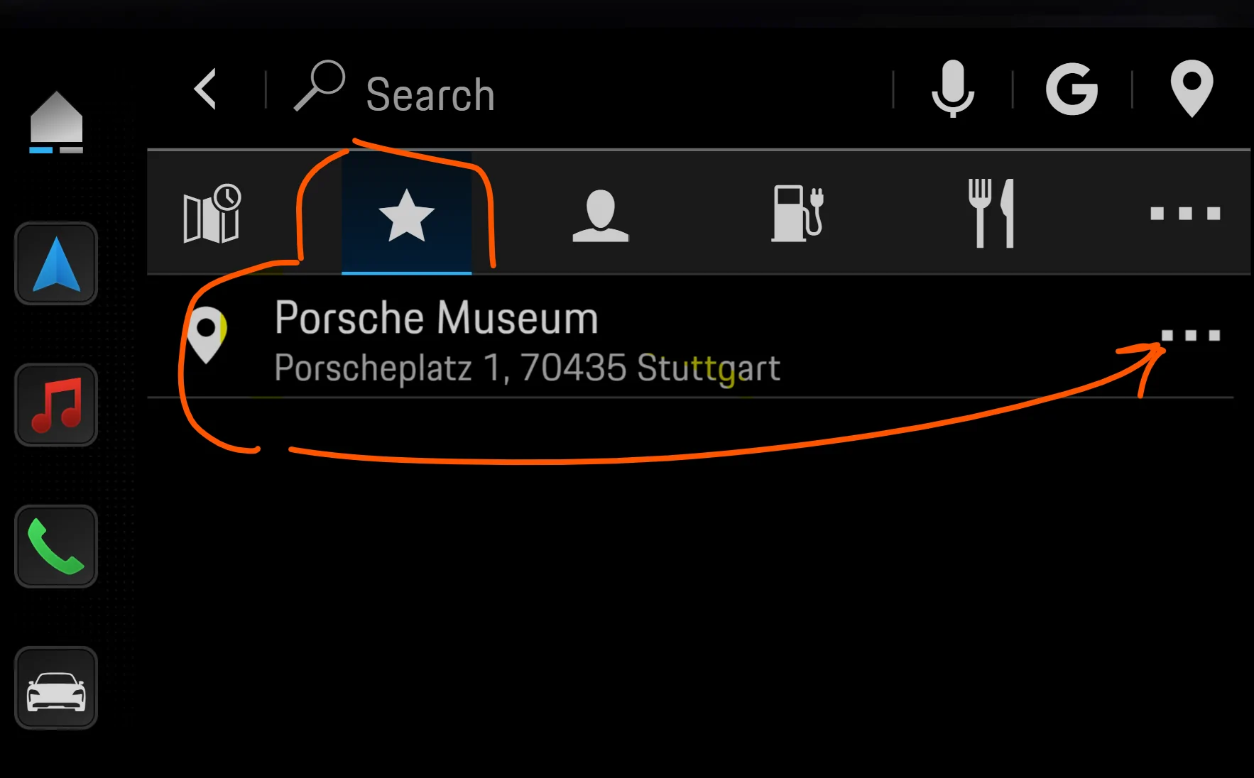

The trick that I use is to make your destination or area where there are fast chargers a Nav Favorite. Then you call out Charging Stations Near By via 3-dots and that guarantees that you are properly pointed to a charging station with battery pre-conditioning started, but you still need to watch your battery temp to be sure it is going up. The standard method is to locate your charging stations under the charging station icon in the Nav that is also shown in the images below.

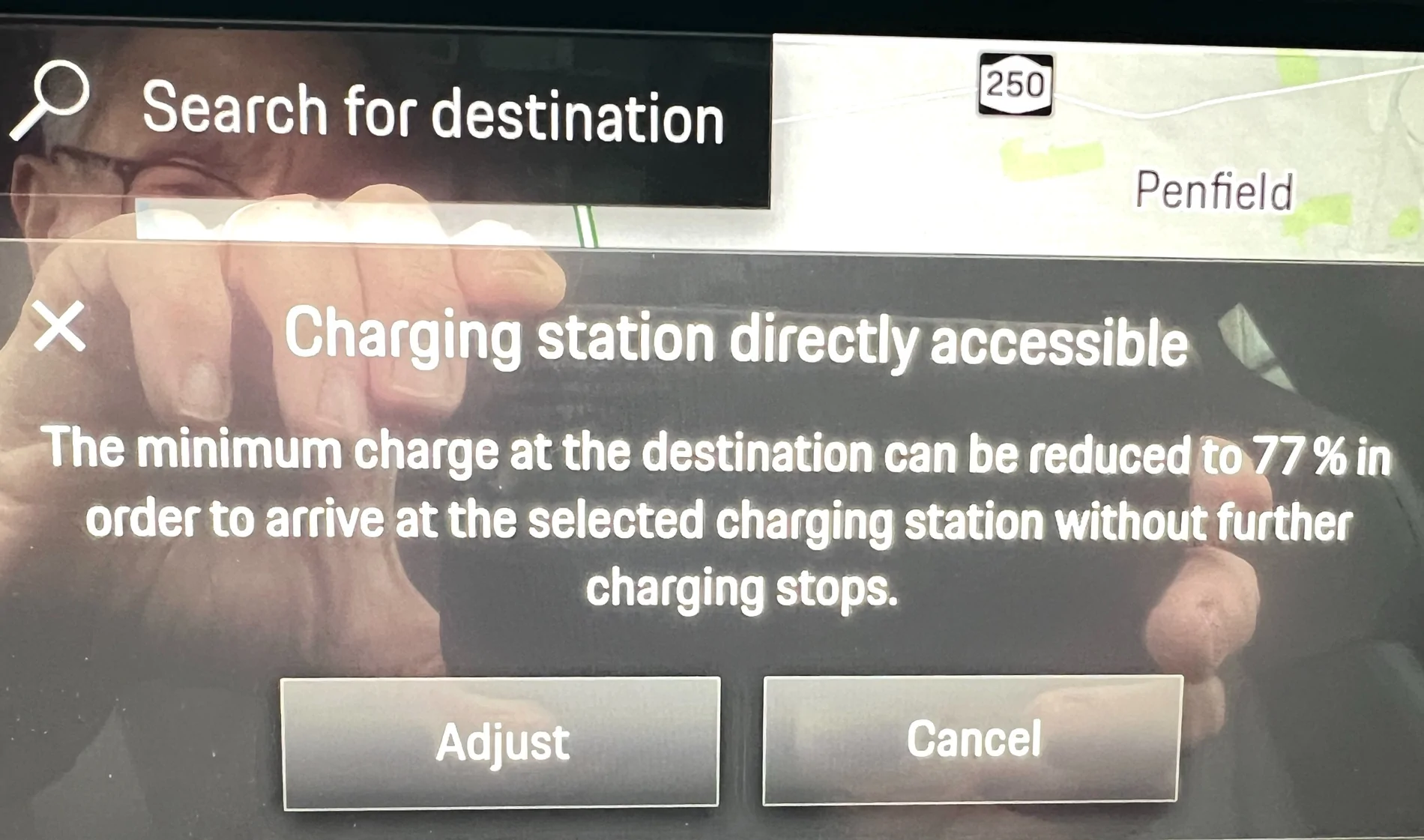

I appreciate the comments on cold-weather charging. My wife and I moved from SoCal to upstate NY. I hadn't thought about preheating the battery and upon arrival at a charging station with the battery at about 24 degrees F, I was charging at about 9 kW. We're temporarily in a condo building that doesn't have charging capability, so we are going to an Electrify America charging station approximately 12 miles from our condo. Recently, when I put that destination into the PCM nav system for preheating, it showed 12 miles and about 71 minutes (it's an 18-minute trip). On this and previous occasions, the routing shows that we will bypass the charging station and get on the NYS Thruway (toll). It arbitrarily sends us east although perhaps there is a round trip built in to allow enough time to preheat the battery. (This is crazy.) On another occasion, it kept trying to stick with a route that was hugely out of the way and (again) on a toll road to the charger--perhaps to allow time for battery heating to 85+ degrees?
The SOC was about 28 or 30 percent, and if the system was set for "arrive at the charging station with at least 20%, perhaps it was taking us to another charging station, which is a bit too much decision-making on the nav's part. There was a message that popped up when entering the charger destination with the option to change a battery percentage. I attached a photo. I should research this on my own, but using the TaycanForum shortcut is too tempting!
I would value any information on what is happening when preheating the battery on the way to a charging station selected from the PCM menu. Thanks!

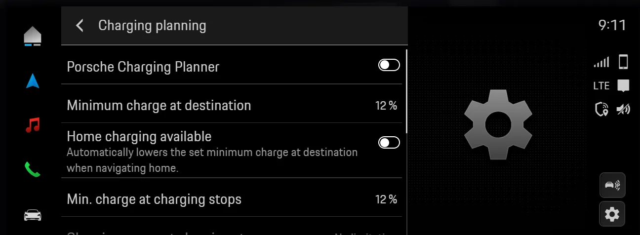

@AtTheGlen In PCM: Home > Settings > Navigation > Charging planning.
See what values are set for minimum charge at destination and min. charge at charging stops.
That may help you figure it out. Good luck.

@Tooney Thank you for the lead re: "Charging Planning". It turns out that the "Minimum charge at destination" was set for 80%, which I think would suggest that the travel planner would not send me to a charger any farther away than would result in a charge less than 80%. That would be quite limiting! The console view shows 80% as the target charge (when not using the travel planner, it's at 85%). I cannot increase the 80% target once routing to a charger has started; however, I can continue charging past 80% if needed, e.g., because of a lack of chargers along the route that I'm taking. Acquaintances who are not yet EV adopters would probably say this is more complicated than filling up their gas tank. I guess I'd agree, but they are missing an exciting driving experience.
