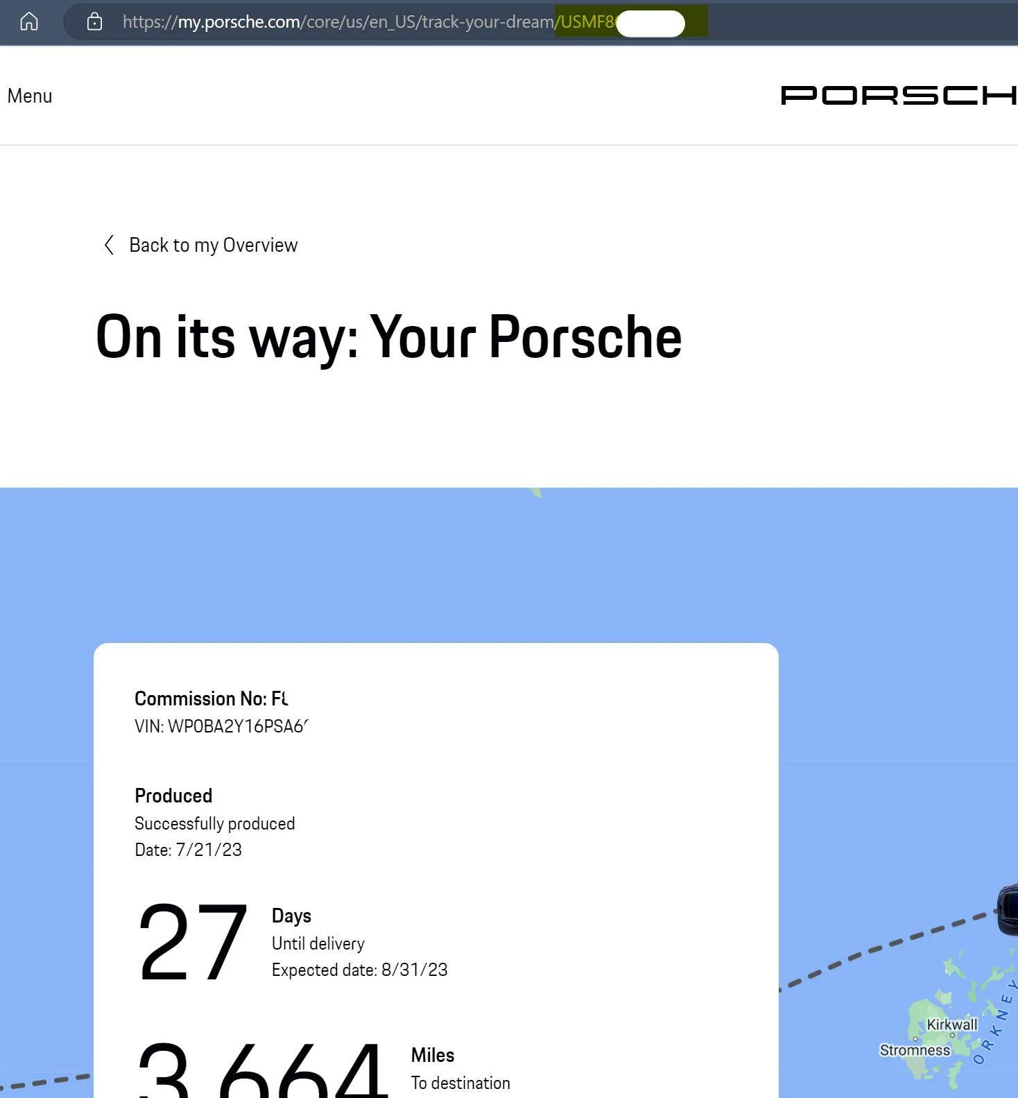

You can find your ship without talking to the dealer, but it takes a little bit of detective work.
First go to the track your dream page on a PC. Make a note of your full commission number in the address bar up top.
Porsche Taycan Finally my taycan is on a boat. 1691163535438

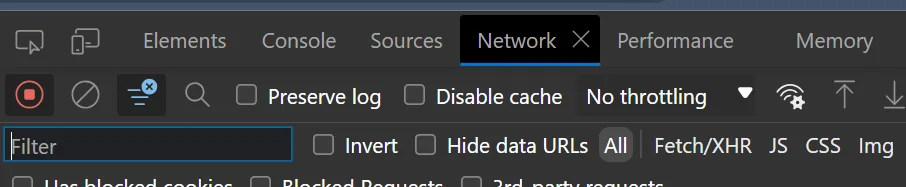

From there, you need to bring up the developer tools. I'm using the Microsoft Edge browser, but others are similar. I press F12 to bring up the tools. You want to select the Network tab because you want to sneak a peek at the order data being sent to your browser.
Porsche Taycan Finally my taycan is on a boat. 1691163720572
Now, refresh the web page and you'll see all of the various files being sent to display the web page.

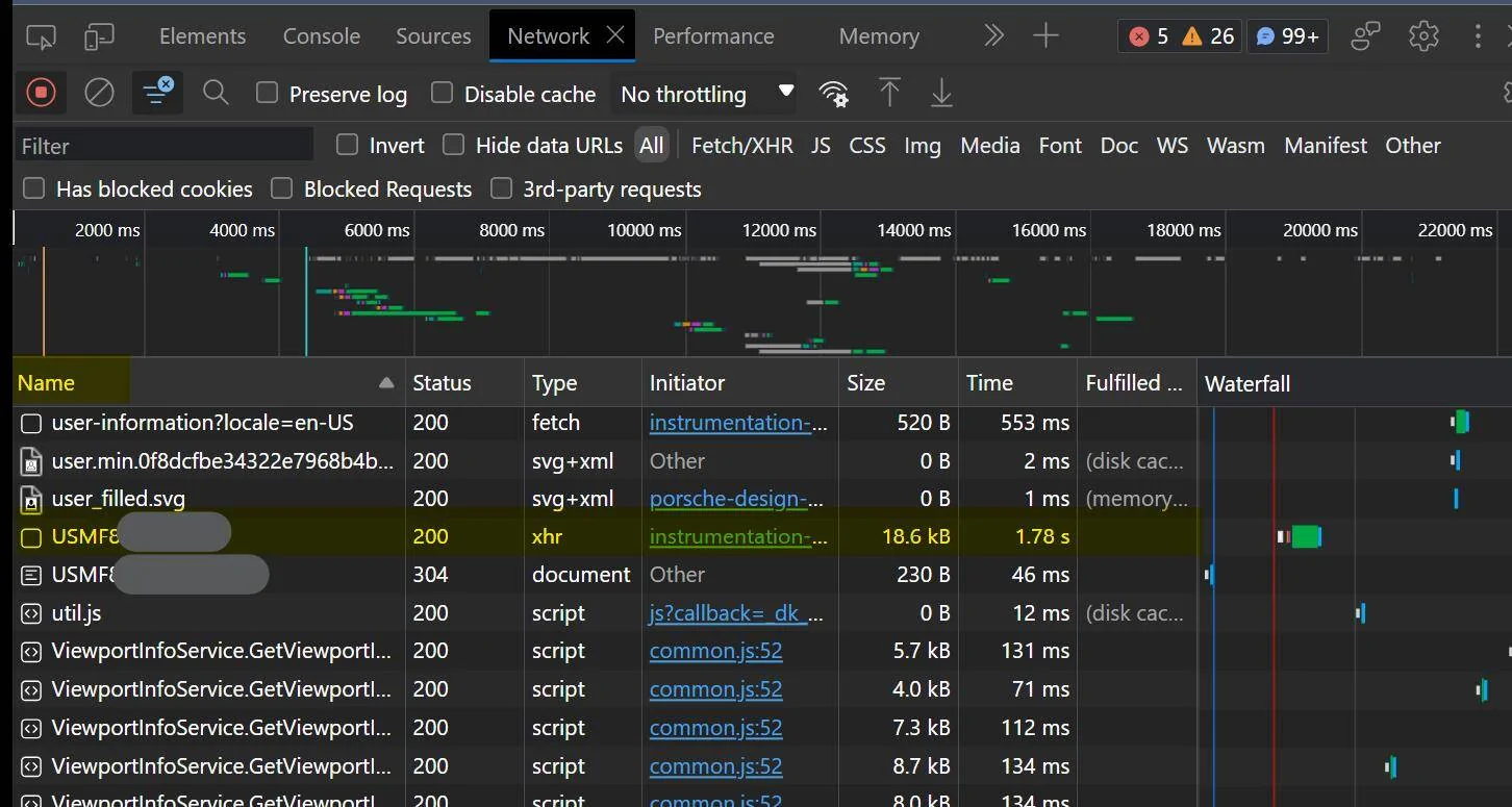

Once the files have finished loading, click on the name column to sort by name and look for a file that has the same name as the full commission number from the address bar.
Porsche Taycan Finally my taycan is on a boat. 1691164137475

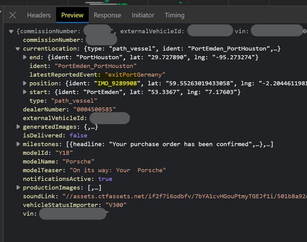

Click on that file, and make sure you have "preview" selected so you can browse the data. This is the unique information about your order that TYD uses to customize the page for you.
If you expand the currentLocation bit, you'll see a section labeled position. The identity of the position for my car is IMO_9289908 that's the International Maritime Organization serial number of the ship the car is on. In my case, that's the Lake Taupo.
Porsche Taycan Finally my taycan is on a boat. 1691164438673
Go to shipinfo.net Find a ship location, online on the map. Tankers, yachts, containerships, cruiseships. Locations and coordinates. (shipinfo.net) and search for that IMO number and it will show you what ship you're on and where your car is.
Or, you can email your SA and ask them which ship the car is on.
This process worked perfectly. Thanks!
