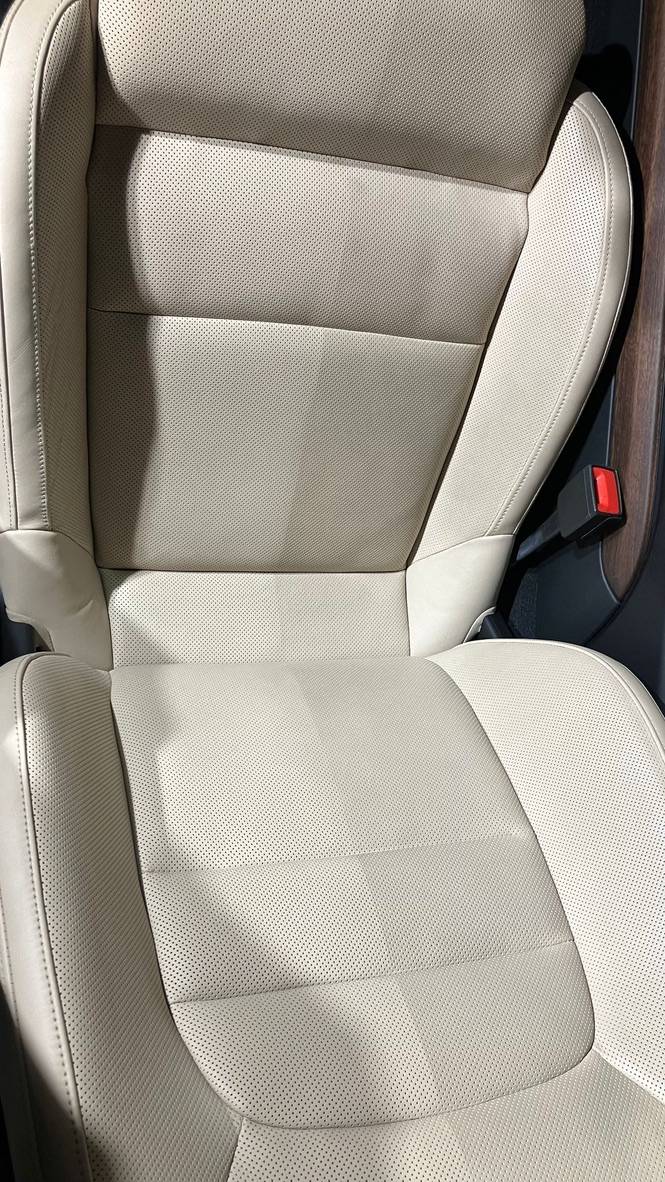

Check out Gyeon leather treatment (professionally applied). This photo was taken by forum member @Adrian@GlasWerksDMV about 40,000 miles after his team applied Gyeon. They said it was very easy to clean. This is Olea leather in Atacama beige by the way, and I took no special precautions to keep it clean.
did they only clean half of it or something? or is it meant to look like that?
