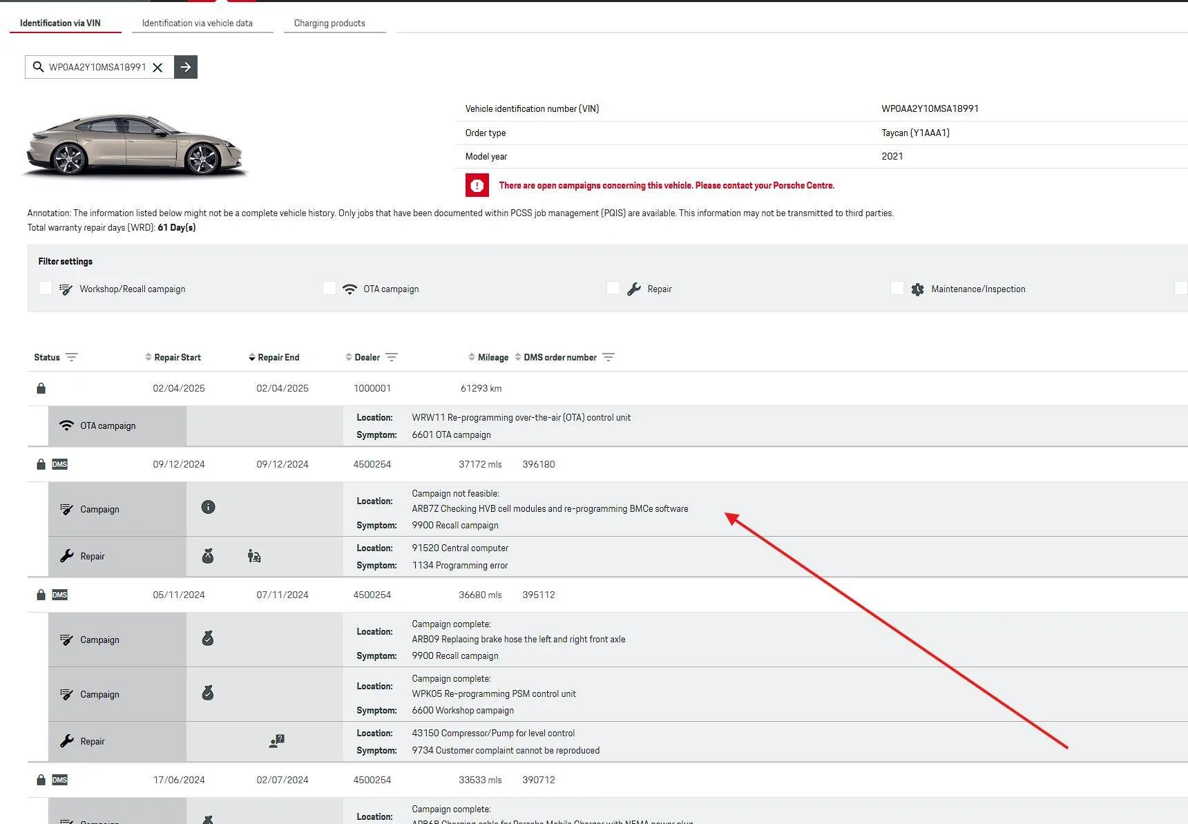

LOL... As I so often see... The dealer lied once again.... I guess that just dont wanna take the heat.
Porsche Taycan German Taycan burns down in Belgium 1750430114408-zj
Porsche Taycan German Taycan burns down in Belgium 1750430148809-

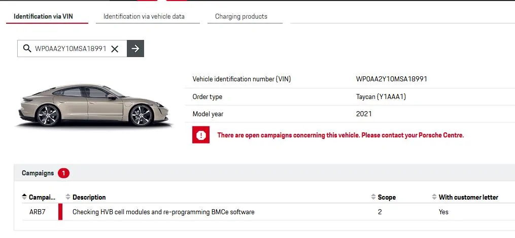

Or are you claiming your Taycan report doesn't show any active recalls?

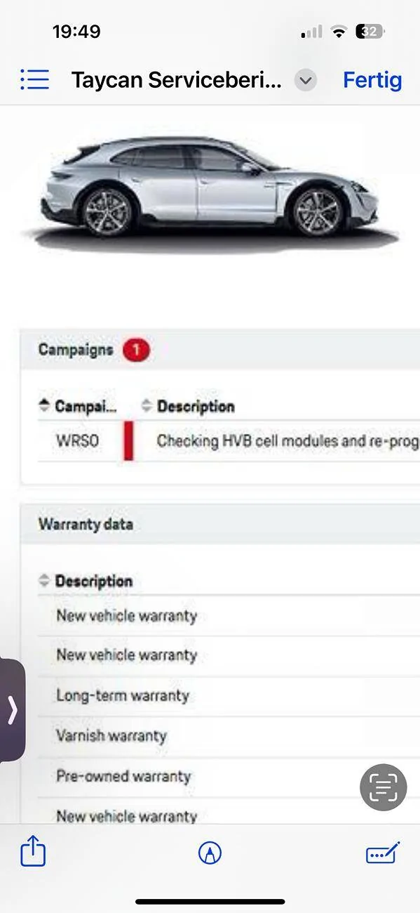

Porsche Taycan German Taycan burns down in Belgium IMG_9106

You have WRS0, which is the work campaign of both ARB6/ARB7. So I would assume some sort of mistake by whoever checked your car, marked ARB6/7 as "campaign complete", when they should have checked it as "campagin not feasible" as the actual work campaign, WRS0 wasn't done.
At least that's how I interpret it / see it.
That being said, there are multiple people saying they don't have any of those campaigns - a minority, even according to CT14. I don't think you are one of them, but for sure there are some - like all Belgians - who knows why...

Ok, I understand. Just referring to ARB 6/7, not being visible in my current report.
As of now (waiting for Enet Cable to do the check), my battery is at good health, having over 95% SoH and currently giving 404 km on 100% (odo close to 60 Kkm).
Of course anything can happen. Had a Turbo once blowing up at 200 km/h in a perfectly maintained car, also not expecting that.
Oh, and my 993S losing compression on a trip, resulting in 14 k of repairs. Also perfectly maintained. ?

WRS0/WRS1 are independent of ARB6 and ARB7… Also ARA4/ARA5 is another independent recall
even if they all concern the battery and the symptoms / failure mode are basically identical…. The reports are not!
