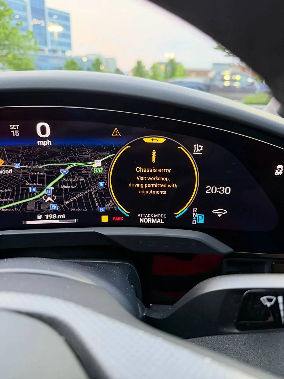

Has anyone see this error?

Seems they are replacing the whole active ride hardware.. Will take weeks....
Just keep all records in case it goes over 30 days so you can lemon out the car.

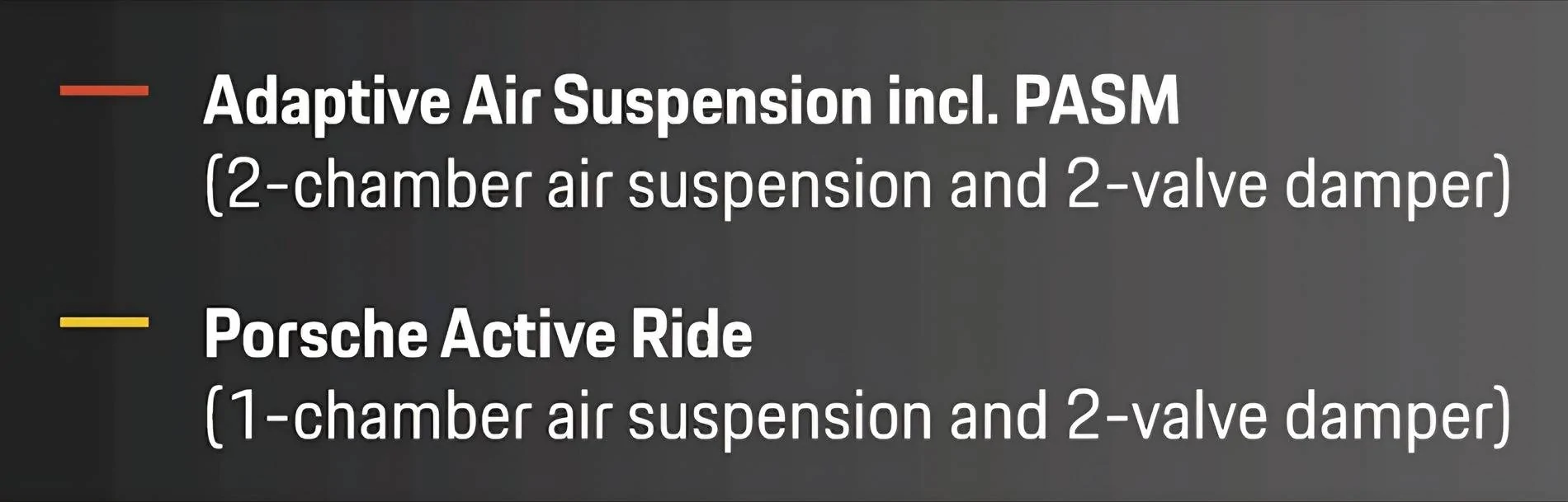

Also it looks like PAR uses a different air suspension than the PASM
Maybe @f1eng would know more
I haven't checked but the suspension side is likely completely different even if the damper is the same.
Mind you a "full active" suspension would simulate damping in the maths and apply the loads via the struts so if there are separate dampers it is not full active as I would understand it and as most used in Formula 1.
There are a lot of possibilities for suspension dynamics, all called "active" due to microprocessor controlled intervention.
The system I did at Williams was unique and when I was chief engineer at Benetton the two systems we tried, one by Benetton and one by Ford, were different to each other and we ended up with a hybrid with Ford software running on a Benetton designed and made controller. It was designed not to fall apart due to engine vibration as pretty well all commercial electronics did.

Just got the chassis error this morning as I was leaving for work. I stopped at a coffee shop grab some coffee came back out, the error was gone, so I’m not gonna take it in until I see if it happens again.
