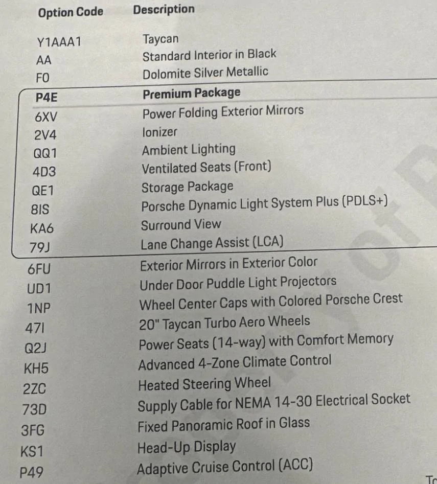

Premium should incorporate Bose (upgrade) as standard and on top of that you might find a car with the high end Burmeister.
I thought this was done for 2024? I have a 2023 with Premium and it doesn’t have Bose.
See attached pic from my window sticker.
Seems like it may have depended on the year; the Bose system was part of my 2021 Premium package.
Darn, wish they didn't skip it for the 2023 Premium package - that was the only feature on my wish list that was missing from the build that I bought. It was low priority, so I bought this build anyway.
Apologies I thought US market had this as part of the package
