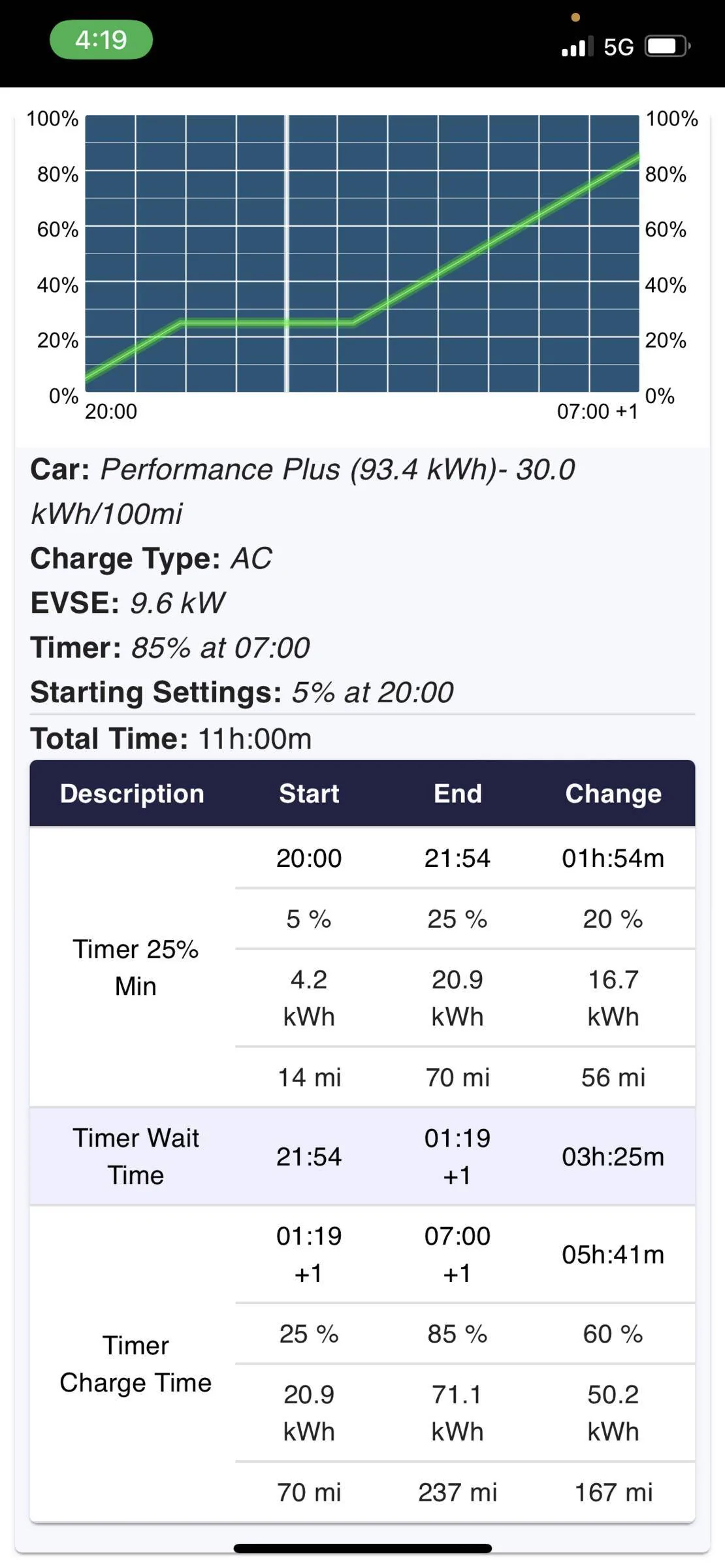

I have been charging my taycan 2021 from 11pm to 7a using the home profile for months and all of the sudden this week, the car will no longer follows the scheduled charging times.. It charges fine with direct charging, but the scheduled charging no longer works. In addition I have also always had charging timer set to 7am at 85%.. Haven't had any issues with this ever..
It seems like when the scheduled start time happens, the car starts to charge, but changes it mind and stops.. Have tried two different chargers with same results.

What state is it in instead? Waiting? Error? Calculating? Complete?
How long does it try for before it stops?
Have you tried deleting the profile? Unless you want a higher minimum charge than 25%, the profile serves no purpose if the timer is scheduled for the end of the preferred time.
You can also try deleting and remaking the timer, but I would leave the profile out of it.

It is just in waiting mode..again, this has worked fine for months until this week.. for electricity rates purposes, I can’t start charging till 11pm..hence the profile.
I have deleted profiles and timers multiple times and re added with same result.
It would start charging before 11 with the profile if the timer requested it. The profile isn’t doing anything. I would try to delete the profile and only use the timer.
What size EVSE do you have? It wouldn’t start before 11 on the timer for 7am @ 85% on 9.6kW anyway (other than the 25%min).

Porsche Taycan Home Profile Stopped Working B2811490-63A3-4662-B082-06AB95F5B749
