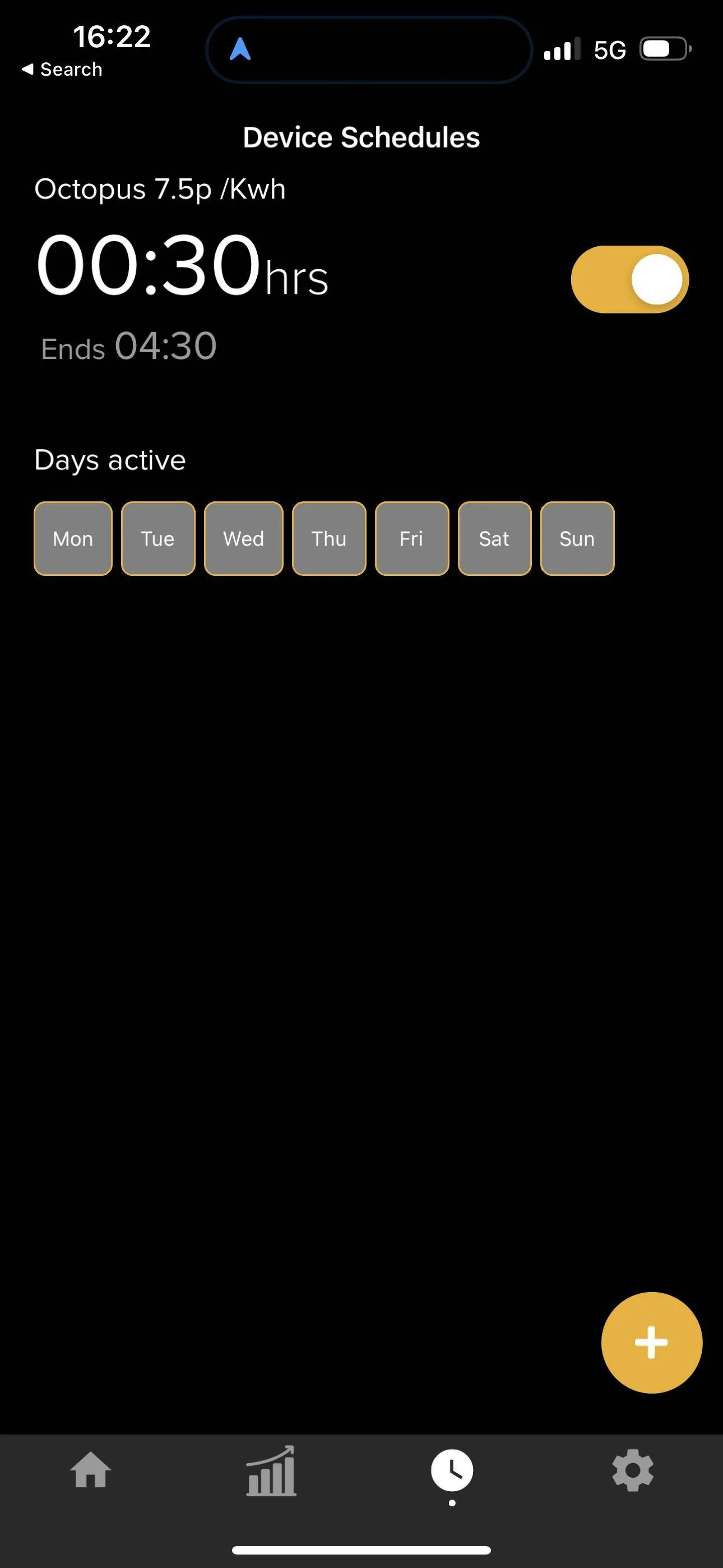

Do you have a smart charger ? If so use the App for the charger instead of the Porsche timer. I have an Andersen Charger and use the konnect app to
Porsche Taycan Charging timer / schedule for home charging not working in app 661DE5C3-9B8C-4294-A2E2-CC594F265FDF
charge just between 0030 and 0430 for the Octopus Go tariff.

It causes a conflict. To keep things simple I have only set up a 85% charge as a general profile. I use the Konnect app to control the charger (0030 - 0430) for Octopus Go.
