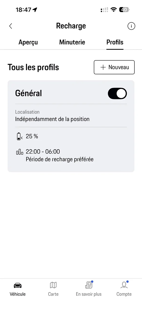

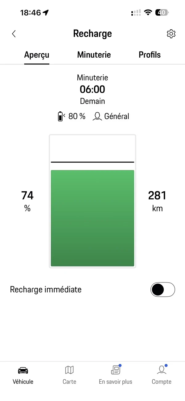

Did you try to turn off all settings in the app, send that to the car. And then set everything again as wanted and send it to the car.
This helped me once when she didn’t charge as desired.

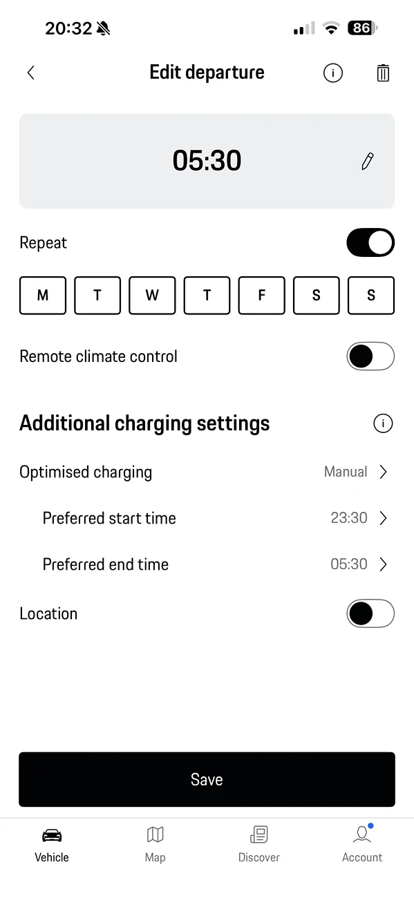

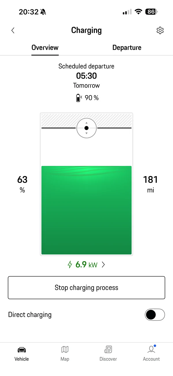

Thank you for your reply --- yes I completely erased all the settings on the app and even the PCM (post hard reset) and still no luck.

Surely someone else has had this situation? I called PCNA and that was a waste...I guess its a dealer visit.

Well I finally got around to doing this- didnt drive the car the last week of July and still no luck.
Did another PCM reset and the re-entered my desired charging times etc. NADA... I appreciate all your replies and offerings. It just doesnt want to comply sadly.
