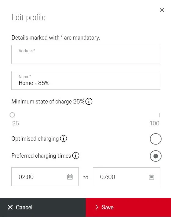

Don't use the General Profile - create your own location based one.
Don't set the minimum charge level to 85% (25% is more normal) otherwise you will start charging immediately.
Set the target charge to 85% and the rest should take care of itself (assumi
Porsche Taycan Charging Problem Profile - Preferred Charging Tim
Porsche Taycan Charging Problem Daily Timer
ng there is enough time to charge from plugging in).
Set preferred charging times if needed.
