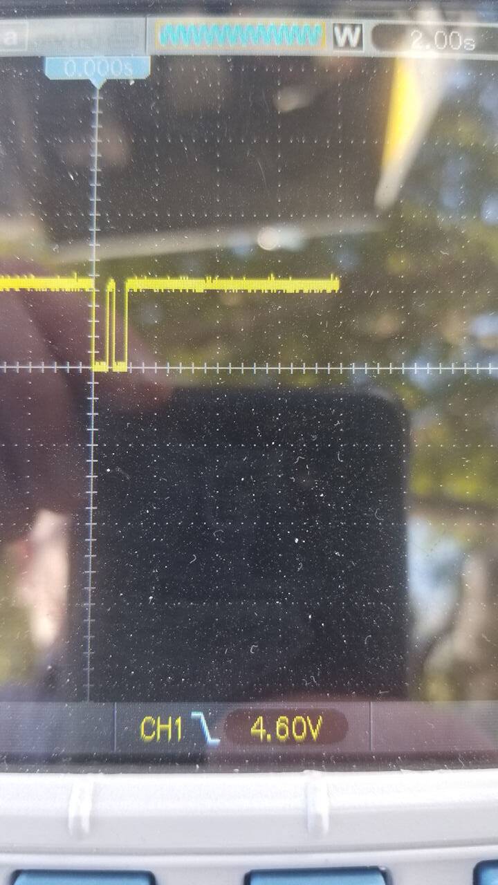

I have the same problem. I connected an oscilloscope to the gate receiver and pressed the Taycan 'button." The screenshot proves that there are two pulses being sent within one second! Some gates (like mine) respond to the second pulse and stop moving. Others don't seem to mind.
BTW, I tried holding the finger for one second suggestion - same result. Also tried the 'two finger' suggestion - same result. I have sent this on to Porsche, but I ain't holding my breath for any reply.
I actually had to make a claim with Porsche for the damage to my car as a result of the faulty Homelink, so it is being investigated by the manufacturer. Hopefully they fix it soon.
