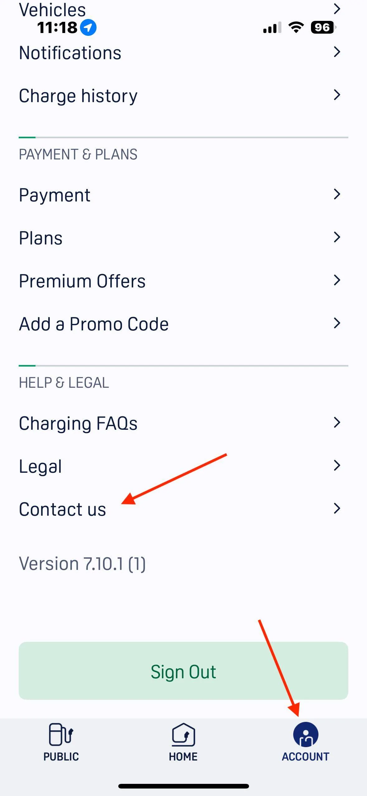

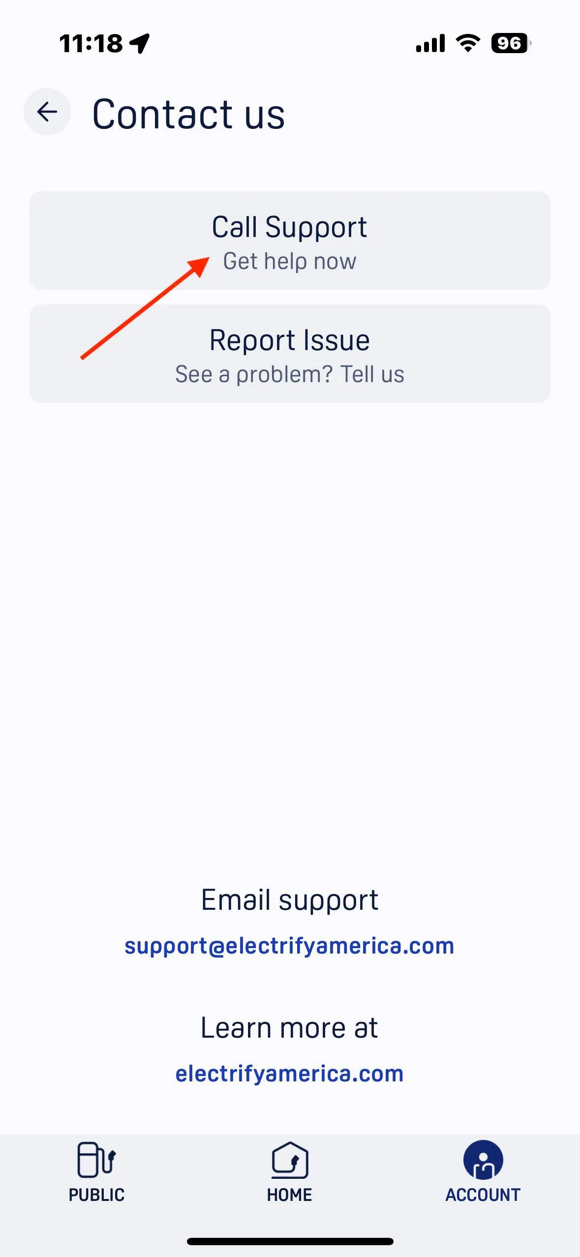

I've always just gone via the app (see my photos I am attaching here for your assistance). I've always used the ph# that pops up that way. I think there is a ph# listed on the terminals but I've always just used the app. From there I have followed whatever prompt for "assistance at a charging station" or whatever the query is -- but it's been a few months so apologies, I dont recall specifically. I've had it where they rebooted a machine, and that typically works. That said, I have had 5+ minute holds when calling on a weekend; but week days I usually reach someone quickly.
