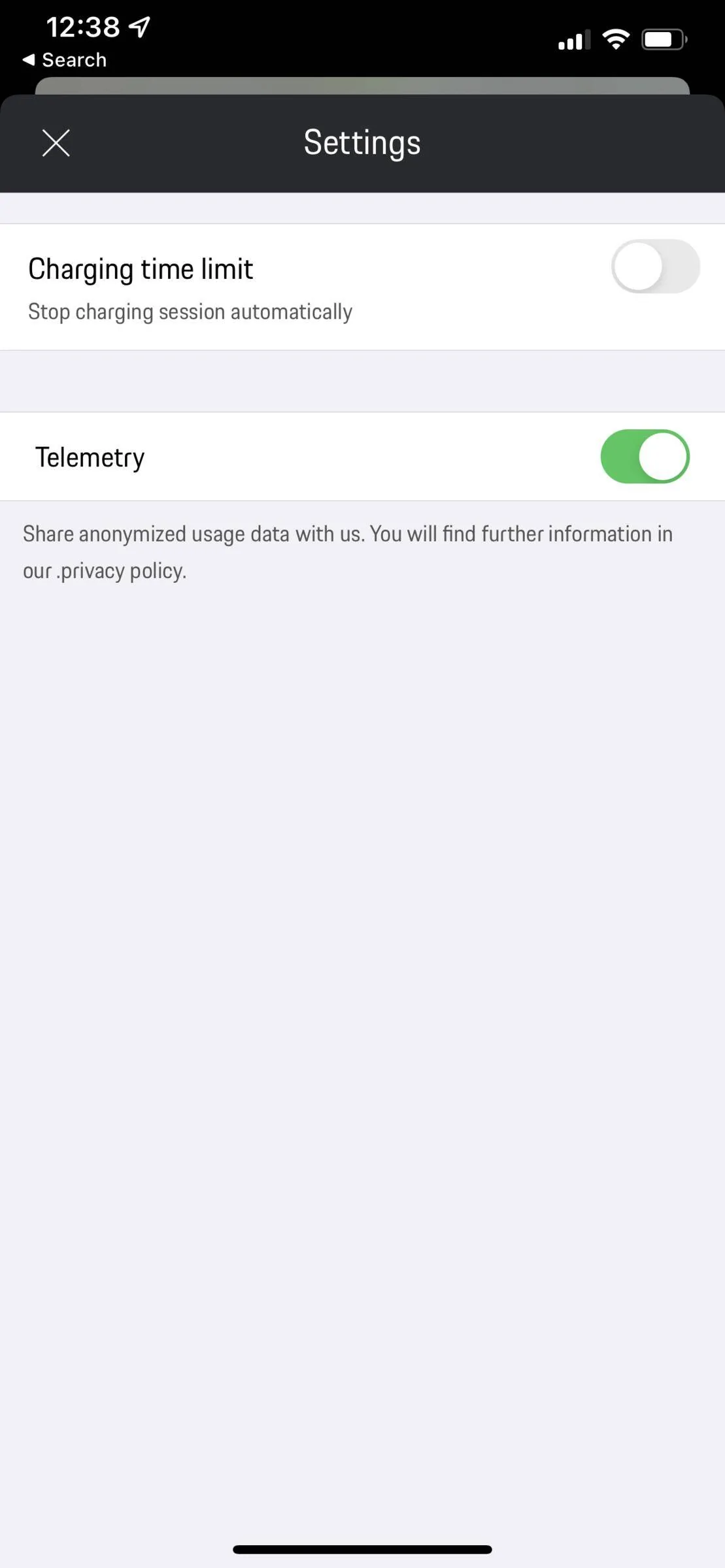

Hey OP! The same exact thing happened to me a few months back. Open the Charging App. Hamburger Menu to Settings and check the first setting as in picture

For some reason one day my Taycan had the time limit at 5 mins and not even EA knew why it stopped. Hope this helps!
Thanks, what app are you speaking of? The My Porsche?

No. The Charging App
This
Thank you, the EA help desk said you no longer need to use this app as they rolled it into the My Porsche app. Once you set up the EA account in this app then no app is needed, just plug and charge.

Oh ok. In my case, my charge stopped because of a setting there and EA had no explanation
