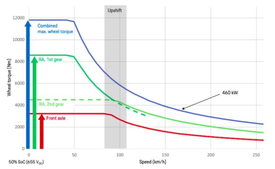

Really I'd just like to understand the torque curves for LC and non LC.
Maybe I’m misunderstanding, but below is the torque curve:
Porsche Taycan How does launch control help acceleration C08032D6-E5AA-4EB5-A5FD-69E6BD8D033F
Below base speed, the current/torque is constant while voltage increases proportional to speed.
Above base speed, current is still constant, but so is voltage, so it’s constant HP and torque falls off.
The difference between non-LC and LC HP varies from 8.5% (Turbo) to 25% (RWD) depending on model. The torque curve should stay the same shape, just higher.
Thanks, yes this is the question, is the torque curve the same shape just higher or does the constant torque part of the curve extend to higher revs. Either could make more power for launch. It looks like there is nothing published on this.
Interesting discussion. My guess is in overboost mode, the left side of the torque curve is the same and right side of the torque curve is "flatter", in other words does not go down as drastically with revs as they would under non-overboost mode, which would result in higher peak HP with no change to peak Torque. Peak power comes in at higher revs (like 10K rpm), and at that point the torque is way lower than peak, so by simply increasing torque at those RPMs, they could bump up the HP. (and that likely is the way to get more HP from the engine for brief periods without creating excessive heat). Porsche clearly distinguishes between Peak HP between over-boost/non-overboost modes, they could have done the same with peak torque if there was really a difference there.
