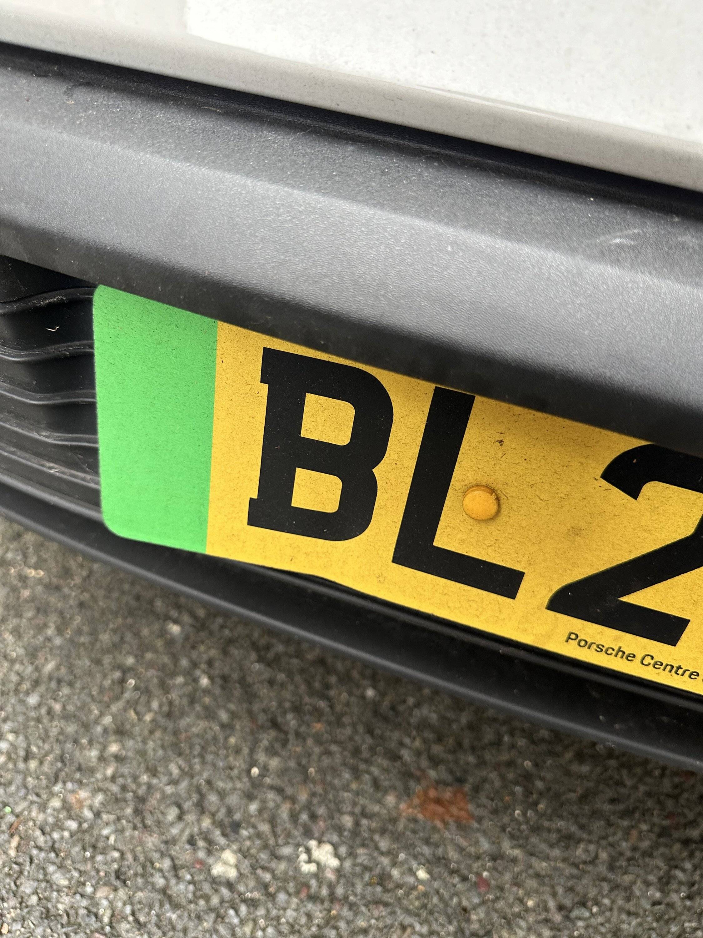

someone has clearly tried to pull off the rear number plate on my Taycan while it was parked in the street, they didn’t manage but have bent it a tiny bit so I’d like to unscrew it and bend it back into shape before reattaching it.
does anyone know how I unscrew the rear number plate please? I can’t find it anywhere online so thought one of you might have an idea.

Are you sure your number plate is screwed on, cos if you can’t see the two screws, then I’m pretty sure the plate will be affixed using adhesive pads, in which case it’s a matter of carefully prizing the plate off…..using a hairdryer to warm the plate helped in my case.
Yeah, it’s like this (see picture :)

Then all you’ve got to do is pop off the plastic caps, and underneath are the screw heads.
