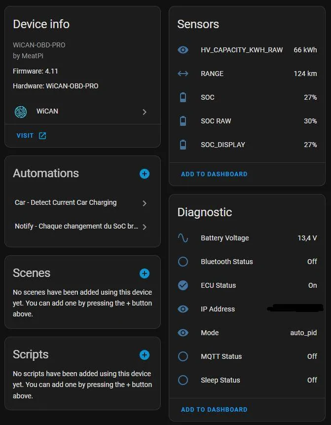

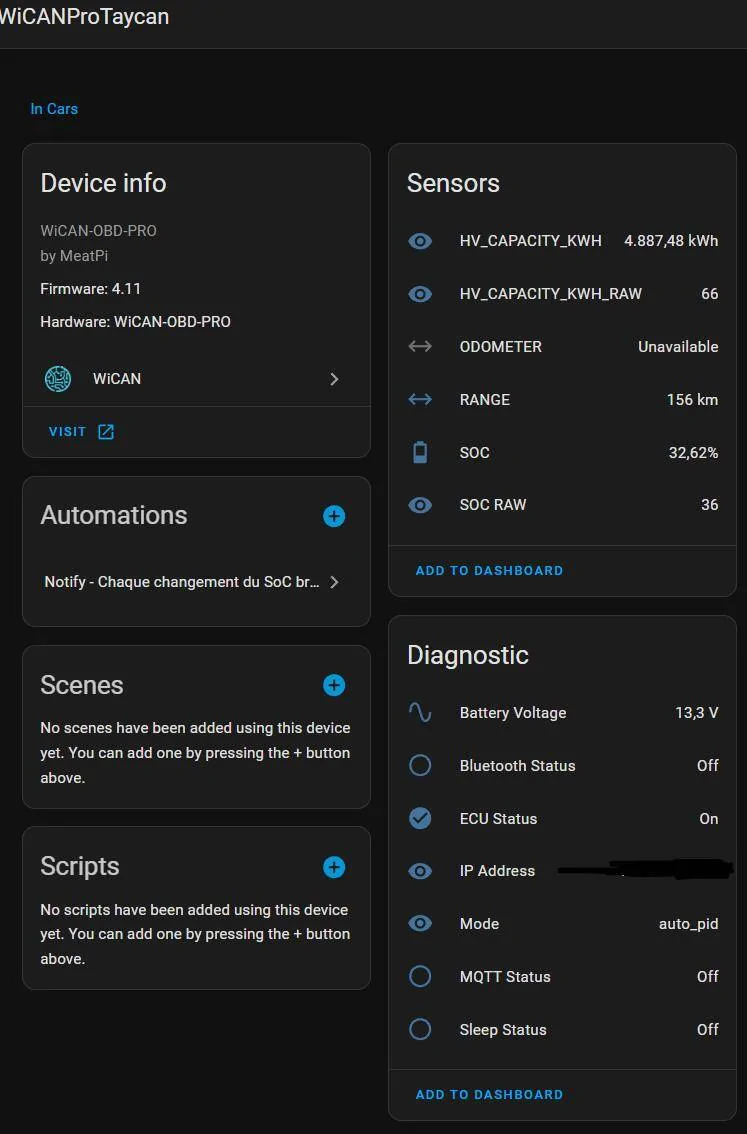

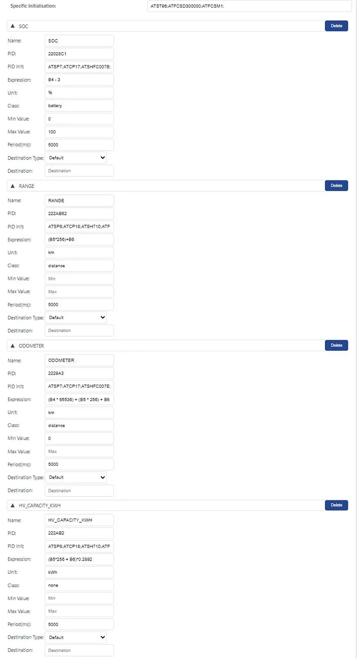

I sent the file to the developer, so it should be integrated in the default profiles soon
Hello , great work ,
i just got my WiCan , did you manage to add any other sensors ?
Sebcbien
Sebcbien
Seb
Sep 9, 2024
51
BMW I3 - Taycan CT 4S
Hello, no, no more sensors and the developer included "my" settings in the defaults.
I stopped using it because on some occasions it triggered the alarm of the car during the night.
I didn't try with the lates more advanced firmwares.
