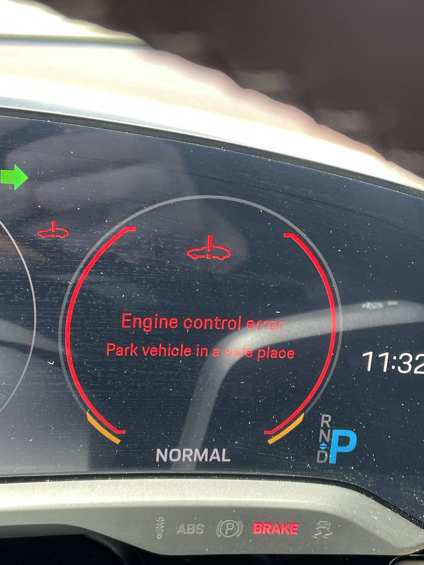

I had an issue in the UK tonight. I thought it odd that car went into range mode even though I had air con on. On M3 motorway... sat nav took me off at junction and then straight back onto motorway. Then the PCM system blanked and looked like trying to find a connection. Several miles later when I’m in the outside lane I felt a loss of power although nothing showed on dashboard as others have said. I managed to get over to inside lane probably about 50 mph maximum and won’t go faster. I saw signs for Fleet Services so made my way there ... just before I turned off I felt a power surge again. Got onto services and turned car off. Waited about ten mins and started up again. Went into Normal Mode and 60 miles home was fine except M25 congestion.... is this the same issue. Should I report to the dealer?

Not sure. Range mode does limit the car to 100 Kph and the car is not as responsive. Mine actually lost complete control of the pedals and steering - the drive control system.
