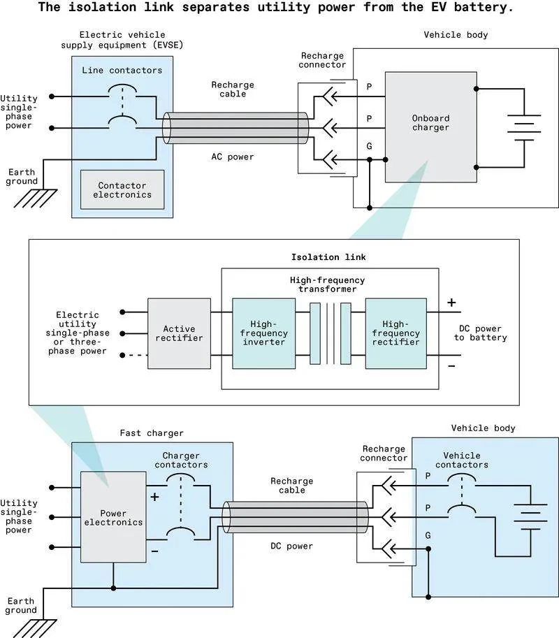

EVSEs are not chargers. Both AC and DC chargers are built into the car.
That is incorrect. An EVSE delivers AC power to the onboard charger. All DC chargers you connect to are in fact chargers (not EVSE). They are actually very similar to the onboard charger except typically capable of much more power.
Porsche Taycan I need help choosing between 2 Taycans 4S 1742114290523-m
The above picture came from this article, which is about proposing a new, less expensive way to build chargers, but the picture is above is about how things work today.
