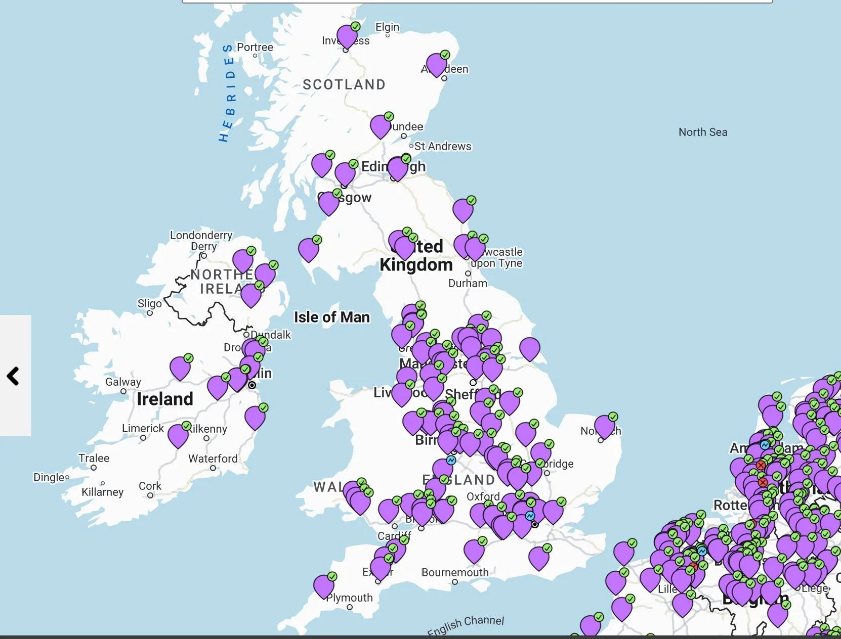

Zapp Map is one of many apps showing you what chargers are where.
Map of electric charging points for electric cars UK: Zapmap
These are all 350kW chargers. Not hard to find. And becoming more prevalent all the time.
Porsche Taycan I need help choosing between 2 Taycans 4S Zapp Ma

Search the forum. There are dozens, if not hundreds of threads on this sort of thing.
If you don't have a home charger, charging it will be expensive and a grind. Not recommended.
