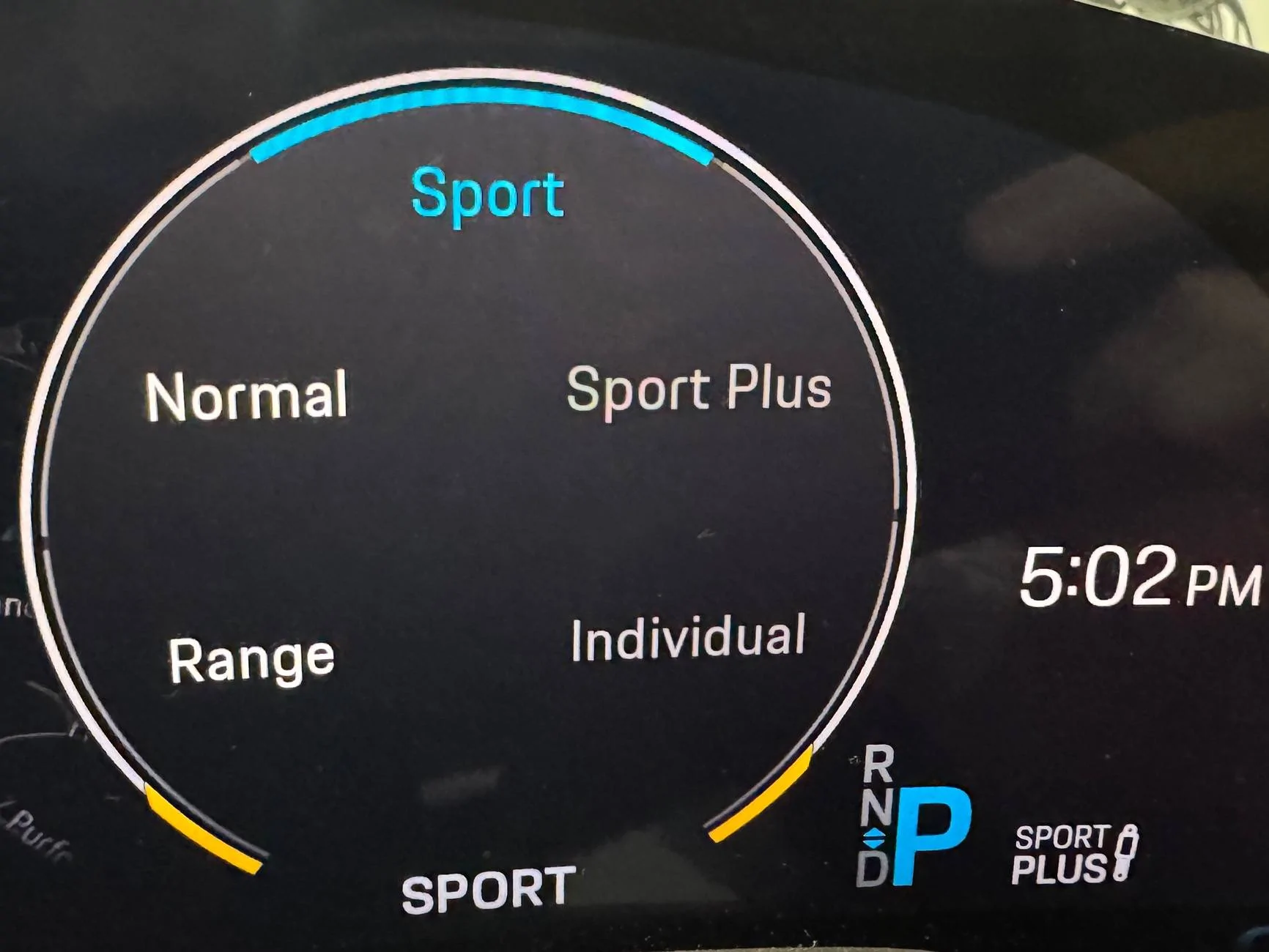

isn’t he implying no coding is necessary for the drive mode selection to work via the knob but just not sport+ or individual?
If you only want to switch between the standard normal/sports drive modes, then it is “plug and play”, but it would not be the full functionality of the Sports Chrono package.
Elysium
Mar 17, 2025
2021 Taycan
If you only want to switch between the standard normal/sports drive modes, then it is “plug and play”, but it’s would not be the full functionality of the Sports Chrono package.

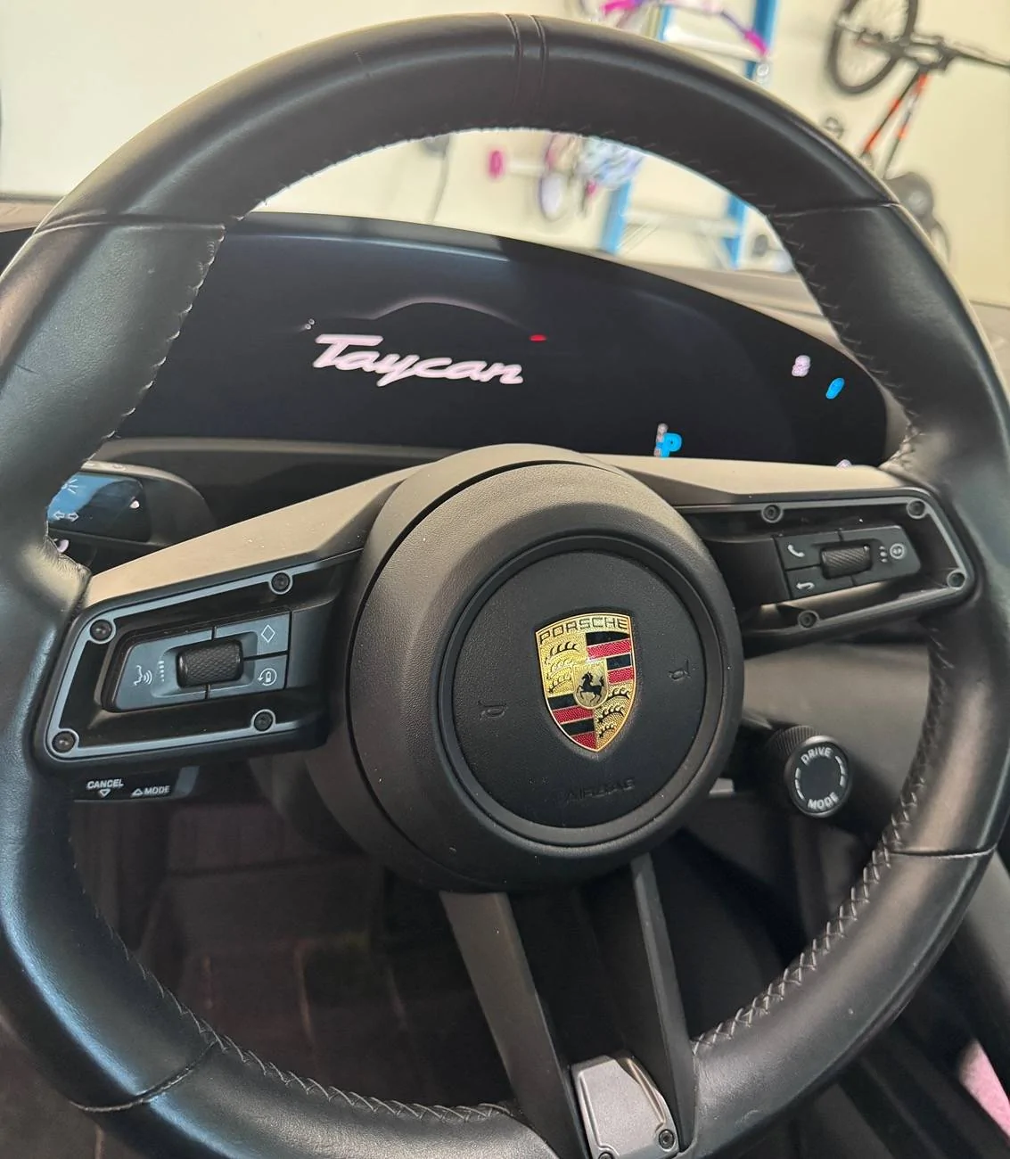

It doesn’t unlock Sport Plus or Individual drive mode but outside of that, it is absolutely plug and play for switching between the drive modes that you have. It’s a little tricky to see from pictures but the ‘Sport Plus’ and ‘Individual’ options are visible but slightly greyed out and not selectable.
Porsche Taycan i need to activate sport chrono IMG_7733
Porsche Taycan i need to activate sport chrono IMG_7735
EDIT:
Wanted to add that no other modifications were necessary since I have received some PM’s asking about this. No control box swap or anything else is needed.
-Car off, key away, steering wheel straight.
-Depress pins on side of trim to release airbag.
-Disconnect airbag connectors and set airbag aside.
-Disconnect main (yellow) connector in top center and heating connector(as applicable) in mid/lower left.
-Remove main wheel bolt
-Remove wheel
Install is reverse order of the above steps. I also applied blue loctite and torqued to spec.
