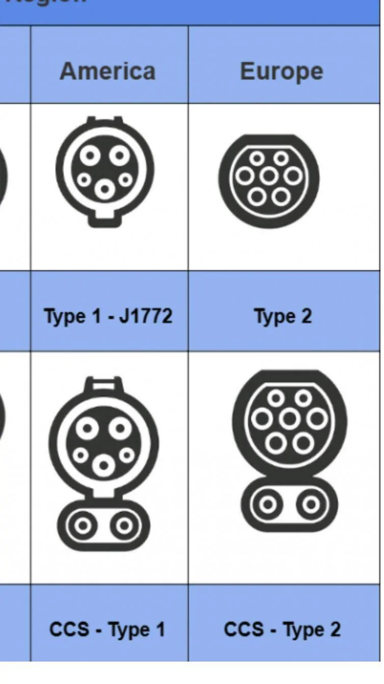

Do you guys know if I can import an US Taycan in Germany in terms of charging compatibility? Or other EV specific issues?

I would think its cost prohibitive. Porsche does not allow you to do European Delivery of a Taycan. So it's not like you can just use an adapter.
To start charging connectors are different between the two regions. Also you would need to look at the PET diagrams and see if there's any difference with the onboard chargers/communications modules, etc.
I would also suspect the car would need to be recoded for Europe.
there are adapters for the charging port - would need one adapter for AC charging and another for FastDc
could/would Porsche swap/install the US charging port for the euro-charging port - I'm sure it's possible, but it may not be feasible with out special permission/instructions from Porsche to the service tech
it will take time - to make the changes - since it's not a common process car modifications could be delay'd for quite some time while Porsche works up the procedures for the euro modifications…
there may be software differences (matrix lights for example) than can not be "swapped" and other regional legal requirements - new software image loaded onto all vehicle systems? again possible, but does anyone really have the procedures for such a thing? probably not - again more delay while Porsche figures it out for tech instructions - _IF_ they agree to do it…
will it be cheap? - most likely not…
can it be done, Sure probably
can it be done in a timely fashion - probably not…but maybe.
but you could probably sell the current Taycan for good money
lease a euro Taycan for equal or less money than shipping/modification cost
and then buy a new shiny Taycan with all the +1 enhancements when you return to the US
that would be my path - rather than throwing money at fairly specific modifications that no one will understand/want if you go to sell the vehicle.
Max AC charging would be slow for US car in EU, as it could only utilize a single phase (so 7KW max?)
It's more than just ports, you also need different harness (more wires) and different onboard charger to handle 3 phases in EU vs single phase in USA.
Porsche has that covered, as they do European delivery for ICE cars with matrix headlights.
I think the charger is the same for EU and US - but the J-1772 connection does not have the connection for 3-phase (it only has 2 high voltage lines vs. 3 high voltage lines for EU connector) - the onboard chargers are same part number for EU and US - my service guy checked - you are right the harness from the charging port to the charger unit is different (not enough wires because of the "missing" voltage lines and other connectors not in the J-1772) but the physical hardware is the same - but has a "reduced" hardness when connected to a J-1772 North American charging port…
so it would be a "new" EU charging port + harness - but the actual rectifier/AC/DC converter is the same in US as EU.
so if you swap the physical port and harness you could do 3 phase - in theory.
but the matrix lights are "disabled" for US market - even if you take EU delivery - that was what I was referring to - the car is "configured" for US restrictions/regulations -undoing the software differences to make a US car match EU configuration is possible in theory but maybe not in practice.
Are you sure? Why then is the single phase power max 11KW in US and 7KW in EU?
my service guy confirmed it…two part numbers world wide - one for 11 kW and one for 19.2/22 kW - lots of difference harnesses/wire-bundles leading to the unit however…to deal with different charging ports…
Could it be just a current limitation for the pins on their type 2 connector? Quick google search says 16A and 32A are common for their pin ratings.
If it’s limited to 32A and they have 230V single phase….then that’s what they get.
3-phase is uncommon in domestic premises in the UK but normal in France (where I lived for a while)
I think the 7kW limit here is the current limit for a single socket on our 230V nominal supply not the car.
I wonder why the 21KW charger in EU had a problem with single phase charging at 7KW (hence Porsche recommended 6KW) but no problems in the US charging at 9KW or 11KW. Or is the latest PMCC nerfing masking the single phase charging above 6KW issue too?
