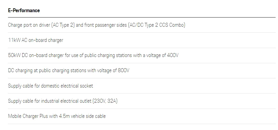

So solution very simple - 32A separately fused supply from your fuse box and terminated in a receptacle for the supplied 'supply cable for industrial electrical outlet (230V, 32A)'. You will also get an additional supply cable for a standard UK domestic 3 pin socket (13A) but only use this when in dire need or when on holiday and there is no charging nearby. 13A charging will take days so therefore use only in times of need.
Extract from std spec of your car:
Porsche Taycan In home Grizzl-E Level 2 charger? 1641835546921
Give the prospect of providing some weather protection due consideration if only for piece of mind. The PMC+ will sort of fit (intended for PMCC but depth dimensions are less in PMC+ and so will sit recessed) in the Porsche Dock but if you get to that stage you may want to consider an EVSE with greater than an IP55 rating (could get pricey):

@targaben - apologies - I thought you were US based!
