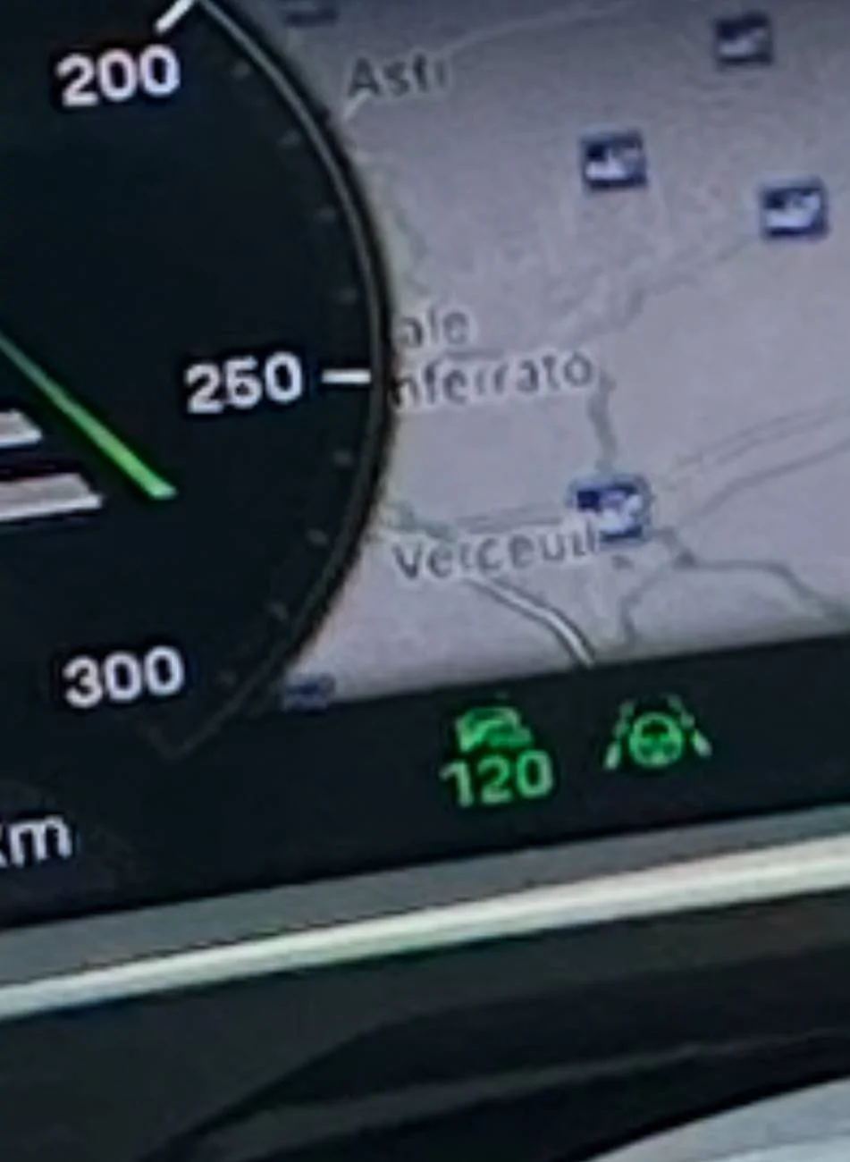

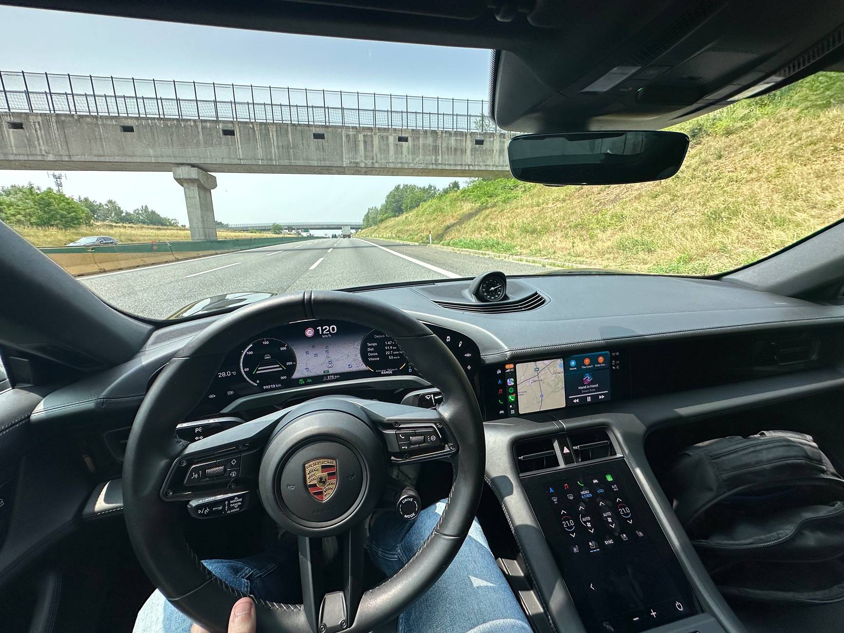

files attached : me driving very happy con PiD activated (you need to zoom a lot)
And the icon with the car and the PID (the old one I’m still on 3882)

A zoom on the picture that….unfortunately, I did not take to have a proof of PID activated…

The thing is, I bought this car because I wanted InnoDrive. I have (alas!!) no proof that it was listed on the porsche finder but this photo of me driving with InnoDrive, I'm flabbergasted by the fact that Porsche is selling me a car with an option listed on their website that I must PAY when I'm out of the garage....

The thing is, I know I saw it in the grey part of the equipment list "in evidenza" because that's the first thing I looked with the technician that told me how to operate it (and so I was able to activate it as seen on the photo).

Just trying to figure out what we are talking about here. What your dashboard is showing is Adaptive Cruise Control and Active Lane Keep. But my understanding was that Innodrive was an additional layer you could pay to activate that combined in the road sign detection (showing the speed limit next to your speed) and the mapping to adjust the car speed to the road (junctions, roundabouts, bends etc) and to the local speed limit. Not sure whether you are talking about that or the ACC and ALK. If its the latter if you look underneath the numberplate there should be a central black panel with a large circular insert where the distance keeping sensor is fitted. If its there you have ACC and ALK and if not you don’t.
