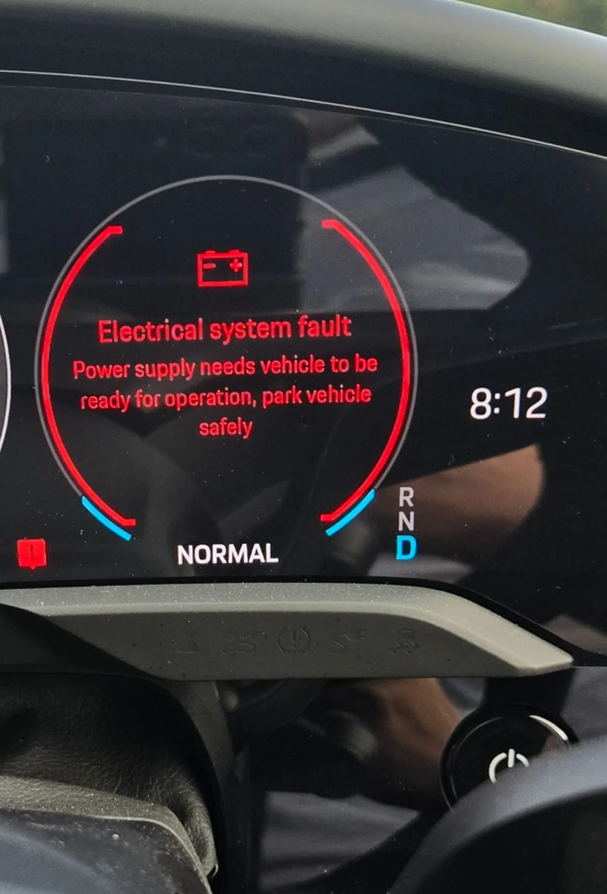

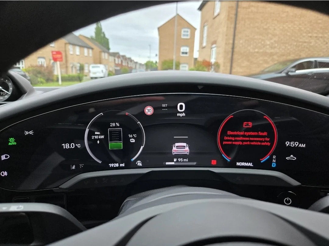

"Power supply needs vehicle to be ready for operation, ....".
WTH does that phrase even mean?
Is it supposed to be 'vehicle needs power supply'?
Incompetent.
Exactly, I haven't got a clue!
I have 5 photos taken on separate occasions (out of the 11+ events) and the messages are jargon.
Post update last june, the message wording changed slightly.
Porsche Taycan Intermittent red warning J1.2 Screenshot_20250915_170659_Photos
Porsche Taycan Intermittent red warning J1.2 Screenshot_20250915_170823_Gallery
788
4,705
3,814
"Driving readiness necessary for power supply, ..."
Well, that clears it up. :facepalm:
Perhaps the red warning message means: "The power button must be pressed to operate the car"?
