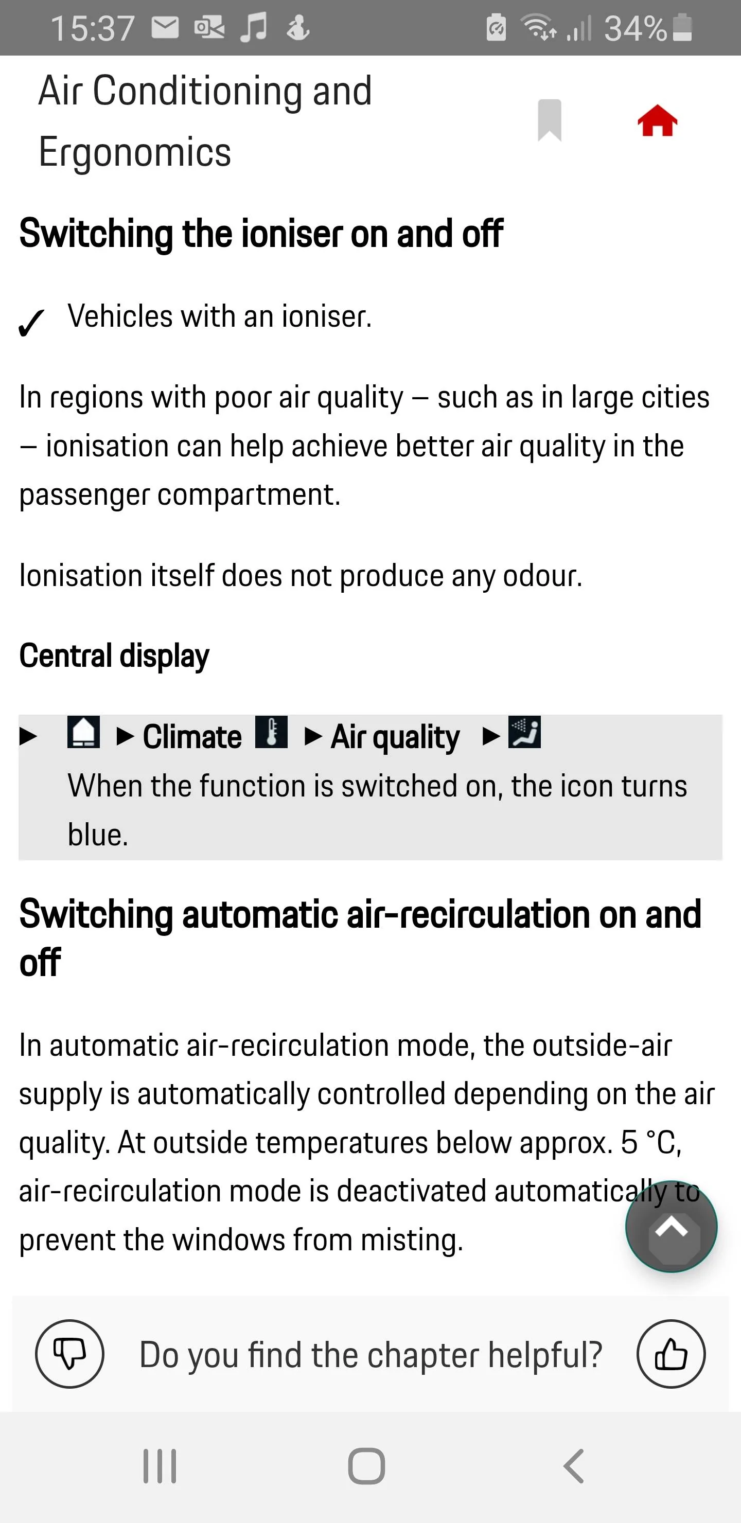

Ok, I didn’t realize you could use the diamond buttons. I’ll set it up today. Simple answer.
I have one as front camera and the other as ionize. I’m not even sure what ionize does or how to know when it’s on. I don’t see an icon come up, when I press it on any screen.
thanks!
11,063
6,846
Ip
thanks!
Ioniser when on displays an icon of a face with a spray in the same area of the screen where you see your LTE connection etc.
