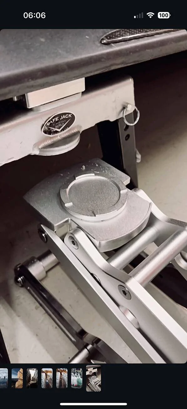

Anyone figured out how to jack the car and then put on stands? Thanks
That's where the SafeJack jack stands come into play. There's really no place to put traditional jack stands underneath the car while the jack is taking up the only official jack point. With the SafeJack stands, they basically rest on your jack and then you jack up the car with them on the jack. Once you are high enough, you complete the SafeJack by putting the legs and pins on and then you can remove the jack. The SafeJack is also good because it has pins in the top bar which guarantees that your jack point adapter will not slip off the SafeJack.
Porsche Taycan Jack stands? IMG_9613

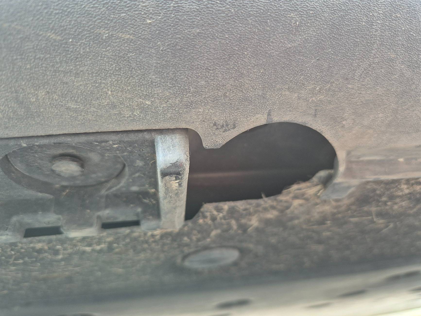

I have found this holes under on both side near the jack points. Is this normal?
Porsche Taycan Jack stands? 20250327_132520
