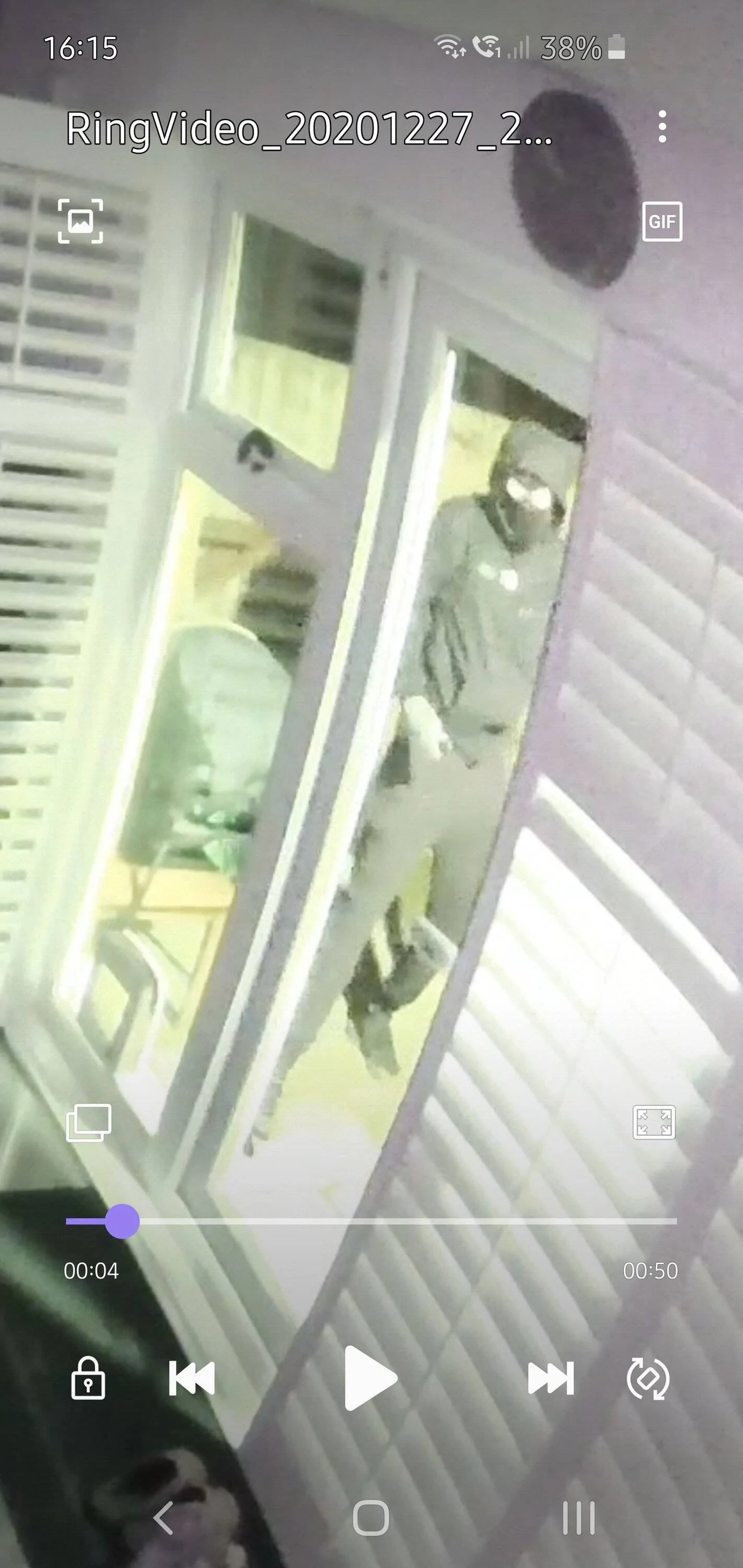

We extended the system, when the kitchen camera caught this w@nker a couple of years back.
He actually ran off when he saw the lights on the Ring camera recording him. I legged after him, but he was gone.
He got caught shortly after though.
