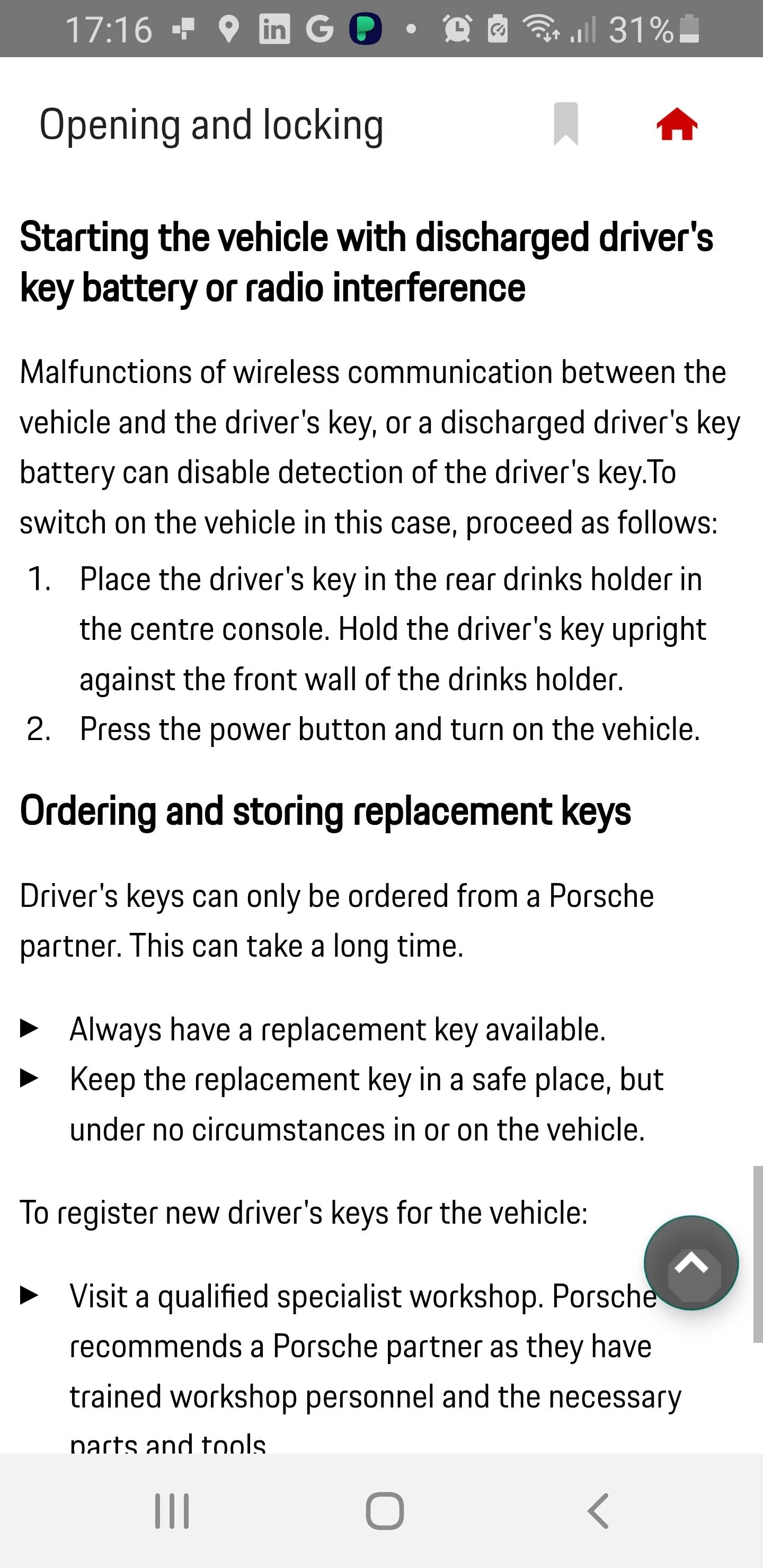

I’ve tried both cup holders usually works better with the one furthest away. Honestly this level of micromanagement of the key to achieve functionality is not acceptable for this level of car!! As I mentioned this was not the case when I bought the car so something has happened to cause this poor functionality after the first year and a half.
11,114
6,882
Yep, farthest one.
Could be a transponder fault.

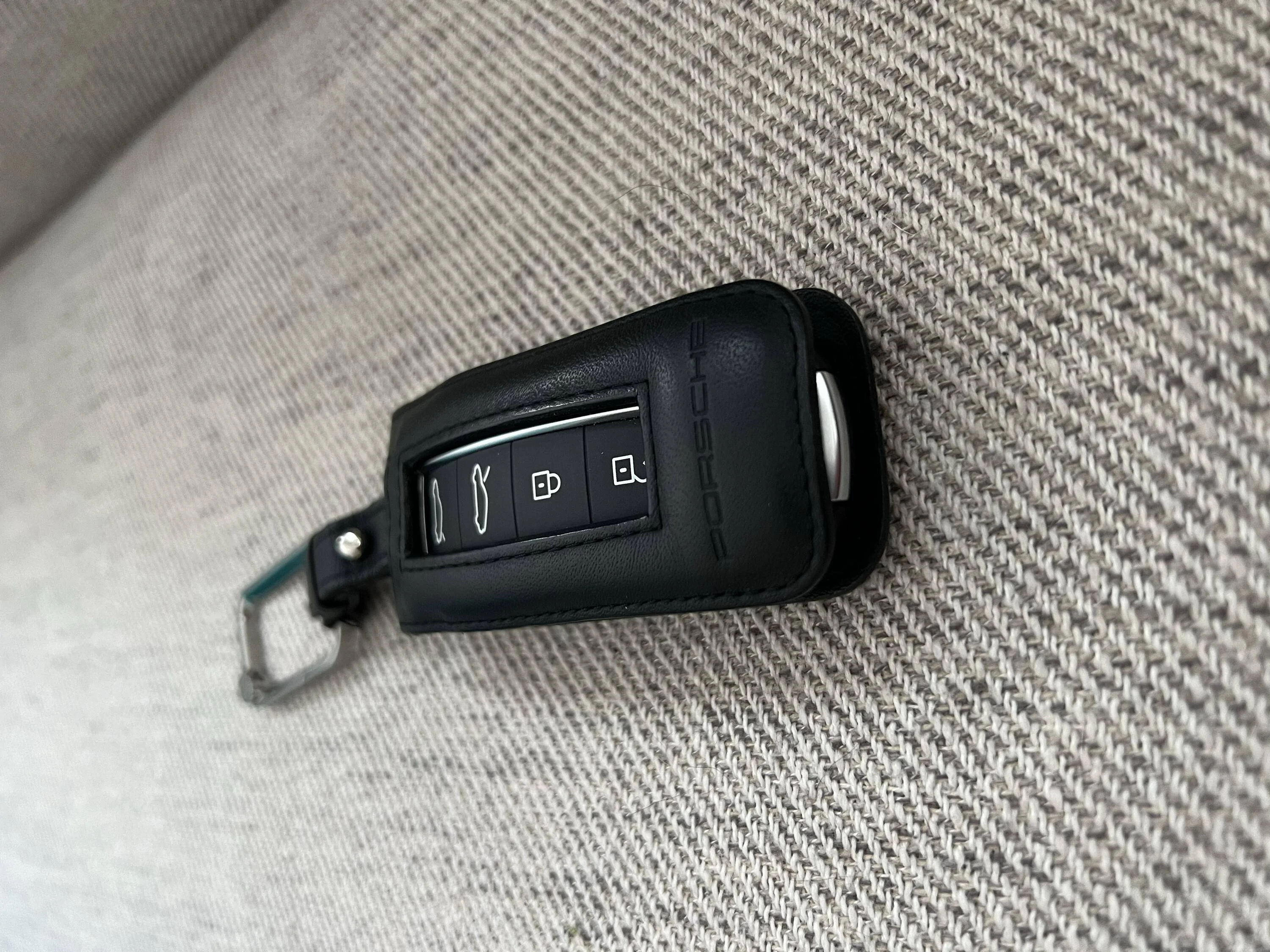

Do you have a cover on the fob? I did and after removing the aftermarket cover, the frequency of these errors have gone down dramatically.

I suspect you are right and transponder is likely to be the issue.
The key fob holder is Porsche's own fob holder.
