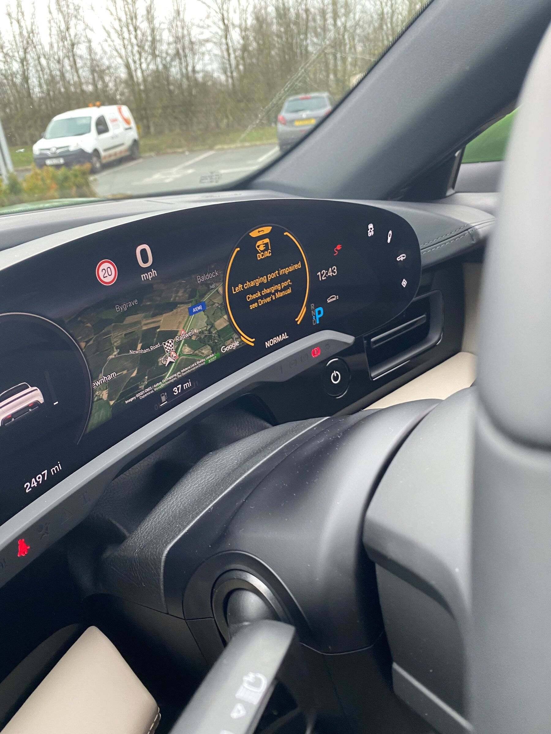

Consequently I’m collecting frequent flyer miles at IONITY at Baldock. Of late I keep getting the above warning when I try to connect. It’s a bit of a heart-stopper and, in desperation, I tried a PCM reboot (no, I don’t know why I thought it might work) which seemed to do the trick.
Did this message appear just after you had plugged in?
Did you also hve the red light come on in the charge port?
And was there any message on the display of the Ionity charger at all?

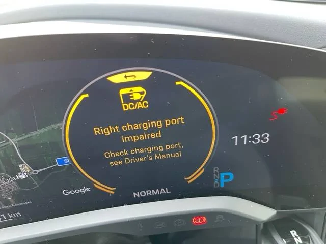

I have charged at least 50 times if not more at HPC stations, Ionity Allego, EnBW, etc, without big problems. However I recently had a not so good experience

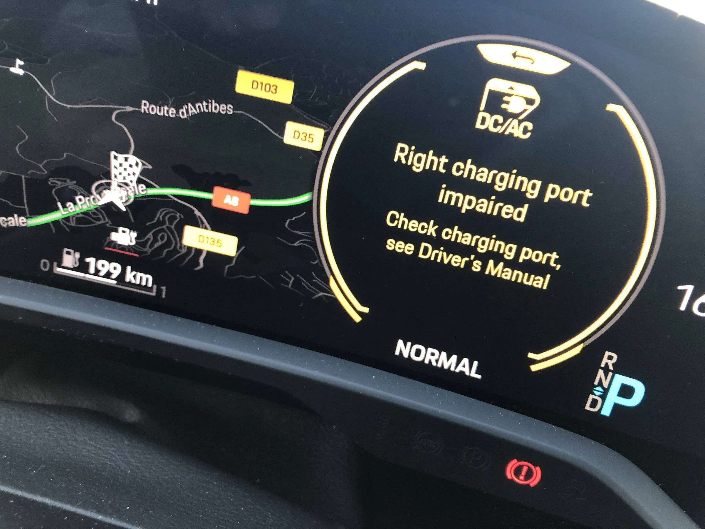

Look at my car given the same message when plugging in to an Ionity station outside of Cannes.

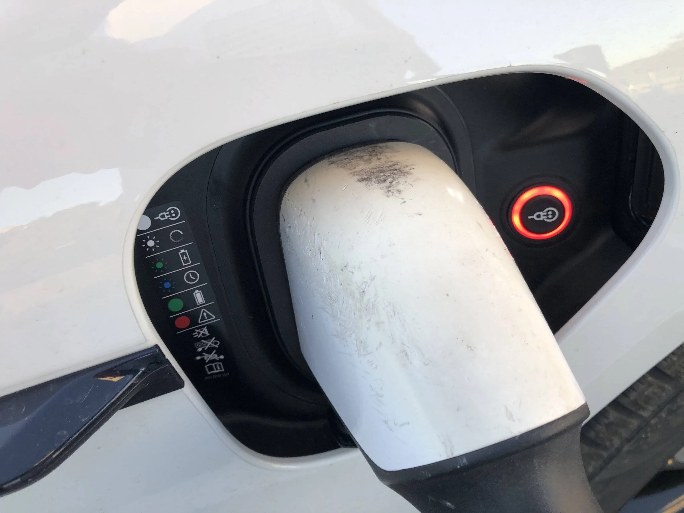

This happened to me after collecting my car from the Porsche garage to repair my faulty Innodrive and LTE connection errors. Slightly panicking at first. But I decided to unplug and start all over again few attempts.

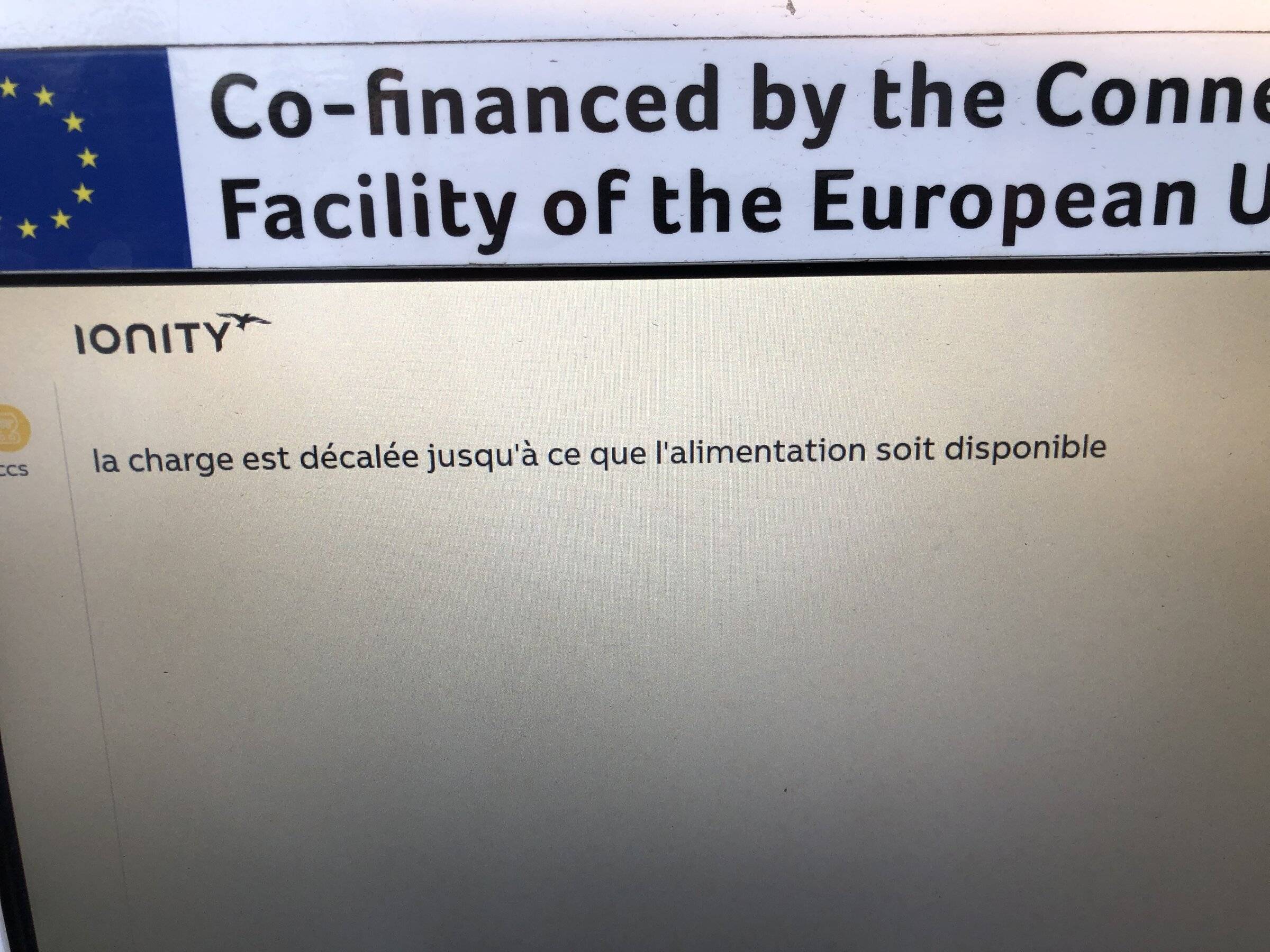

After the third try I decided to call Ionity and noticed a message on the charging station.
Porsche Taycan Left Charge Port Impaired. E16F1551-2357-430A-B9DC-1C3B00DDD3A7
That message seems to indicate that there was a problem with the charger and the available power at the station. A Jaguar i-pace arrived and plugged in successfully afterwards.
In the call with Ionity they suspected a faulty communication between my car and the station and we proceeded to try again with me pushing and holding the charge cable securely to the car after the agent had rebooted the charger. Then everything worked, but I noticed that the power delivery was much lower than my earlier stops at this station with similar SOC and weather. The battery was also preheated to about 30 C. So perhaps there was just a La k of power available at the time and some communication glitch between the car and station.
