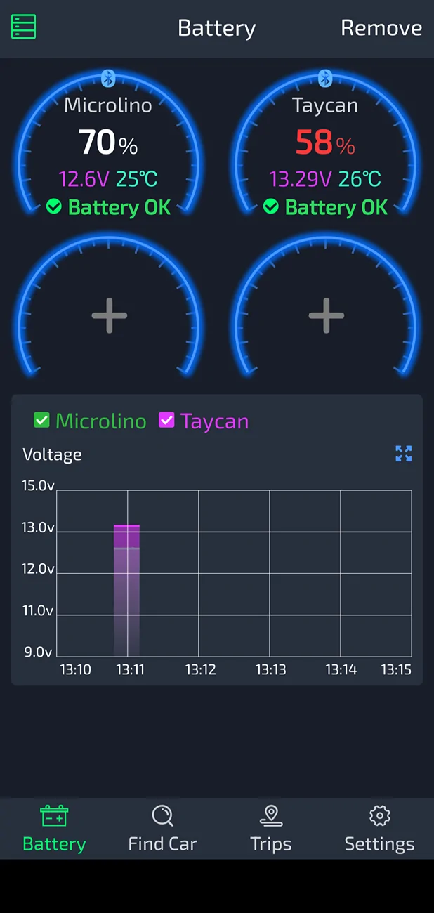

... absolutely nothing happened. Fired right up.
Car was plugged into a wallbox via the normal charge port, nothing else was done.
