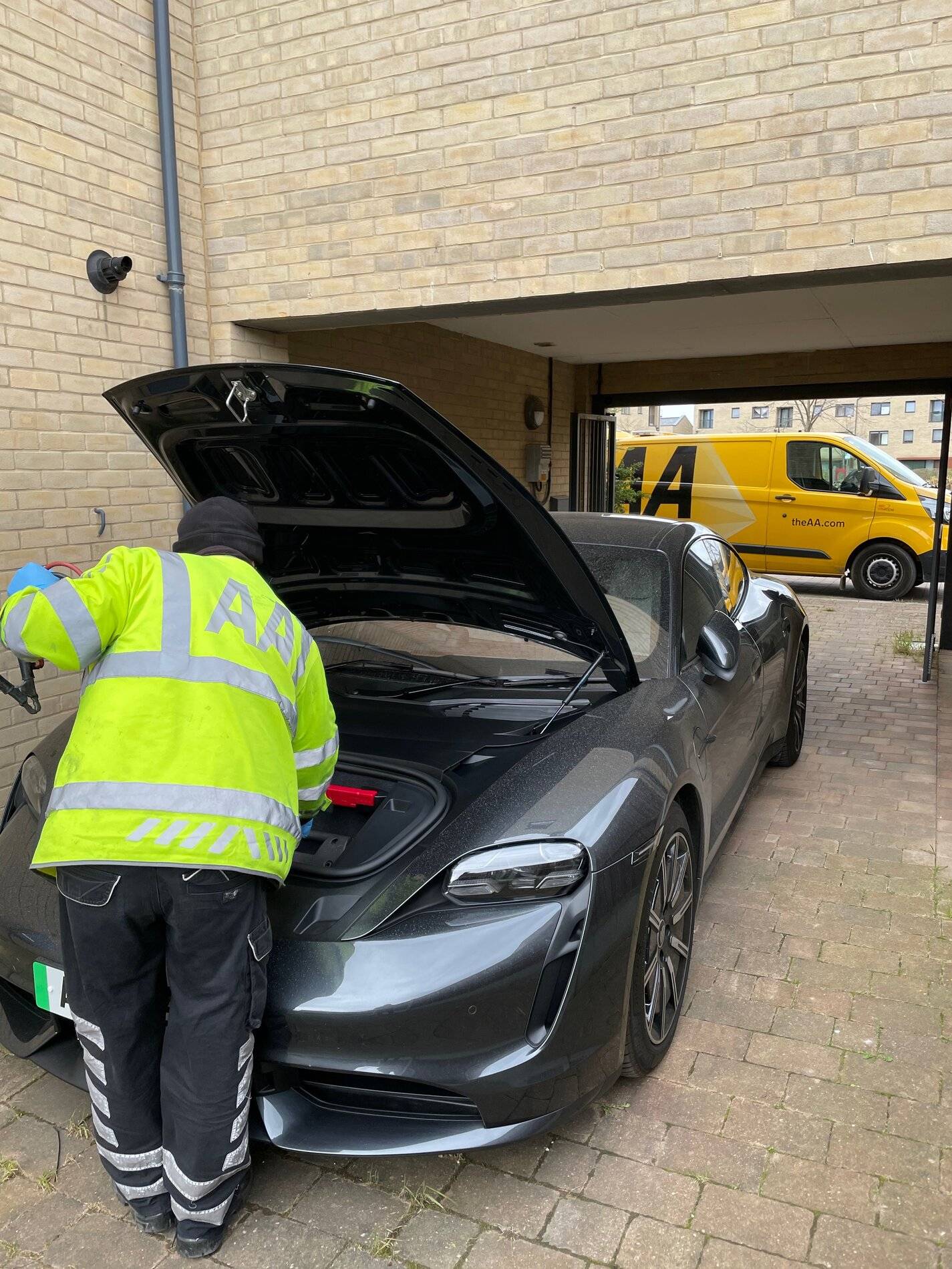

I’m currently dealing with this same issue - the Cambridge curse?
I went in with my eyes wide open from all the reporting on this forum, but just like those that do not understand how odds work when they buy a lottery ticket, I failed to ignore the odds of these negatives happening to me. This is now the second major issue we’ve had with the car and we’ve only had it two weeks and traveled 354 miles. Even on Saturday an alert showed up on the dashboard saying “Emergency Stop function not available. Temporary condition, driving permitted”.
We drove 7 miles yesterday, parked it over night and this morning the alarm went off. Vodafone said this was because it lost connection, which seems to fit with all the 12V issues, as now the Connect app doesn’t even show the battery. Now it’s completely dead, with no response to either key. At least the alarm stopped though.
AA were here within 45 minutes and, fortunately, we had your guide to follow to help us get into the car. Now it’s back to life but the wing mirrors won‘t come out, so will likely need Porsche Cambridge to come and collect it tomorrow once they’ve opened.

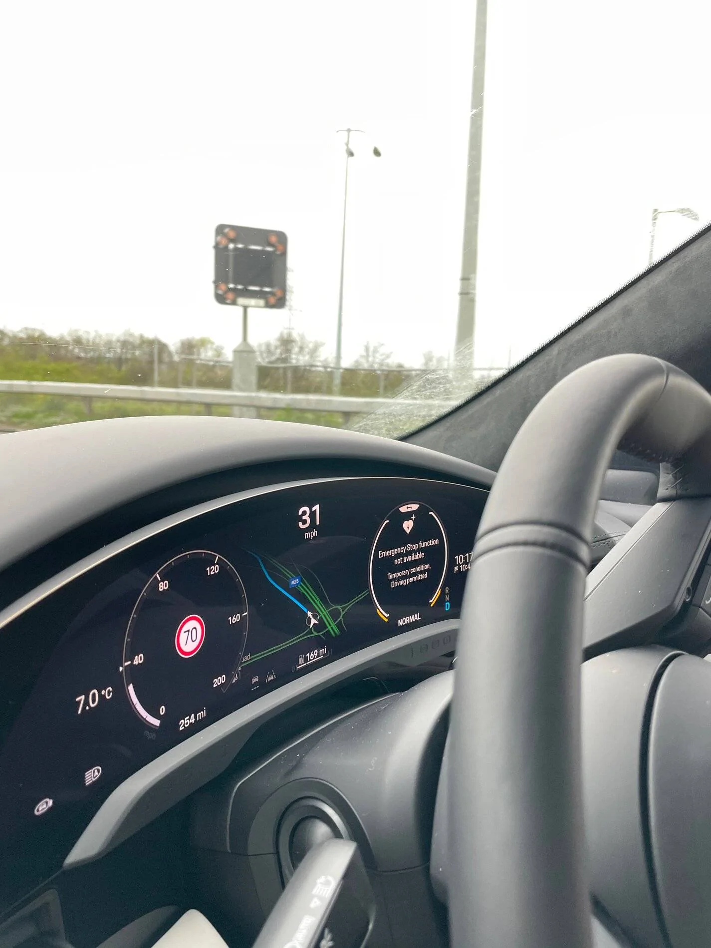

The other issue you had was probably a false positive from one of the sensors (moisture / dust potentially).
Thanks, Adrian - that fixed the mirrors. They won't go back in afterwards, but it's enough to at least drive it over to Porsche Cambridge tomorrow.
You're probably right on the notice/warning, but when you're a bit on edge as it's breaking down it's not something good to see. Here's a pic anyway, in case it helps anyone in future.
