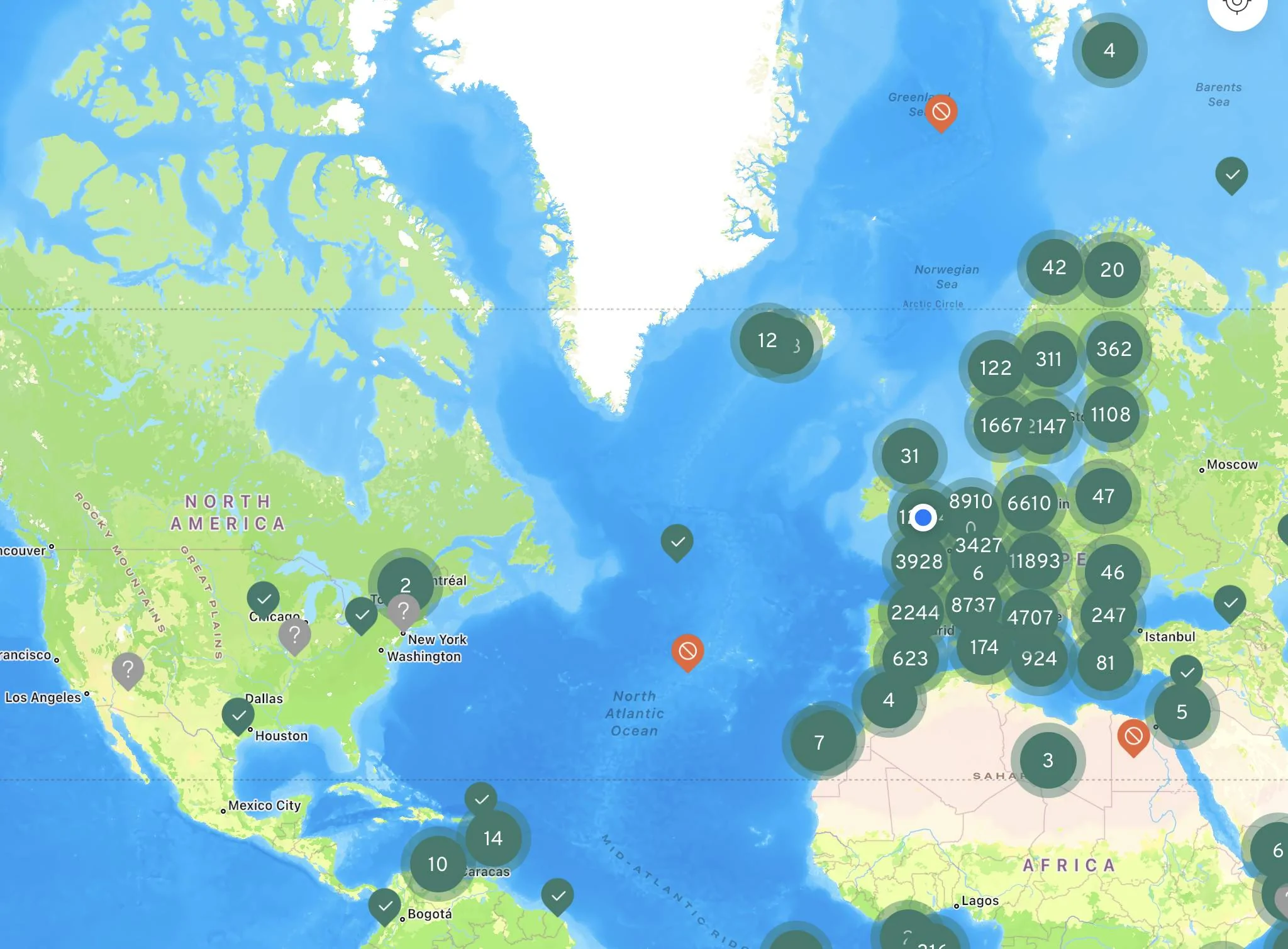

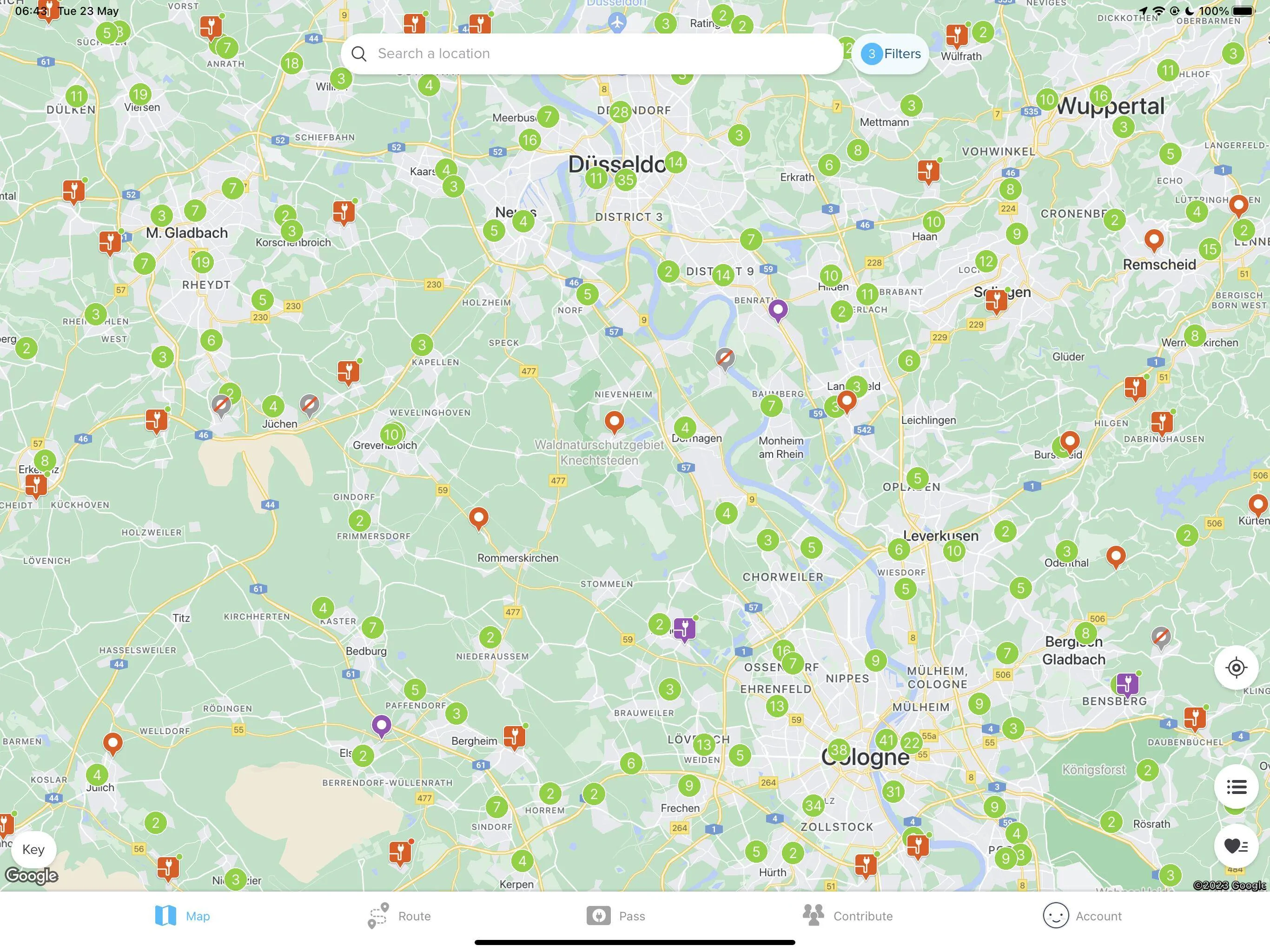

Here is a random bit of map from Chargemap, filtered on Type 2 socket >18kW, both the green and orange markers are 22kW. .
Porsche Taycan Long distance driving with AC charging only IMG_1159
but I see you are in Canada so either there are fewer there, or Chargemap doesn’t know about them:
