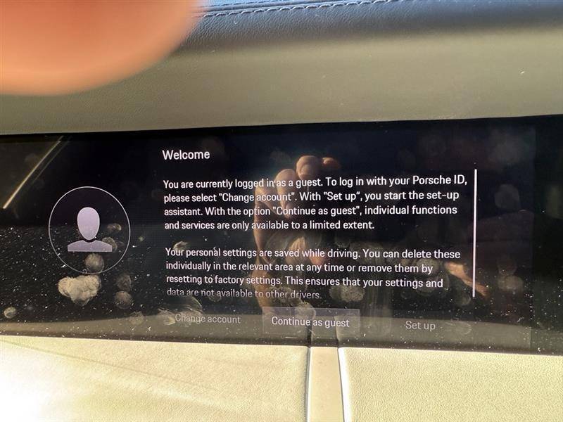

Had a PCM message asking me to log in as a guest this morning with the car not recognising my user profile.

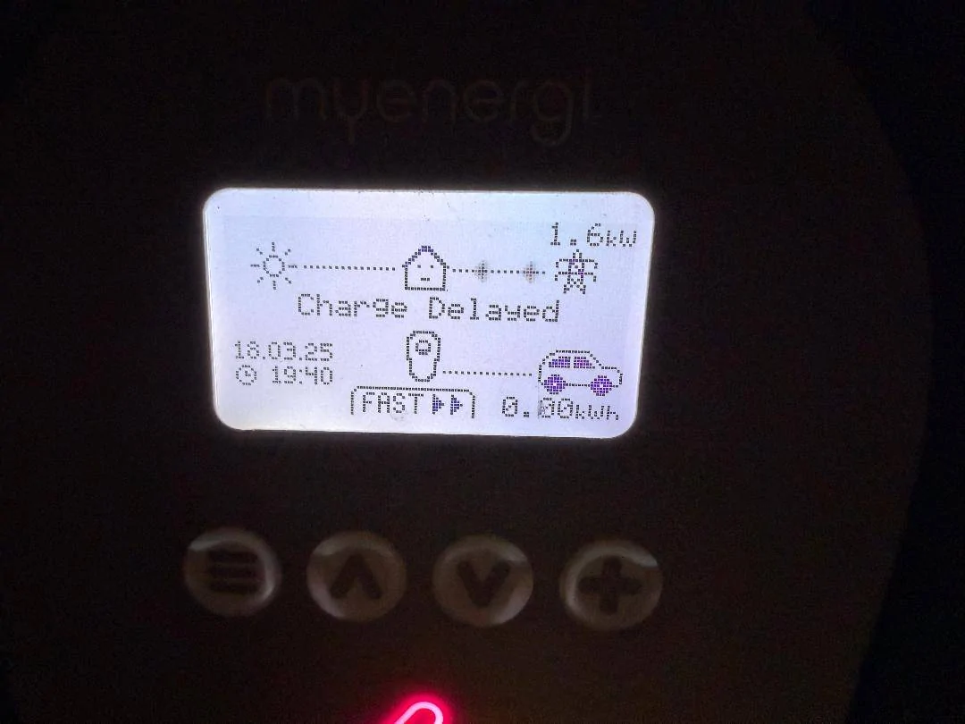

Currently the car is on my drive with 13m of charge and my charger is stating charge delayed after a ten second countdown with a message 'awaiting EV'

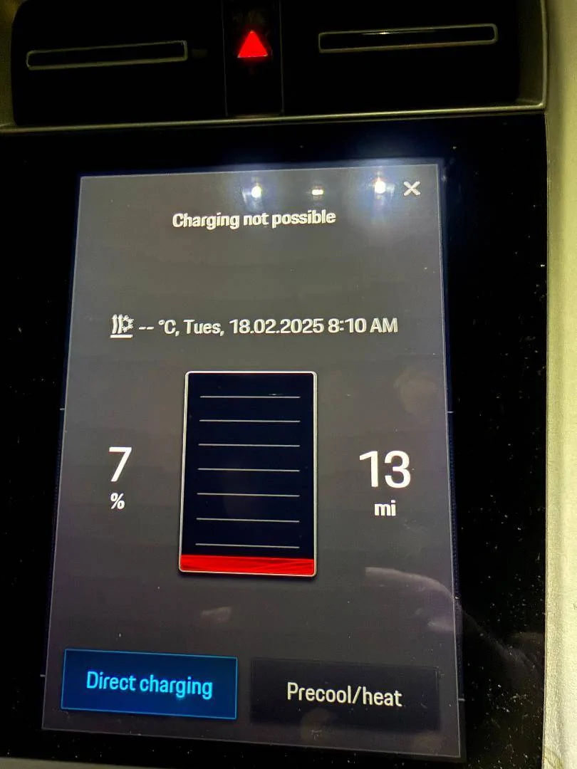

Car PCM states 'charging not possible' and this is the same on the phone app.

Porsche Taycan Loss of PCM profile Porsche PCM
Porsche Taycan Loss of PCM profile Porsche charge screen
Porsche Taycan Loss of PCM profile Zappi messag
Disable programming from the Octopus side so that it is effectively in 'dumb' mode, enable Direct Charge to bypass any PCM profile / timer.

Thanks both.
I didn't think to try this as the charger has an override to allow immediate charging outside of the programmed hours and with minimal charge I'd tried this without success.
Later in the evening I shutdown / disconnected everything and reconnected. By this time the profile issue had been resolved and my profile loaded to the car when I turned it on and I was able to charge in the normal way.
