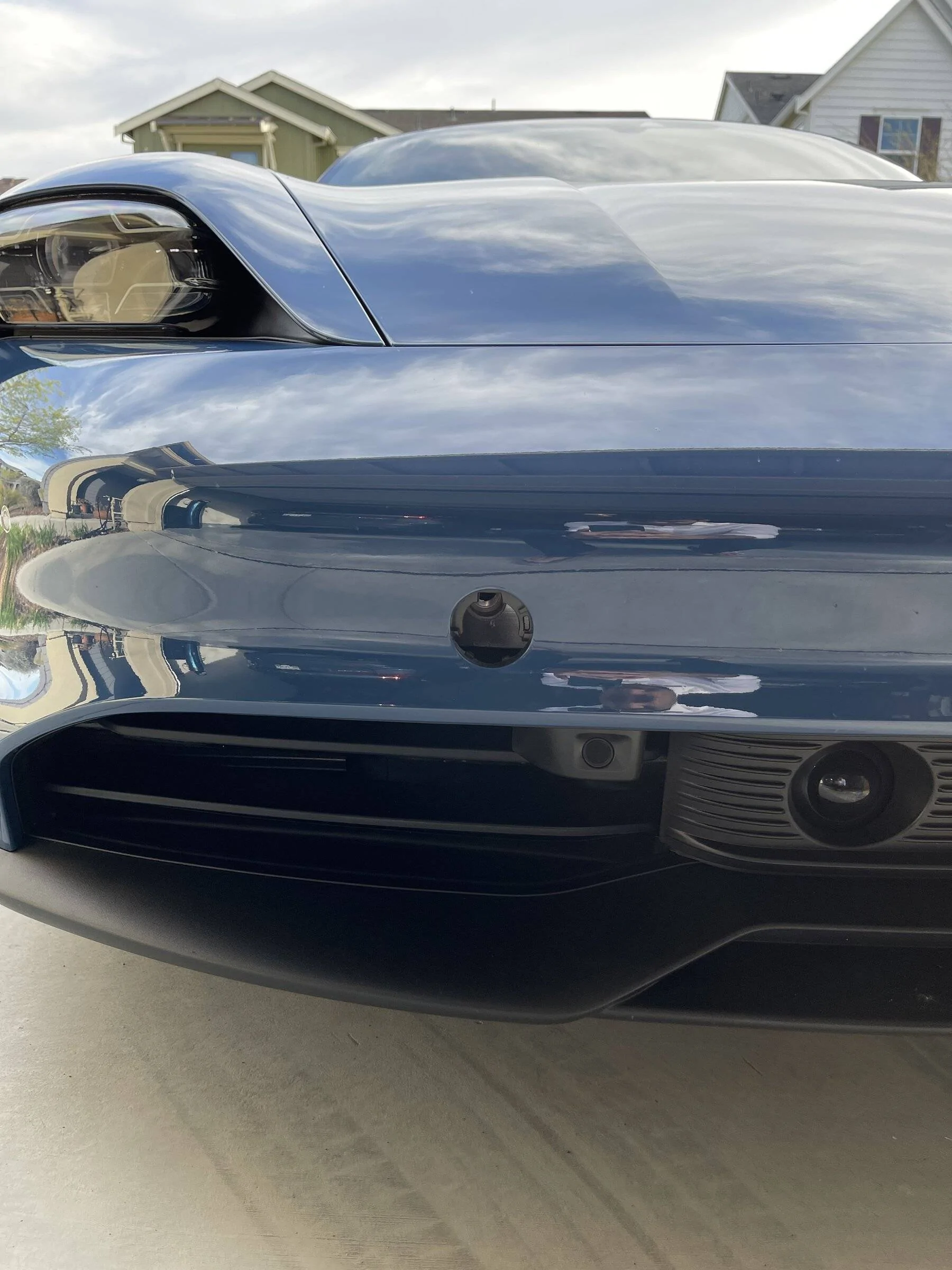

Recently I got front ppf done. Likely as part of the process they didn’t install this circular cover properly. Today I found that it came off when driving - don’t know where. Does anyone know what are my options - can I buy a replacement part? What is it called?

That's a tow hook cover.
9J1.807.155.A
Painting is what's going to get you. If you don't care very much, just get one off of ebay and tack it on.

Thanks for the feedback .. I figured about the paint :(

Check with Eric at bumperplugs.com to see if he can paint the tow hook cover to the appropriate spec. They do a great job at factory color matching.

BTW that part is supposed to have a little "safety cord" attached so even when it's not plugged in it can't be lost.

I would take this to the dealer for a warranty claim. This should not have come off. They remove these covers to tie down the cars on the RoRo vehicle carrier and likely they damaged this one then.
