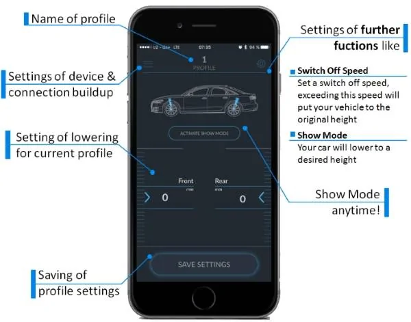

I have the CETE module which includes a "show mode" that allows you to lower the car with your mobile device (iPhone) for me once it is parked.
I have found for me, that even when you are in the "low" setting, if you back into your parking place, the car raises to "normal" once in reverse.
Since I always back into my space, I will just drop the car with my module when I want.
The module also lets me set the ride heights in each mode to water height I want and those can be adjusted with the factory controls in the car (steering wheel knob, or settings in the infotainment).
So this is not a piece of hardware but rather some sort of chip? How difficult was installation? Thx!

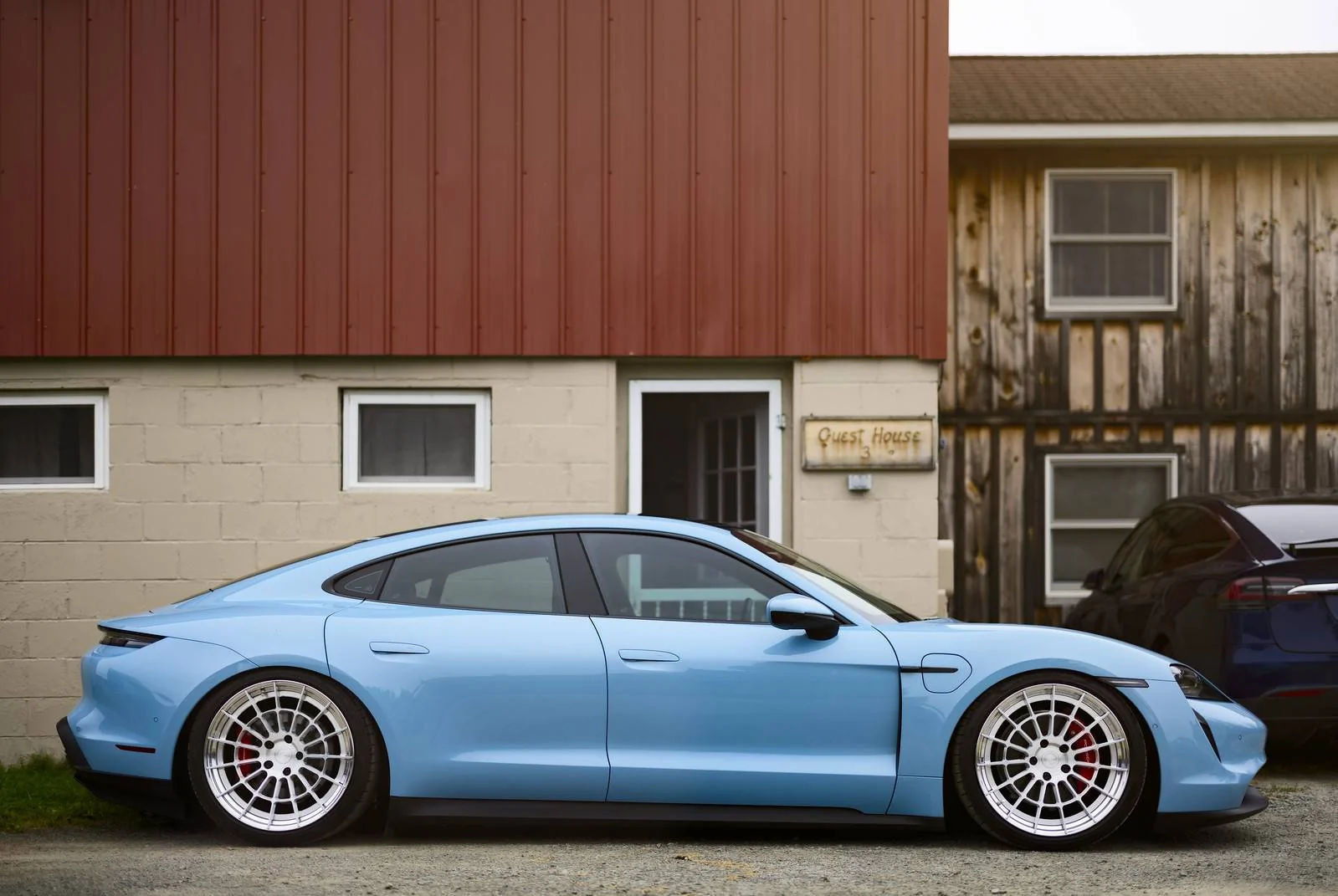

How easy is the installation of the lowering links? Can you do it at home?
Absolutely - the main thing to be careful with is the sensors that are close to where the link caps snap on - there are a couple of (not so great TBH) install vids online - I think Vivid also has one for their links too.
Rkvet27
Ratul
Jul 3, 2021
Southern California
Taycan 4s
For ref a number of forum users have lowered their rides with FVD, Vivid and other make 'Lowering Links' (which are easily installed and easily removable) and have reported essentially no diff. in ride quality.
I ordered the FVD links but won't get the car 'til EOY or early '22 so cannot personally report on that. I did however see a local Taycan in person lowered and looks superb - SO much better and I'm not talking 'slammed' but more akin to a proper sporting stance. Once installed you of course still have access to the various heights and lift just with each setting slightly lower based on the value used installing the links.

Interesting module - was not aware of this and thx for sharing - way more expensive option at base price of $1500.00 (for the Taycan) and presumably another $200-500 for install?
So if I am reading this correctly the CETE module can override the setting for each std. drive mode in the car (how is this different to simply setting up an Individual Mode setting?).
More specifically will this module allow you to lower the car beyond the factory low setting (say another 0.5 to 1.0 inches)? The links I mention above that cost from $200-300 basically "fool" the sensors on the suspension into thinking the car is higher than it actually is and hence lowers the car anywhere from 0.1 to 2 inches lower (if desired) than the factory setting. How does the CETE unit fool these sensors or does it simply override them somehow (clearly I am not an expert :)! )?
UPDATE:
I was on the TAGmtorsports site - found this description for a Macan install on another site (Flat 6) that maybe answers my question re ability to lower it lower than factory setting (text in bold below). Fairly simple install so a def DIY option:
QUOTE:
With the free smartphone app further functions are available:
  • Total control - You are still able to control your air suspension via the Audi MMI.
  • Porsche Drive Select - You are able to set up each original Carprofilewith individual values. This means that you can set up following profiles with its own lowered or raised values:
    • Normal Level
    • Sport Level
    • Sport+ Level
    • Terrain Level (Offroad Mode)
    • Original Low level Switch
    • The original Low level switch can still be used to lower the car by further 10-15mm.
  • Switch Off Speed - With the help of our app you are able to set a speed limit. Exceeding this speed will put your vehicle to the original height.
  • Show Mode - You are on a tuning meeting and want the car have a particularly depth? Just check out the Show Mode and your vehicle goes downwards as desired.
  • Exact adjustment - Did you notice that you air suspension is slightly misaligned? Often you can’t realize this until it’s lowered a lot. If this is the case your car wasn’t calibrate perfectly. In order to fix this we developed a function within the app. It can be evened up.
An option for people who like it the extreme way: You can choose to use an extension kit for venting the air suspension completely while it’s in Show Mode.
Resources
I had a CETE module on my Audi. It's the way to do it. The install was super easy on that and only took about an hour. The amount of customization options CETE gives you is what made it worth it to me. Plus aired out the car looked great. When my 2022 arrives it will be the way I'm going.

I ended up installing the FVD links. Very happy with it. I think it even improved the ride in the middle suspension setting which I use the most.
