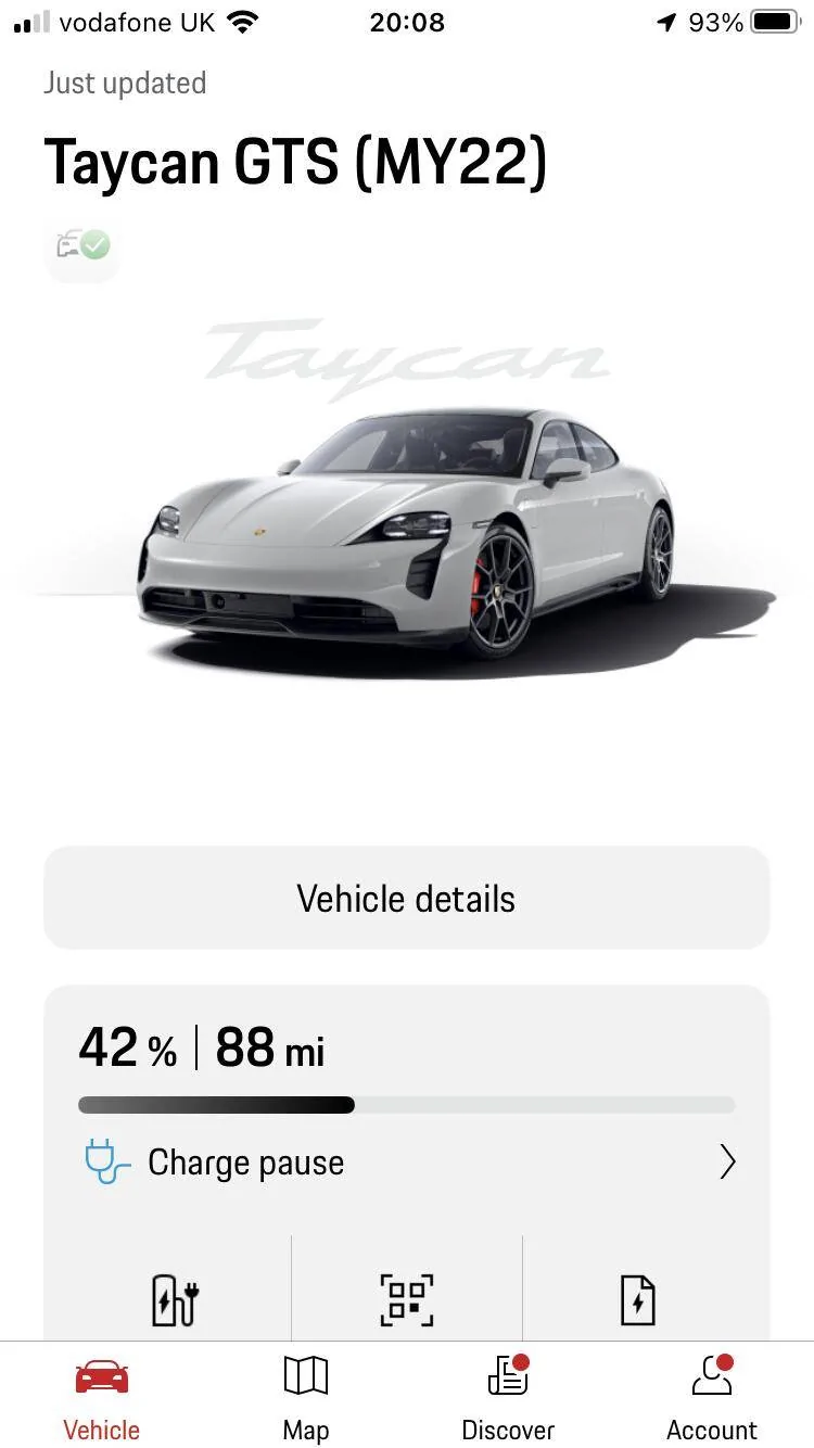

To follow on from previous posts my battery % 40 and range 88 was the result of the guessometer after a real cruise.
I was heading to an Ionity and the car worked out I had enough range in RANGE but not in NORMAL
It was a cold morning and I was not plugged in so only did the 5 mins unlock preheat. I was in warm clothes and thick socks and a beanie!
I kept trying to put on the heater in ECO for a bit of heat but it kept flipping back to ECO PLUS
when % at destination (Ionity) dropped below 5%. I could tell the difference but I had the seat heat on 2 bar +2 back rest and the wheel on and I was 100% comfortable because of clothing and it made the difference between getting to Ionity which I knew was quiet and was the perfect distance/location and 30p per KW and faffing around somewhere else for 70p per slower KW.
Its worth being prepared for ECO PLUS stealth mode when its going to make life much easier.
