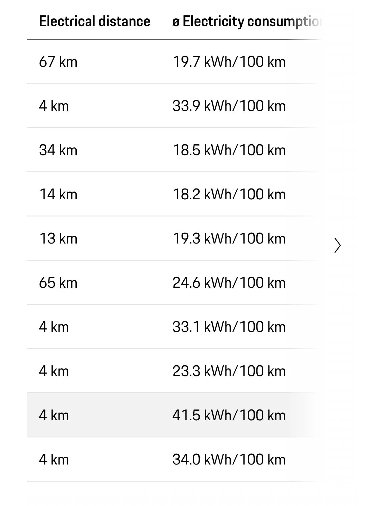

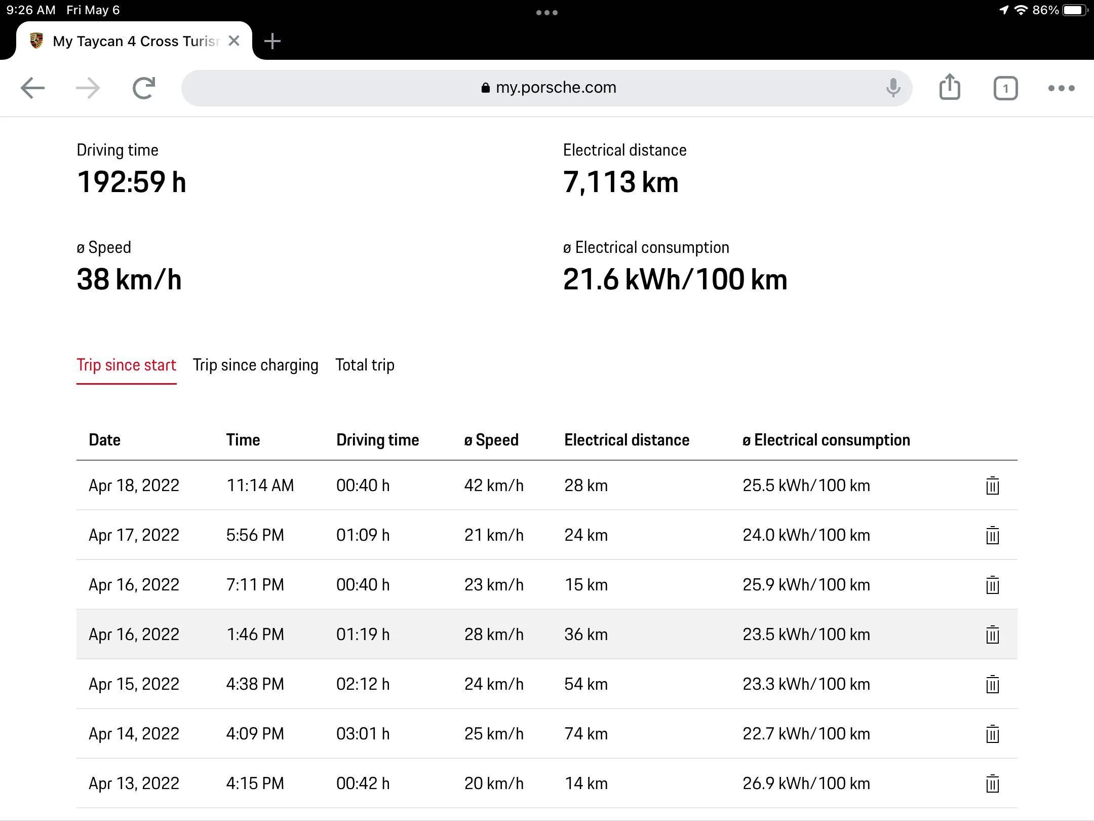

Based on what you have said, your power consumption seems quite high. Here is a screenshot from MyPorsche of a week of driving my CT4 on mostly local short trips on Vancouver Islan..similar weather and temps. When I first got my car back in Dec in winter weather I was getting power consumption 27-33kwh/100km. As time went on it has dropped around 23kwh/100km.
you can also monitor your consumption on the instrument cluster (right hand tube 3) ”Trip” display. Hope those numbers help you.

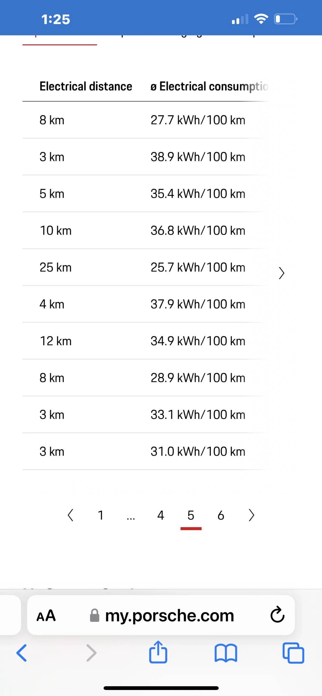

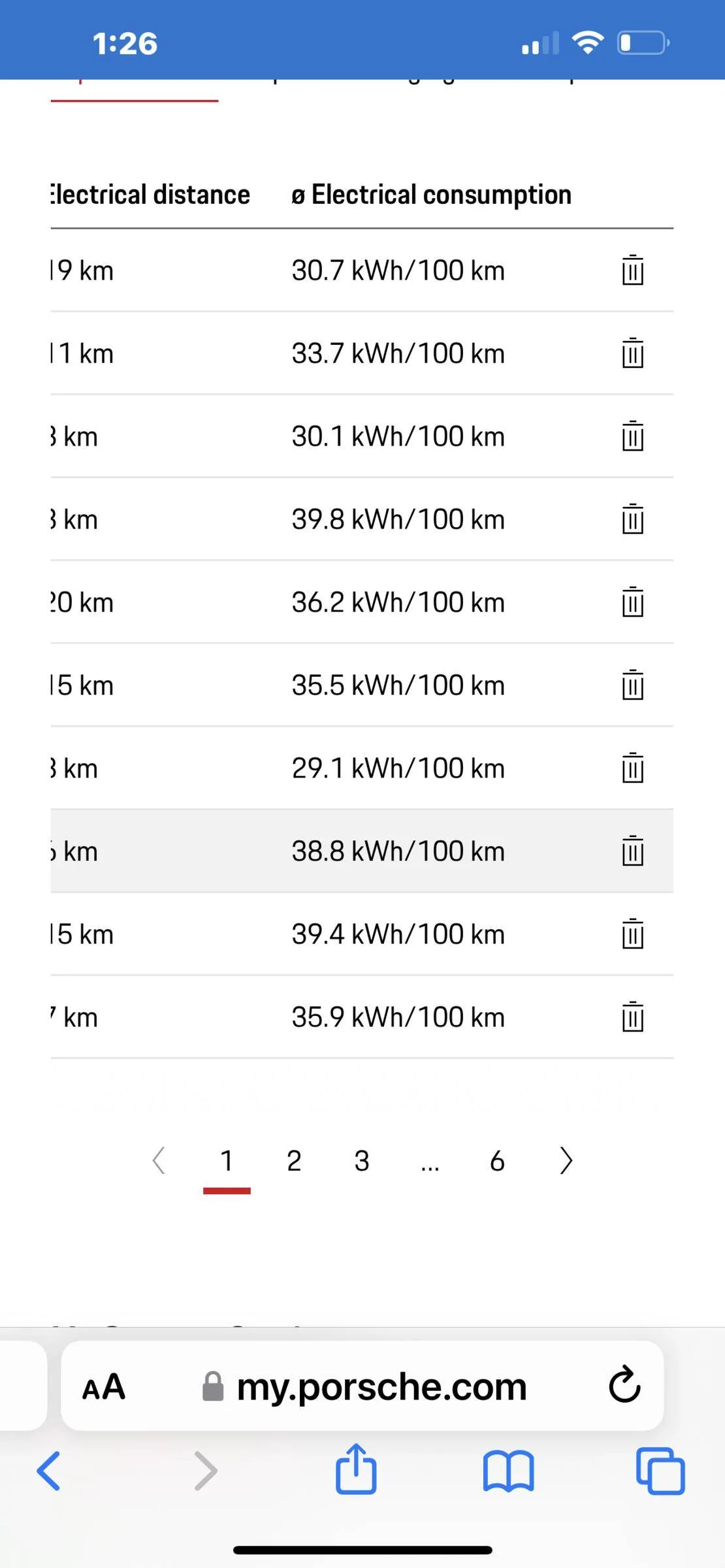

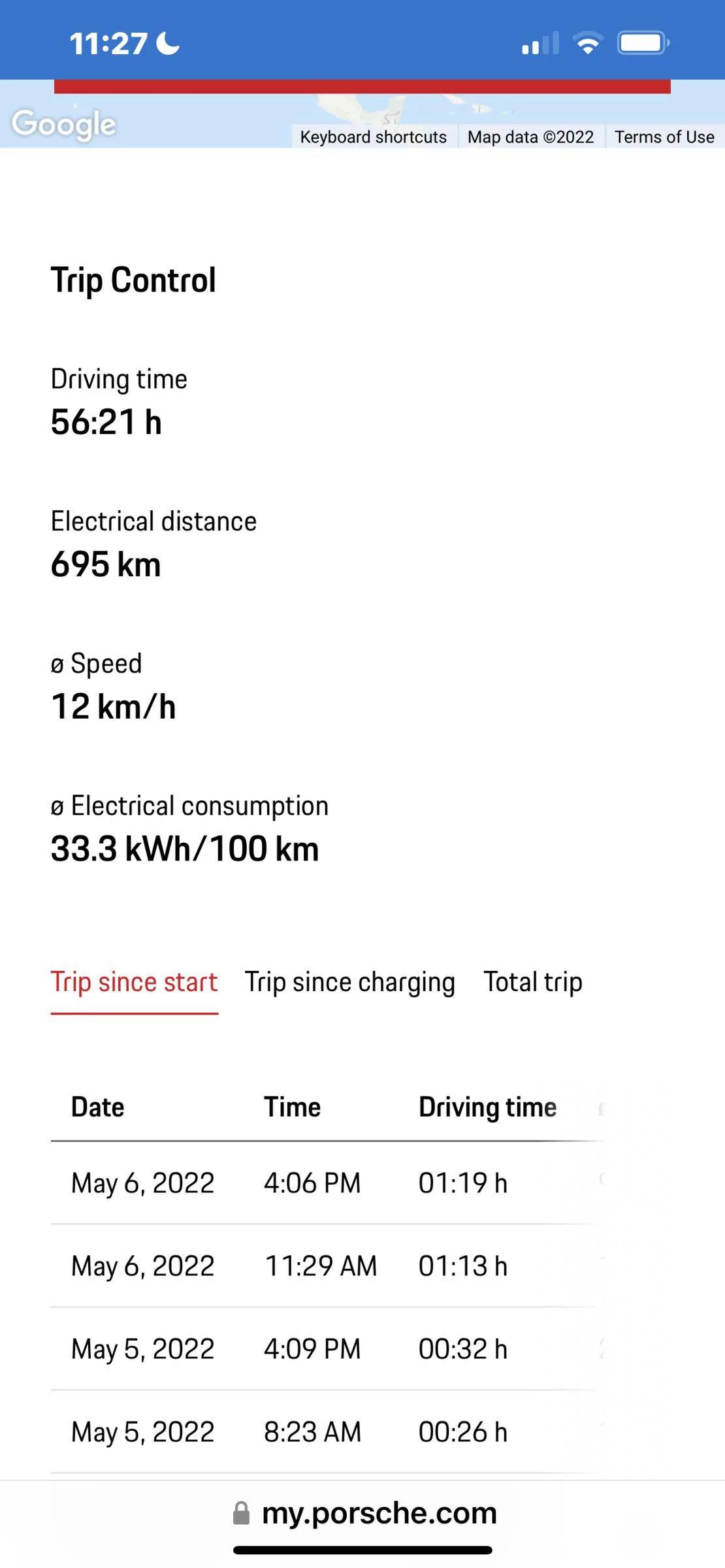

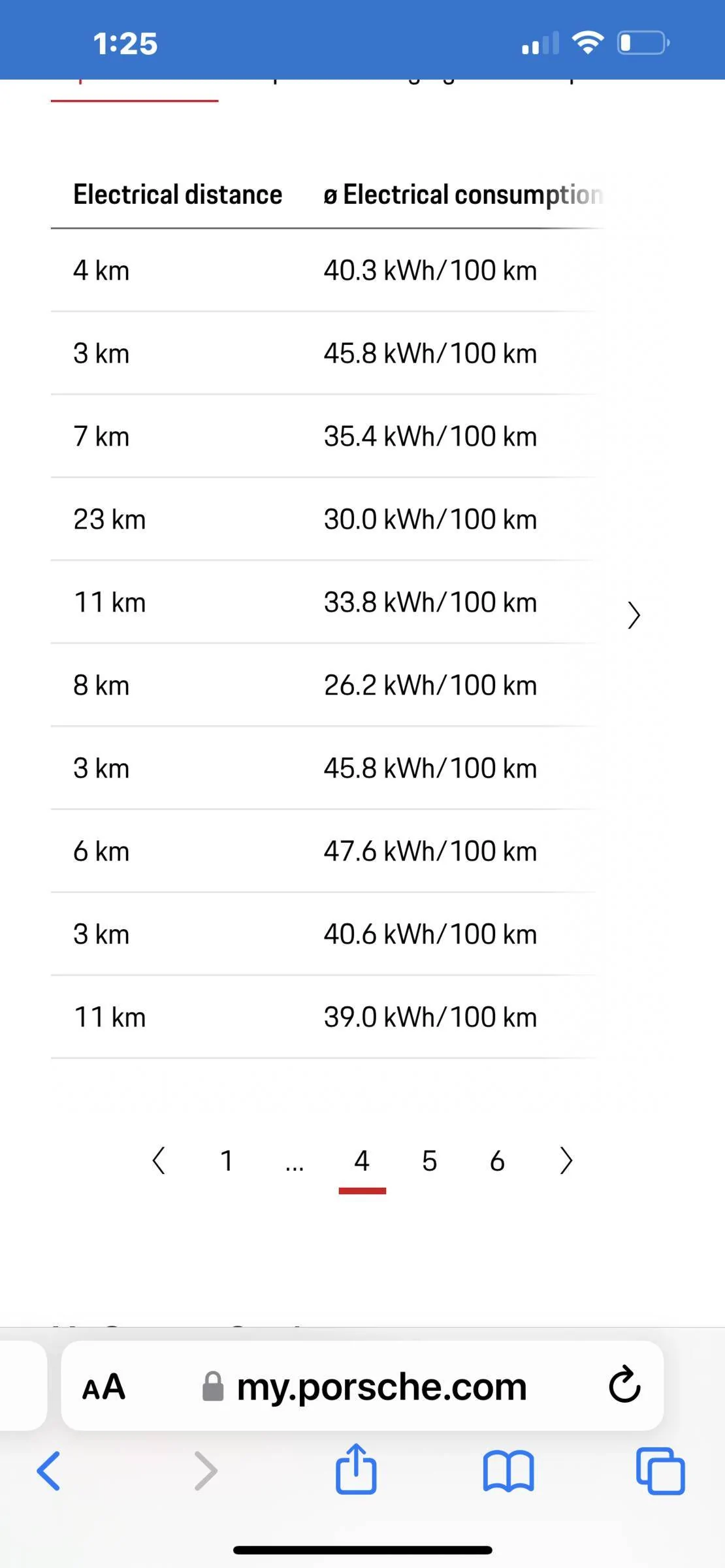

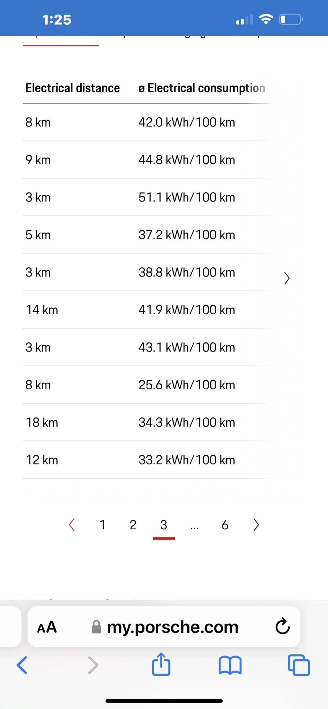

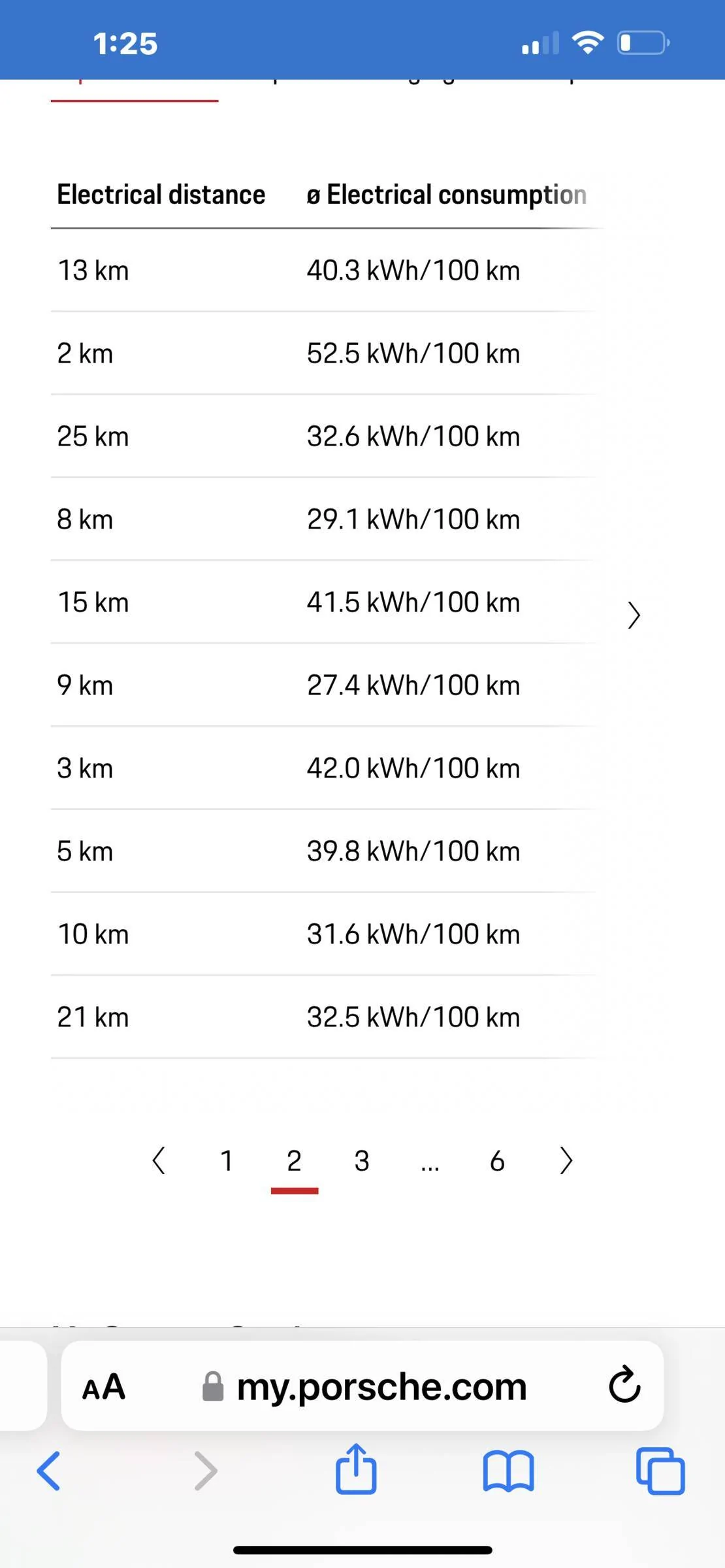

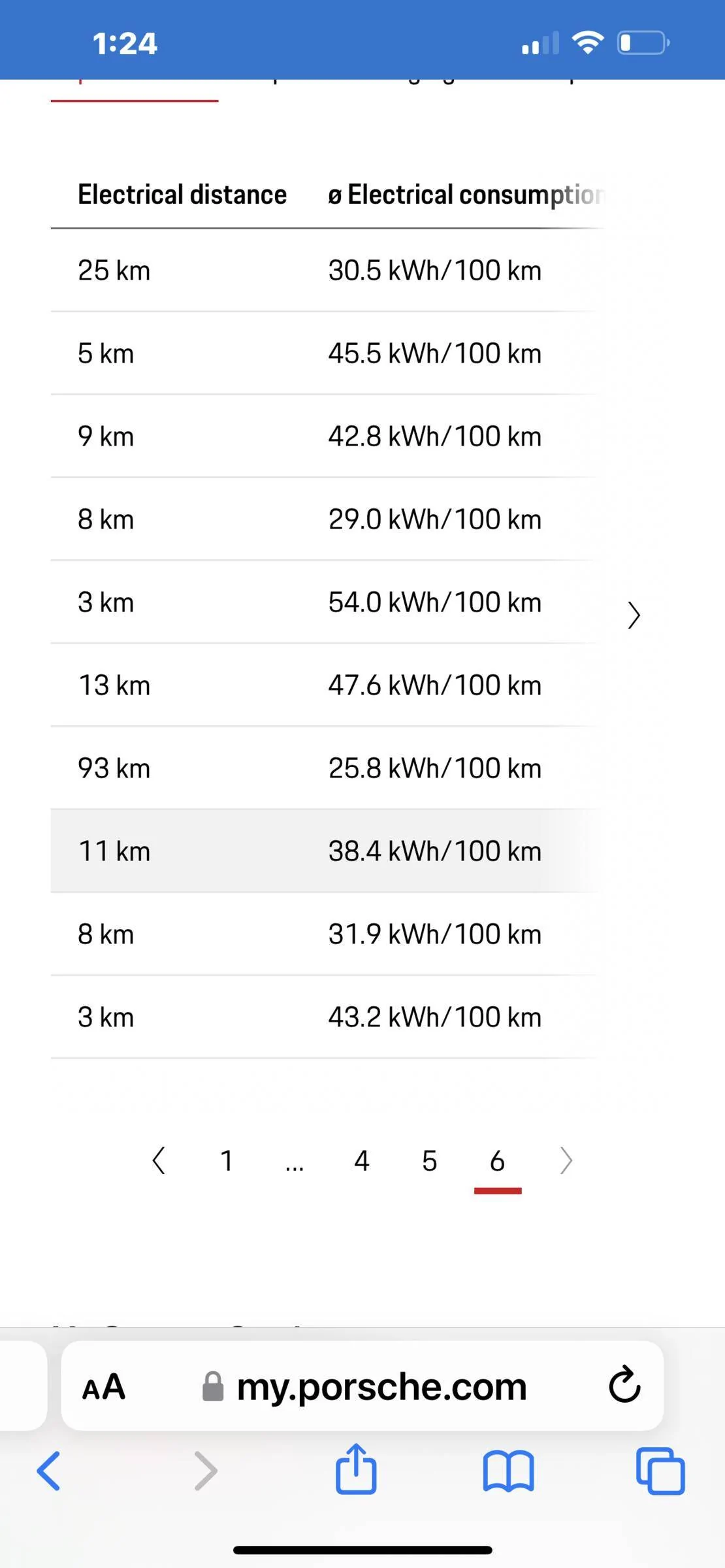

I could not find the same info as what you posted on the app but when I logged in online I found it all. I am posting the consumption since beginning
Porsche Taycan range/battery C29F50E9-D971-4180-9BE3-8797CB2A5AB2
Porsche Taycan range/battery F8FE4E6B-F388-4791-B142-A27580139060
Porsche Taycan range/battery F43C7298-E5DD-4B25-9B68-FC7515FB26D2
Porsche Taycan range/battery 4497B63E-C070-401B-9640-052A694486FC
Porsche Taycan range/battery FBBD54A0-D752-4BA4-95F6-A491387F1588
Porsche Taycan range/battery 48E4ED34-9A9A-42F7-9845-8E9522388035

Next time you're going for a drive (10km+) do this: Start car, get out of your drive way and then reset the trip/consumption meter. A lot of the times the car will keep the startup stats, and I've once had 90kwh+ even AFTER going down the hill outside my house. Most of the time it's at 40 - 60. Nowadays I always reset it as I get out of my garage.
Not saying this fixes anything, but I'm curious because your consumption is quite high.
Porsche Taycan range/battery E3E611A2-8F31-4559-BD4B-6351C85D12C0
EDIT: Yes I know how averages work, but this will skew long-term data if you're basing your cars consumption on lots of trips to the store.

Okay thanks for clarifying as this makes quite a difference and help to reset expectations.
Please post the summary consumption "Since..." data and not the pages of individual trips as this will be more meaningful.

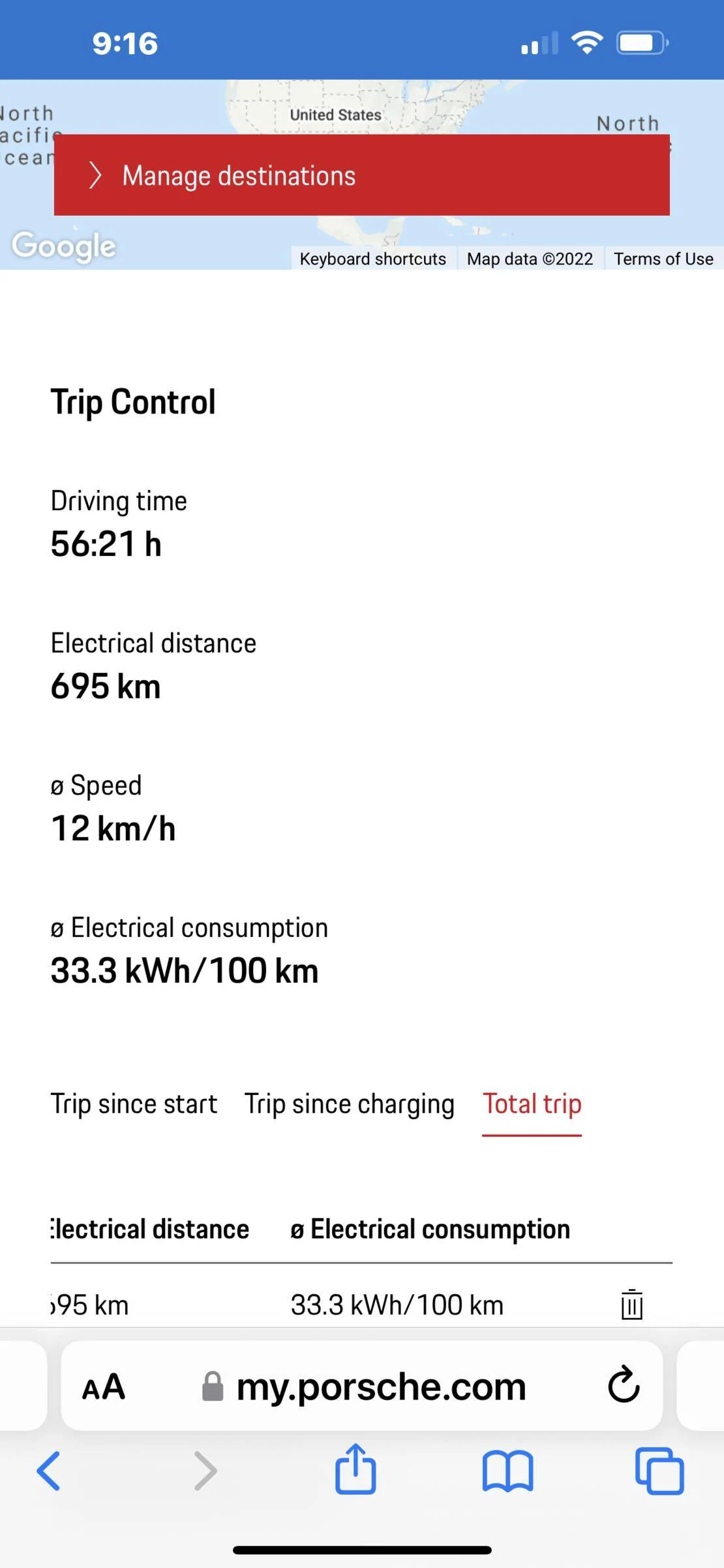

Do you mean the following:
Porsche Taycan range/battery C072814A-EB14-4E65-87DE-1BB57492D5FB

My taycan 4s 2022 model with performance battery was delivered on March 30 2022. I have not managed to get more than 180 km range from it.
from what I see, it's very simple:
you have a very(!) high consumption, very short trips and the small battery. this adds up to a short range.
Short trips and high consumption is usually meaning: much heating or cooling happening.
simply try some trips with Range mode and ECO+ and watch the results.
the screenshots you posted are exactly the same web page as @Dave777 showed but shown on a mobile device.
If you want to document your consumption history, please browse with a real computer, press f12 and download these 3 Json files
Porsche Taycan range/battery 1651906890206
and attach it :)
it's so much easier to handle the date then.

The same info of average comes up for Total Trip. See image
Porsche Taycan range/battery 3448314F-FDE0-4728-9224-06BD2B96FB2F
Thanks.
Consumption is on the high side just now as you indicated but in time it will reduce. Not many km on the car so far but note that if you only ever do city driving and short journeys then your consumption will remain high.
In winter the situation will only get worse assuming you get cold and freezing temperatures unfortunately due to how battery chemistry works and the use of AC to heat the car.
In summer / warmer temps things should improve.
In summary I don't think you have an issue and is more to do with your current driving pattern.
Any EV would perform similarly.

I believe RS38 is correct in pointing out that very short trips and the starting battery temp will contribute to hi consumption. if you look at one of your trips—
-93 km -25.8 kWh/100 km ..thats fairly normal
On my car when I first start out , if its a cold day, the consumption can be quite high (I have the “Trip” mode selected on Instrument Tube 3)..regularly it can be 40kwh/100km or more ..but it does gradually come back after a few kms and battery temp comes up.
As others have suggested, try doing a few longer trips, and also note your starting battery temp.
