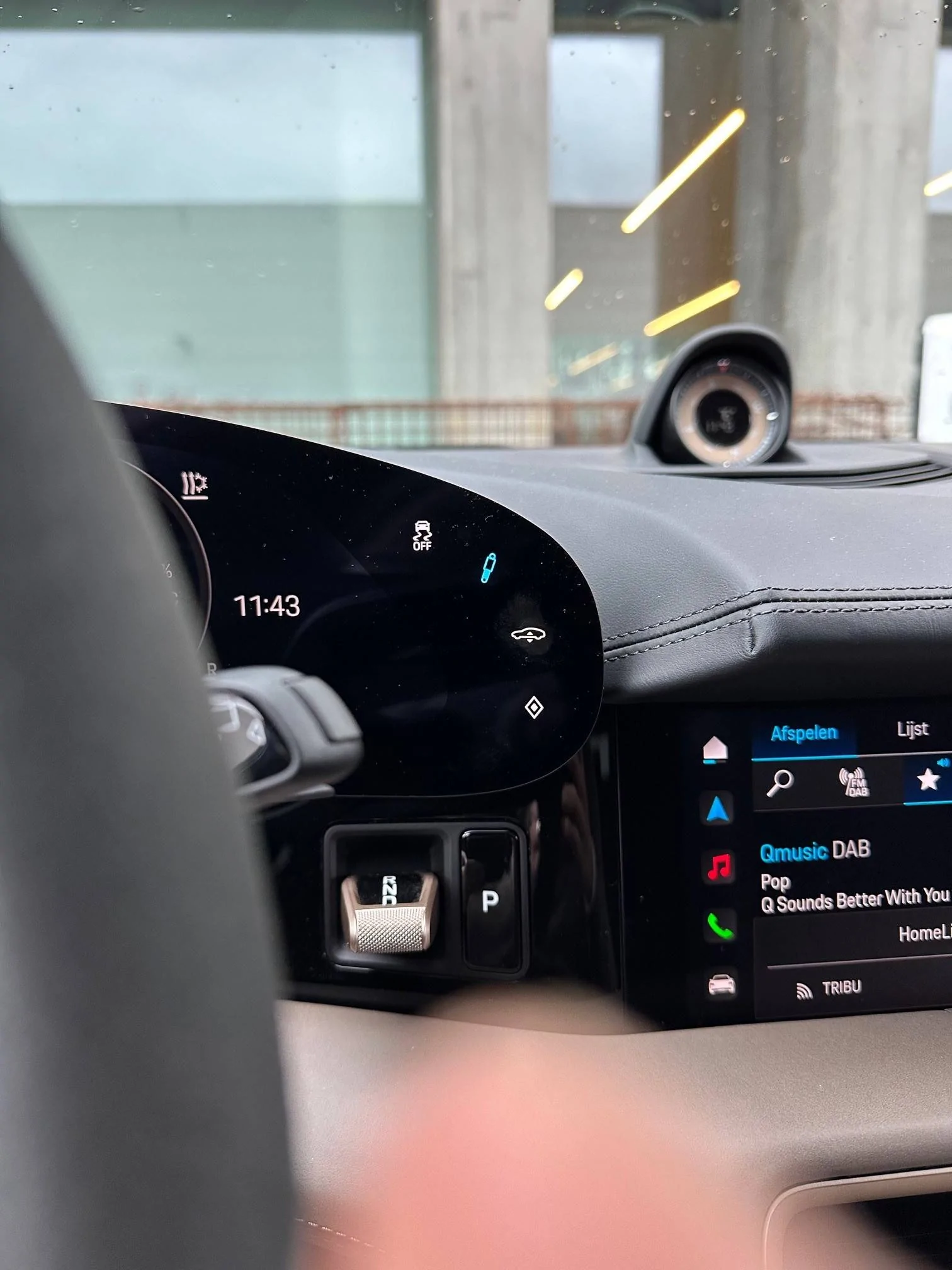

To my knowlege this button does exactly that; lower & stifen suspension to the sport plus setting while staying in your 'setting' drive
the blue one on the picture inbetween rise car and eps off

@Tdc ... so you are aware, the button that is blue in your photo does NOT change the ride height. In your photo you clearly show the 4x right side buttons; top one turns off traction control, second one changes the adaptive suspension, third one raises the height (and locations can be saved; max height, meant for going over road hazards, steep driveways, speed humps, etc), and the last one can be customized of course.
When you press the suspension button that you have highly, the electromagnetic ride system firms up the shocks (there should be off, sport, and sport plus modes, as indicated on the screen, blocked in your photo by the right stalk). However, the ride height and drive mode stay the same. This can get confusing but basically here is what you need to know:
If you change your ride height, or if you change your suspension settings, only those items change. However, if you change your drive mode, then some of those all ALSO change your suspension or ride height. For example, on a CrossTurismo, Gravel mode will change your height to High. Or in ANY Taycan, Sport mode will put your suspension into firmer/Sport. But if you press just the icon on the cluster, for suspension, your height remains wherever it current is/was prior; so if in Normal mode, then Regular height. Hope this clarifies --
