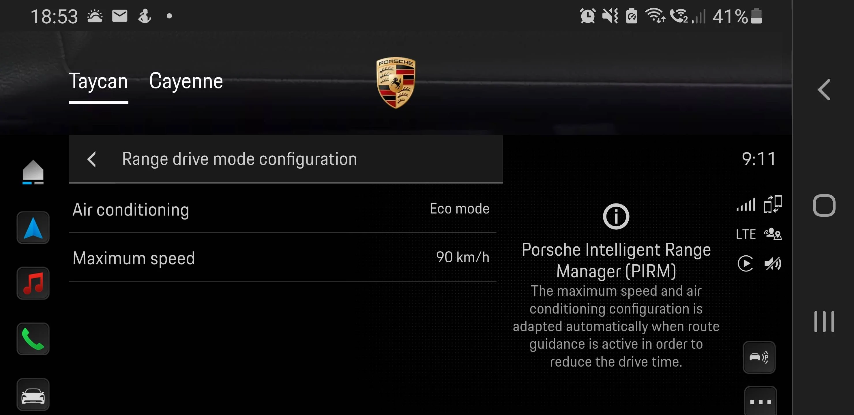

Hey guys. My base model max speed when in range mode has always been 85. I noticed yesterday that it had bumped up to 90 MPH when in range mode. Quick question: how do I re-set the max speed? (As you can see, 7 months in and I still have questions.) Thanks to all for the assist.

With the Intelligent Range Manager and with an active navigation target set, the car can override the max speed in range mode for you. It will do it when the car is confident that you can reach the destination with enough battery left
Not sure where the setting is, I found it once and set it up, and have been looking for it too a few times

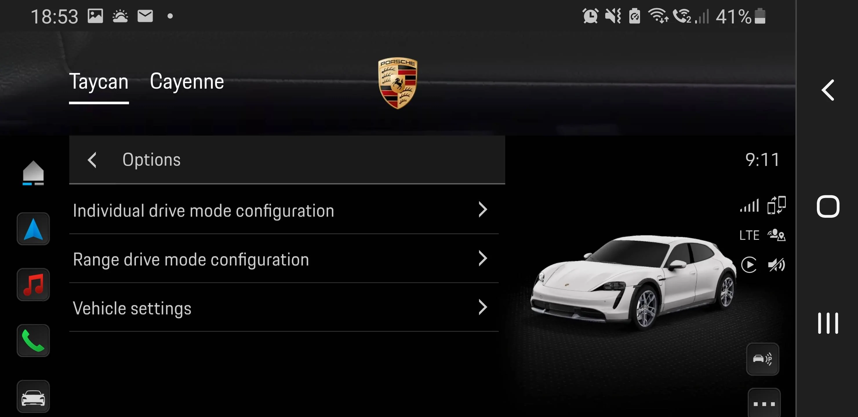

PCM Car ... Range Mode Settings and choose the max speed.

You can do it from the car too. I think it is in the driving mode settings screen if my memory serves correctly. There are the 3 dots on the bottom left of the screen, and within there you can change the range mode settings. Interestingly, mine currently shows max 90mph on the bottom right hand side of the instrument cluster screen when in range mode, but under the settings menu it shows a max of 60mph. Weirdly, a few days ago it was showing 60mph on the instrument cluster, then a few days later it shows 90mph and I haven't changed anything that I believe could affect it...

Thanks for the reply. I got back in my car today and put it in range mode again and Wala! 85 mph again! (It’s gonna take me a long time to figure this car out.) ? and thanks to everyone for all the help.

Exactly what I get!
