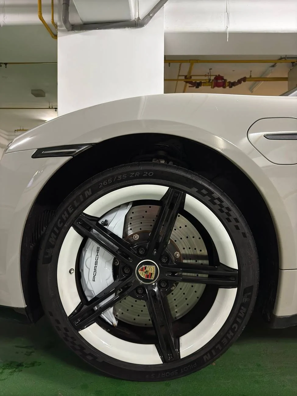

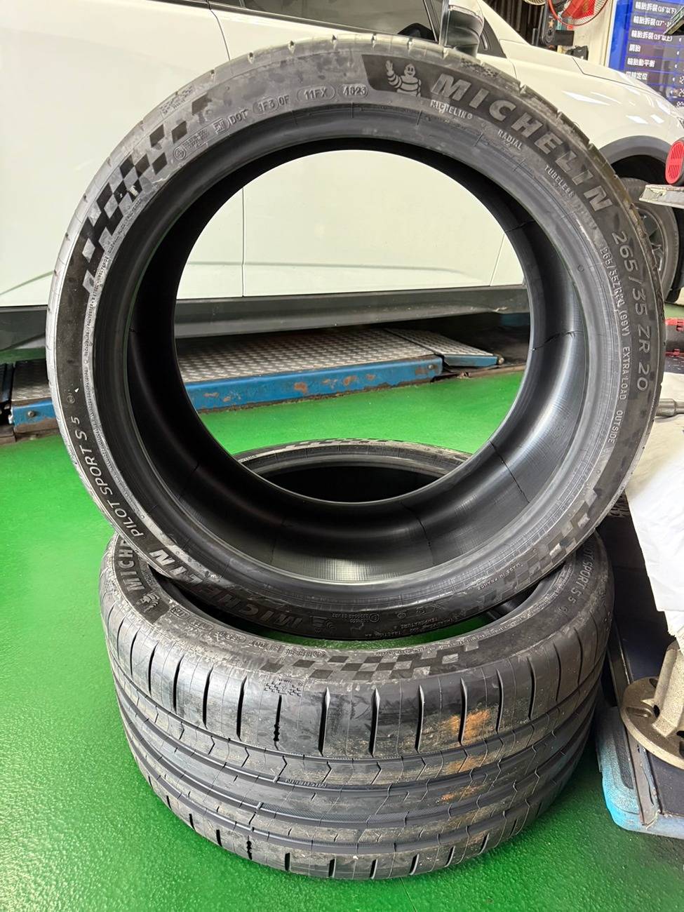

Looking forward to the performance and driving experience of the Michelin PSS5 (265/35/20)
*The original PS4S has been driven for 40,000 km and is now retired.
I thought the tires would wear out quickly, considering how heavy electric vehicles are, but they lasted much longer than expected!
The original PS4S was estimated to last another 3,000 km, but with the rainy season starting, I decided to replace them early for safety reasons.
Porsche Taycan Michelin Pilot Sprot S5 IMG_8959
Porsche Taycan Michelin Pilot Sprot S5 S__68452365

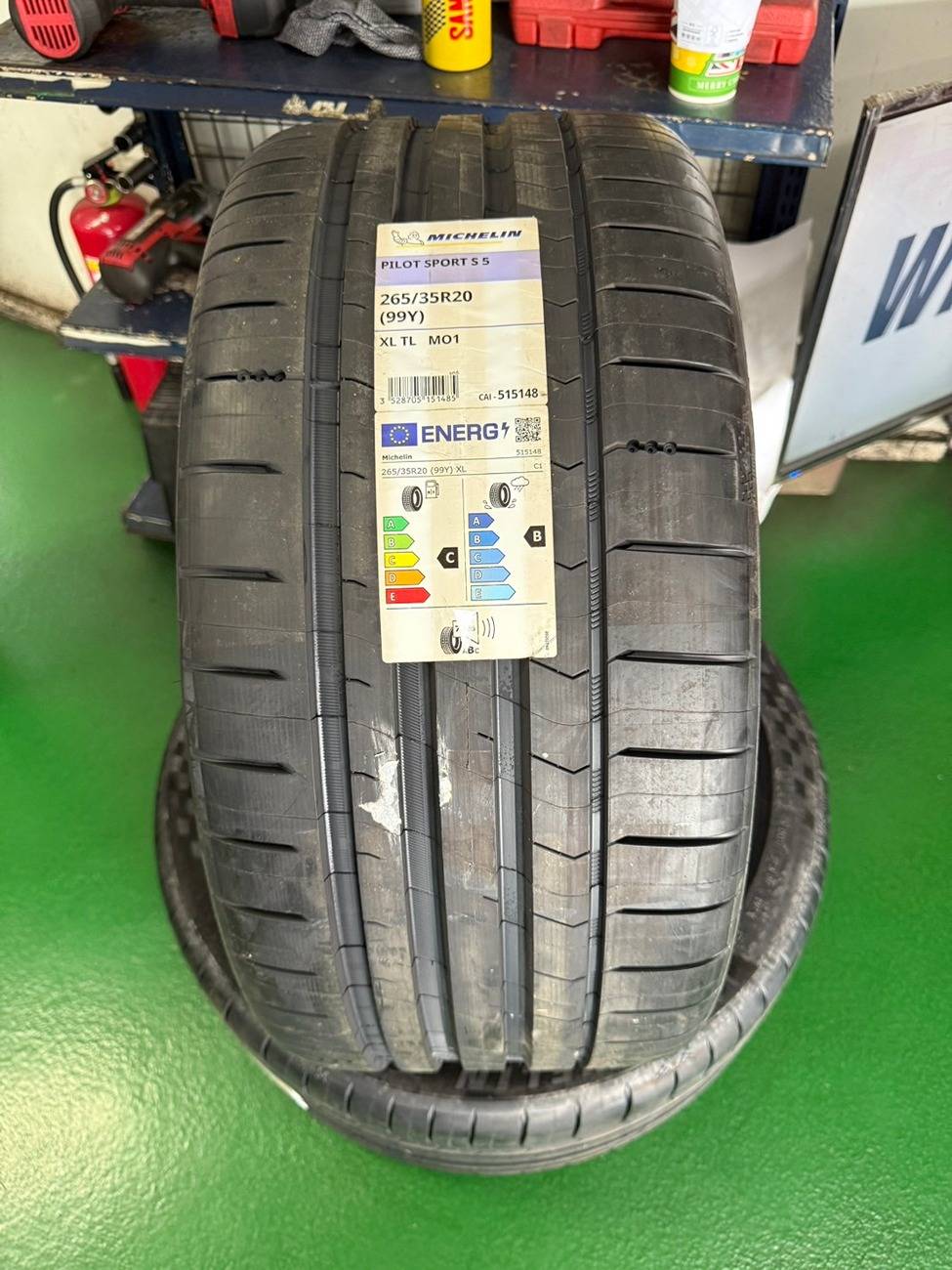

Porsche Taycan Michelin Pilot Sprot S5 S__68452367

The only problem this specific set of tyre is developed for Mercedes AMG (MO1) far not for Porsche especially not Porsche Taycan, that needs NFO labelling.

I don't think the load index is correct either. I think they should be 103, not 99. I don't know what your rear ones are but they should be 108
